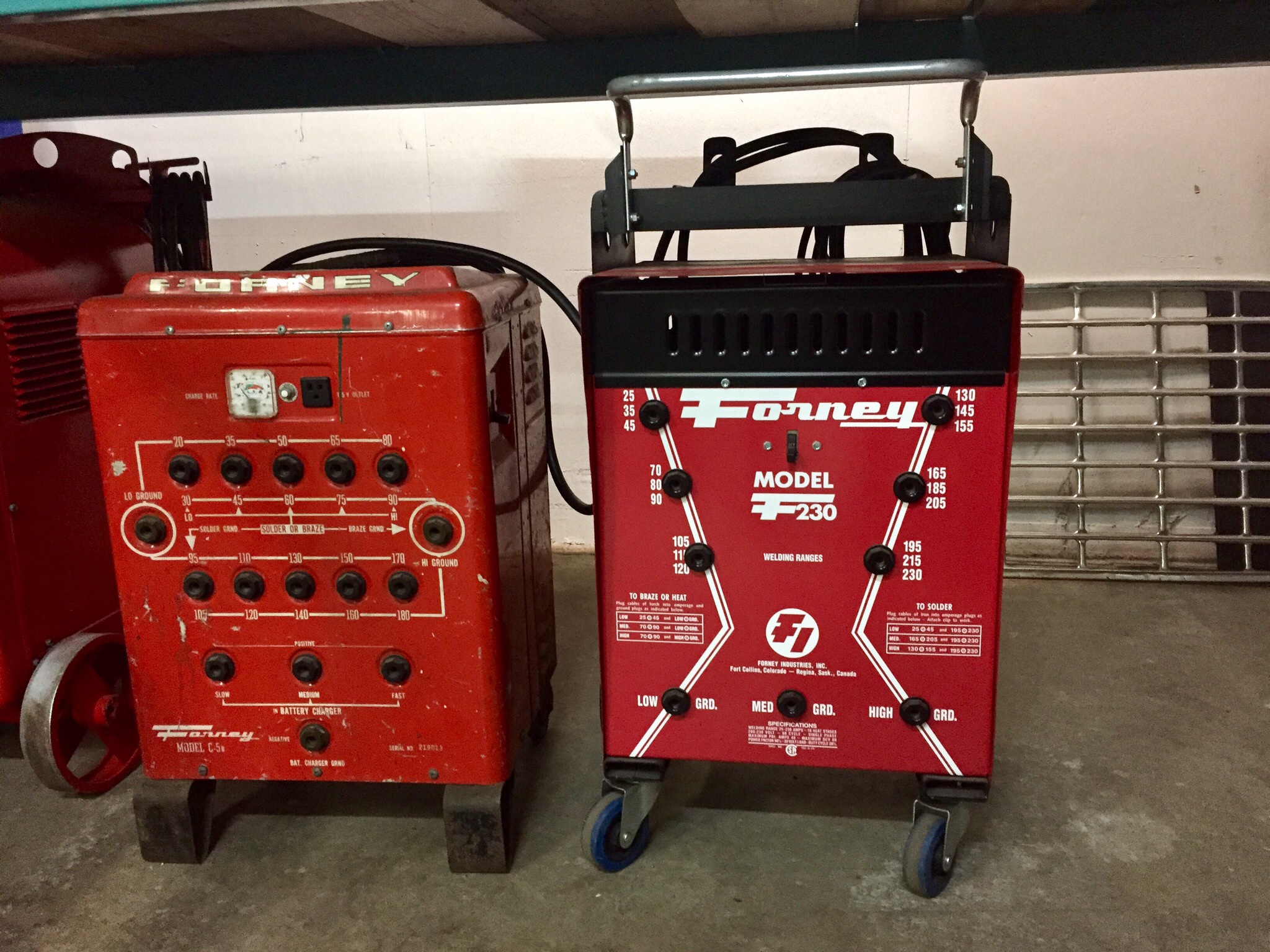

FORNEY is a an American company based in Fort Collins Colorado, although both of mine were made in Saskatchewan.
I have a couple of their stick welders from the 1960's. They came with carbon arc torches, soldering irons and battery charger attachments.
The migs they sell today may be made in Italy or??
