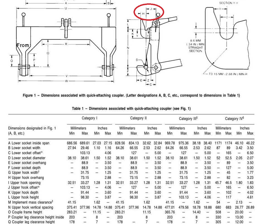

For the additional $20 this is a better buy compared to HF's version. Note how its hook is outside the uprights where the bolts are. HF is still selling QH's where the hook opening is flush with those uprights - interfering with nearly anything you want to mount.
I finally added a Speeco offset hook to make my HF QH more usable.

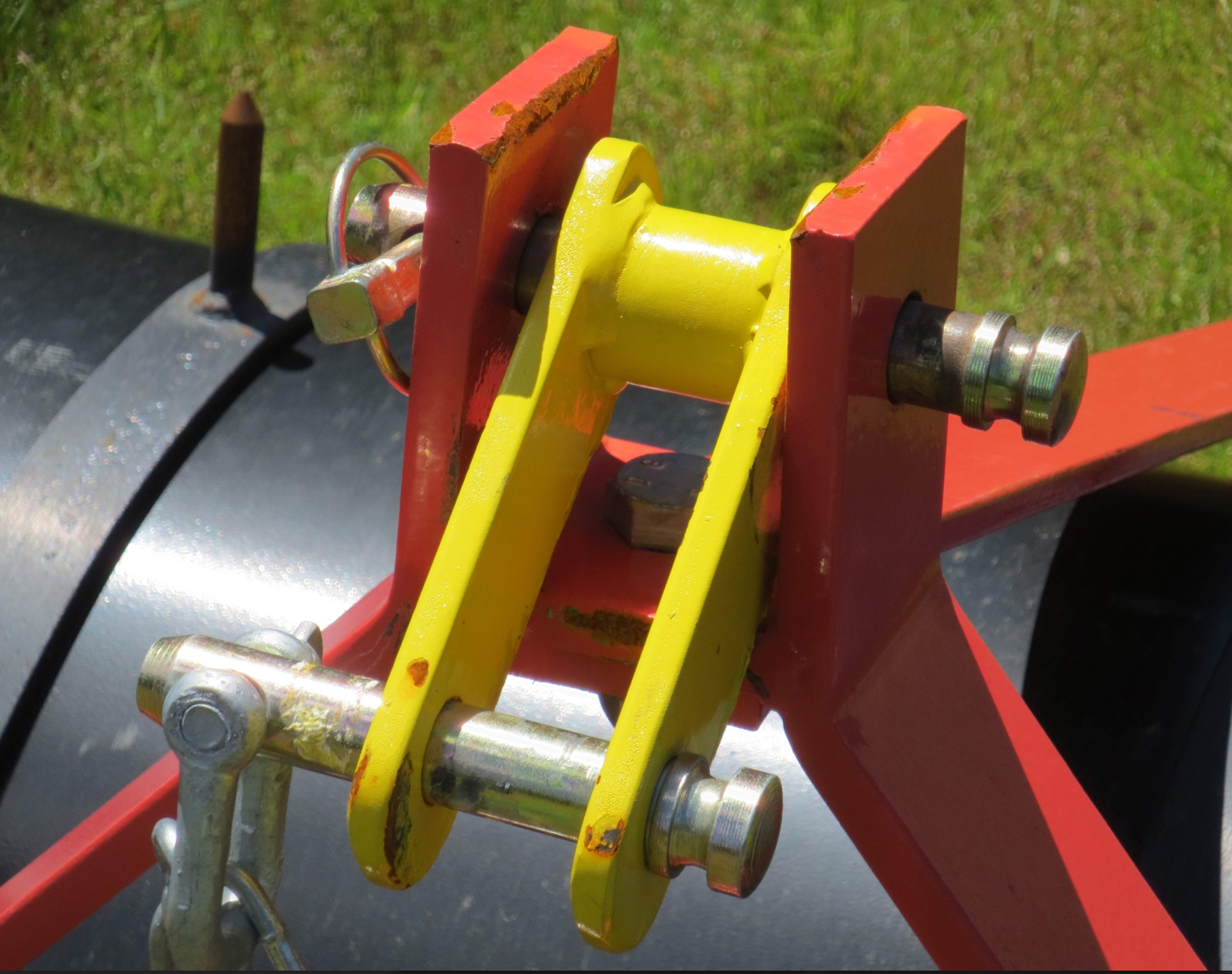

At least my HF one came with the extra piece that allowed me to not use the hook.
I don't think a single implement of mine would work with the upper hook, and I don't mind having one pin to insert and remove.

Perhaps, but there are a couple on implements where the hook just wouldn't fit, unless I machine it down quite a bit. And that still wouldn't help with the different heights.
So I use the link that came with the HF version, which solves that issue and is still quite quick to hook up being just one pin.
