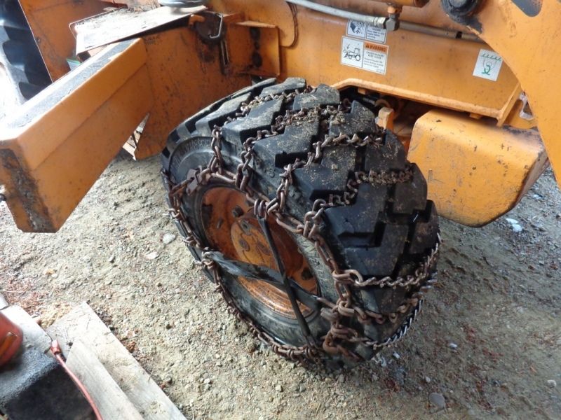

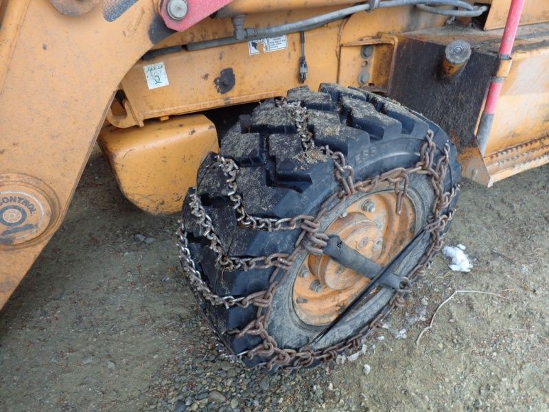

I have a set of chains I made up and used used on the front tires of my backhoes with industrial tires for years. Last year I bought a different stile if tires and found out when I had to put them on this winter it was a farce . I have the same stile I made for the back with ag. tires and they work just fine.
These are the 2 front tires and the chains didn't do a lot of good. I would have to have H pattern, diamond or rings in the center.

There was a thread I ran across where someone modified a set like you have to be more of an H pattern by adding in the middle links. That might help you out. It also appears you still have a lot of slack in the cross links that allow them to drop into the tread blocks. Can you increase the tension to keep the cross links in place. Just curious.
