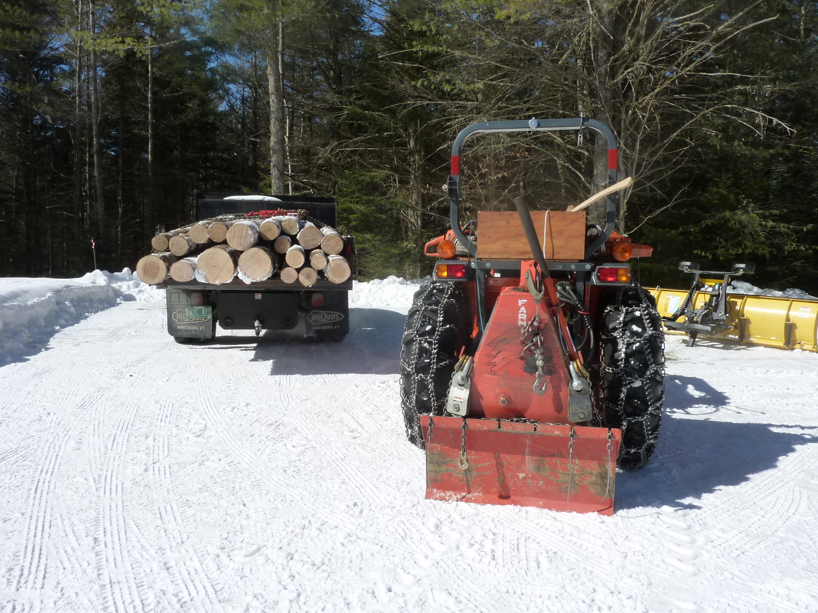

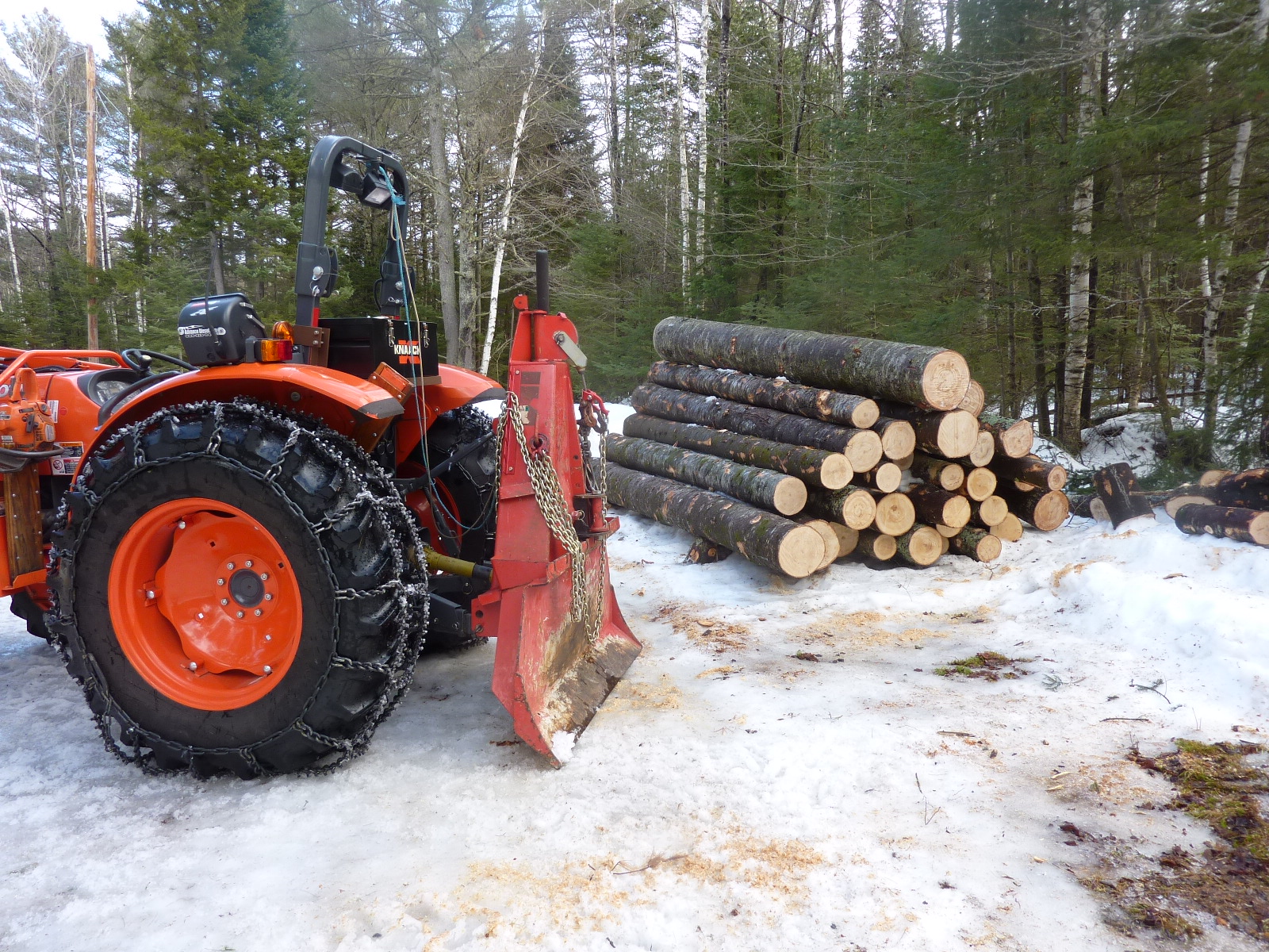

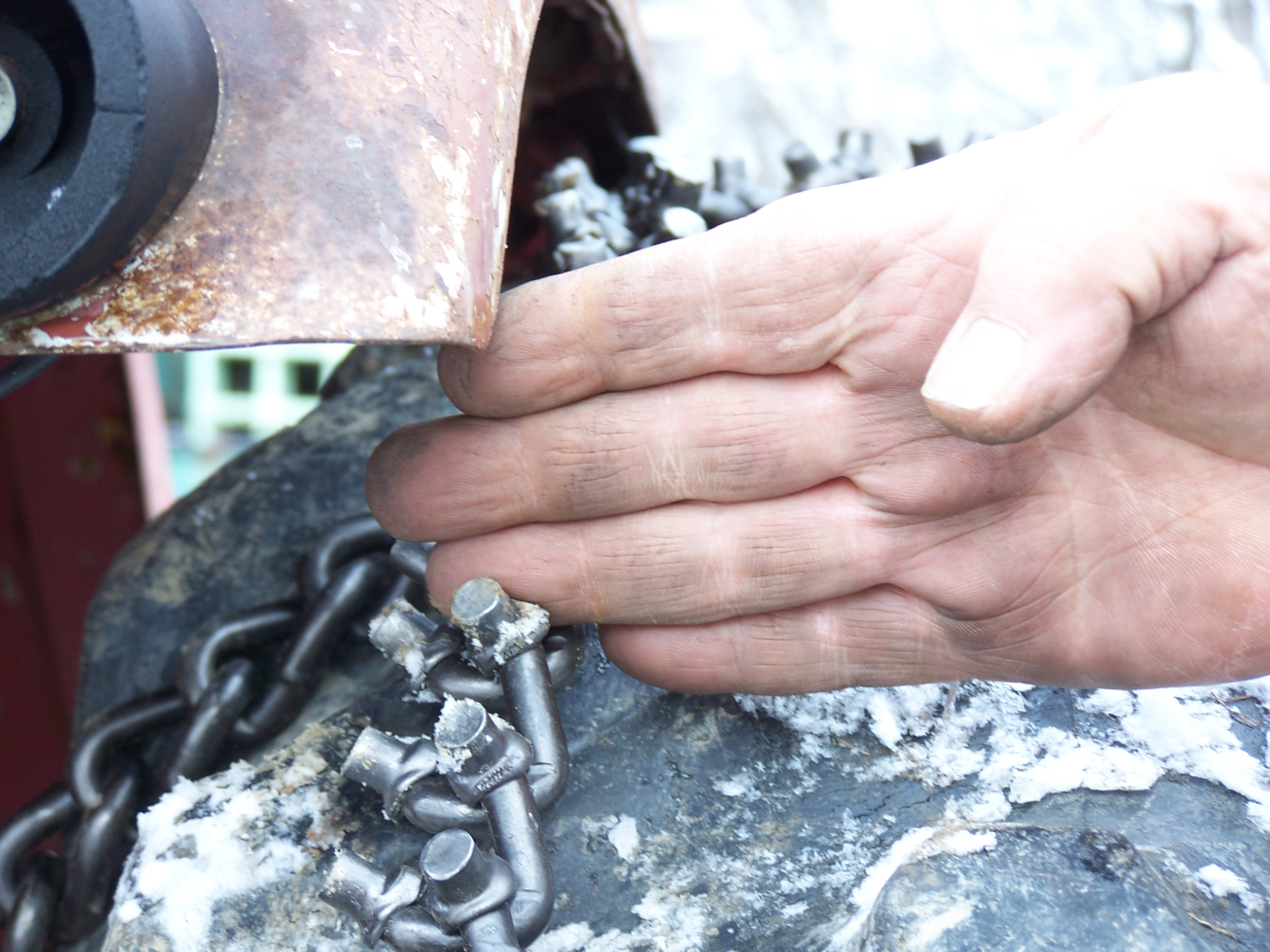

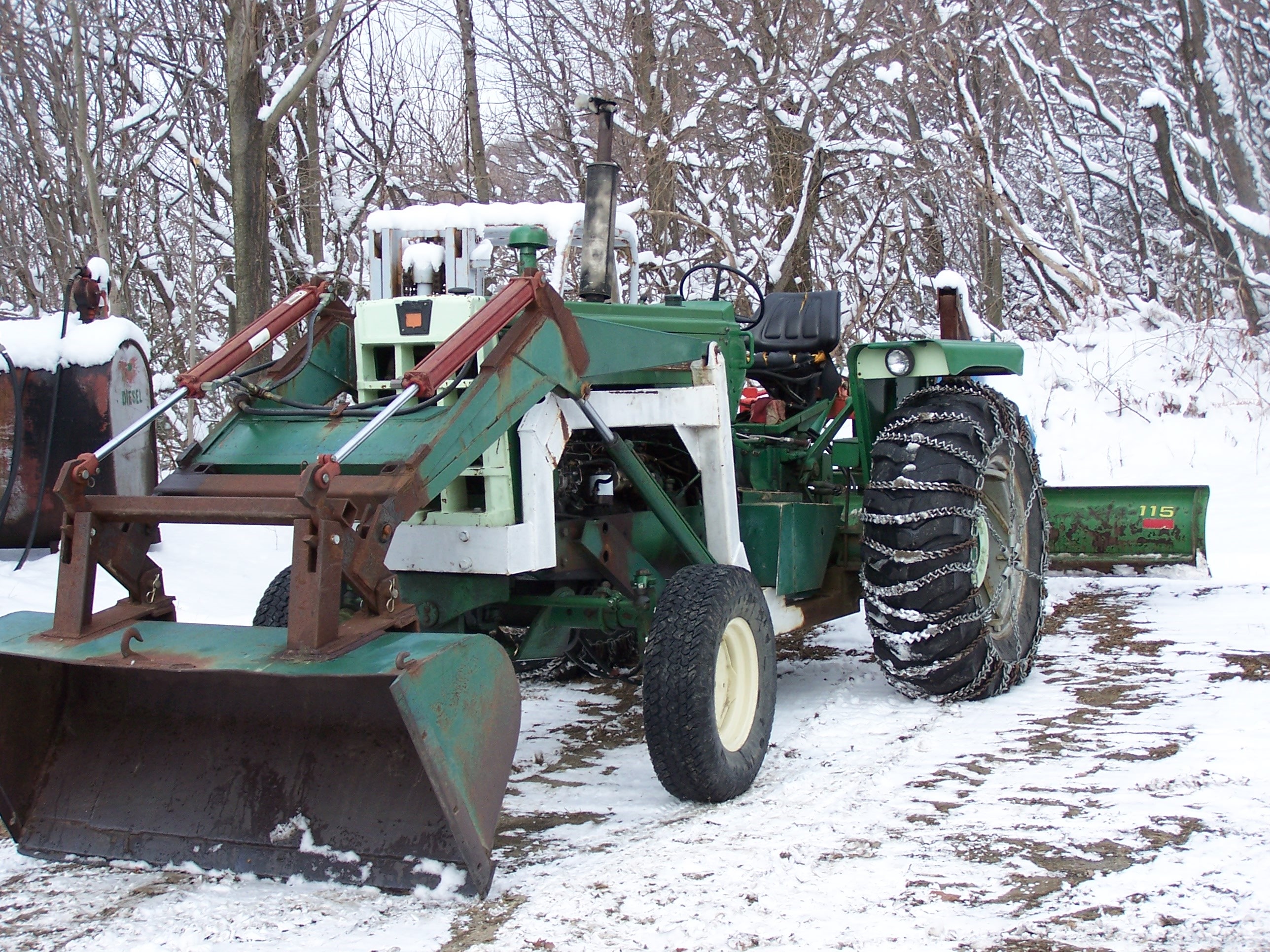

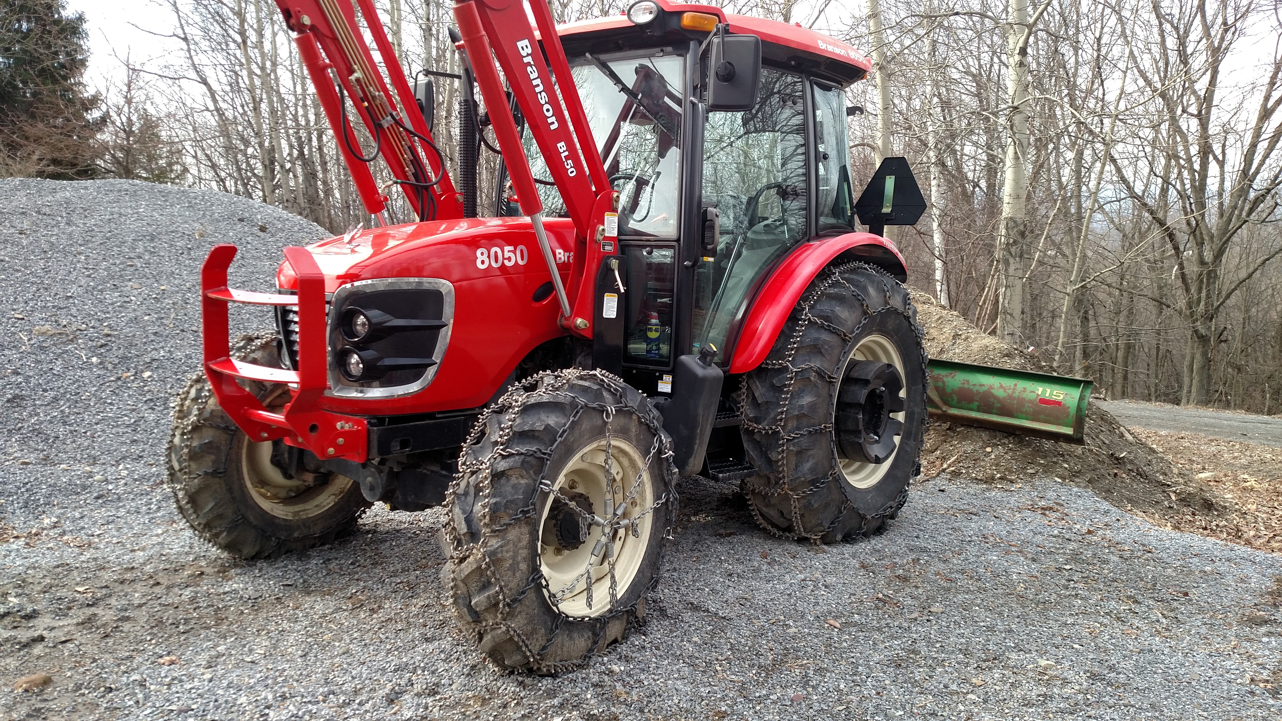

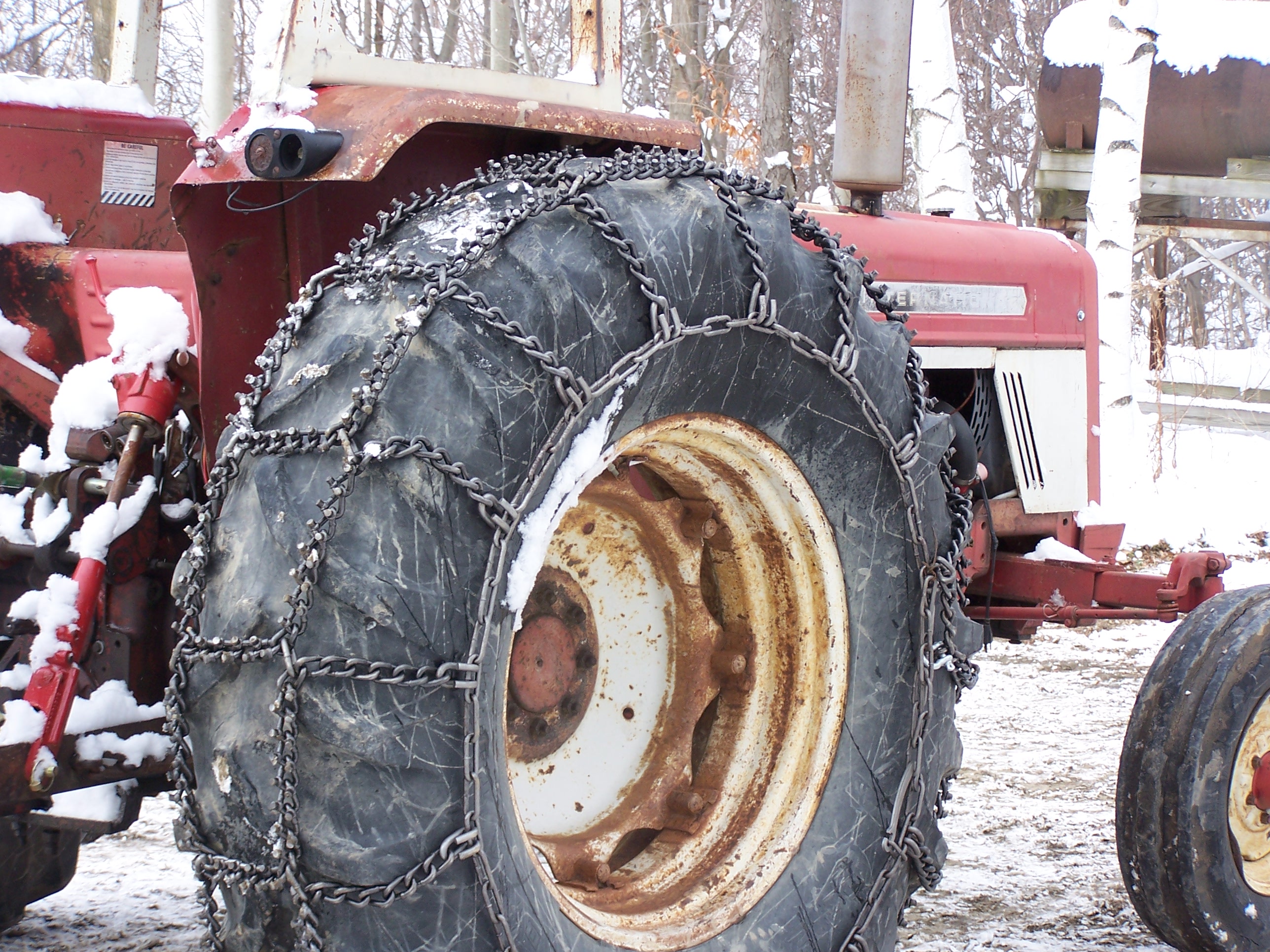

There are numerous threads here on chains;
my :2cents: there is only one style I would consider after using just about every style made in the last 60 years.
These are conventional twist link and bar reinforced twist link on 2 link spacing, they work, kind of a rough ride on frozen or hard surfaces,
These are the best style I have found and used, excellent traction, smooth ride on pavement, the best;
These type chains are also easier on front axles as the traction is continuous not grab, slip, grab, slid they are also more money the ladder or the duo-grip type which to me have the roughest ride unless you are in mud or deep snow.

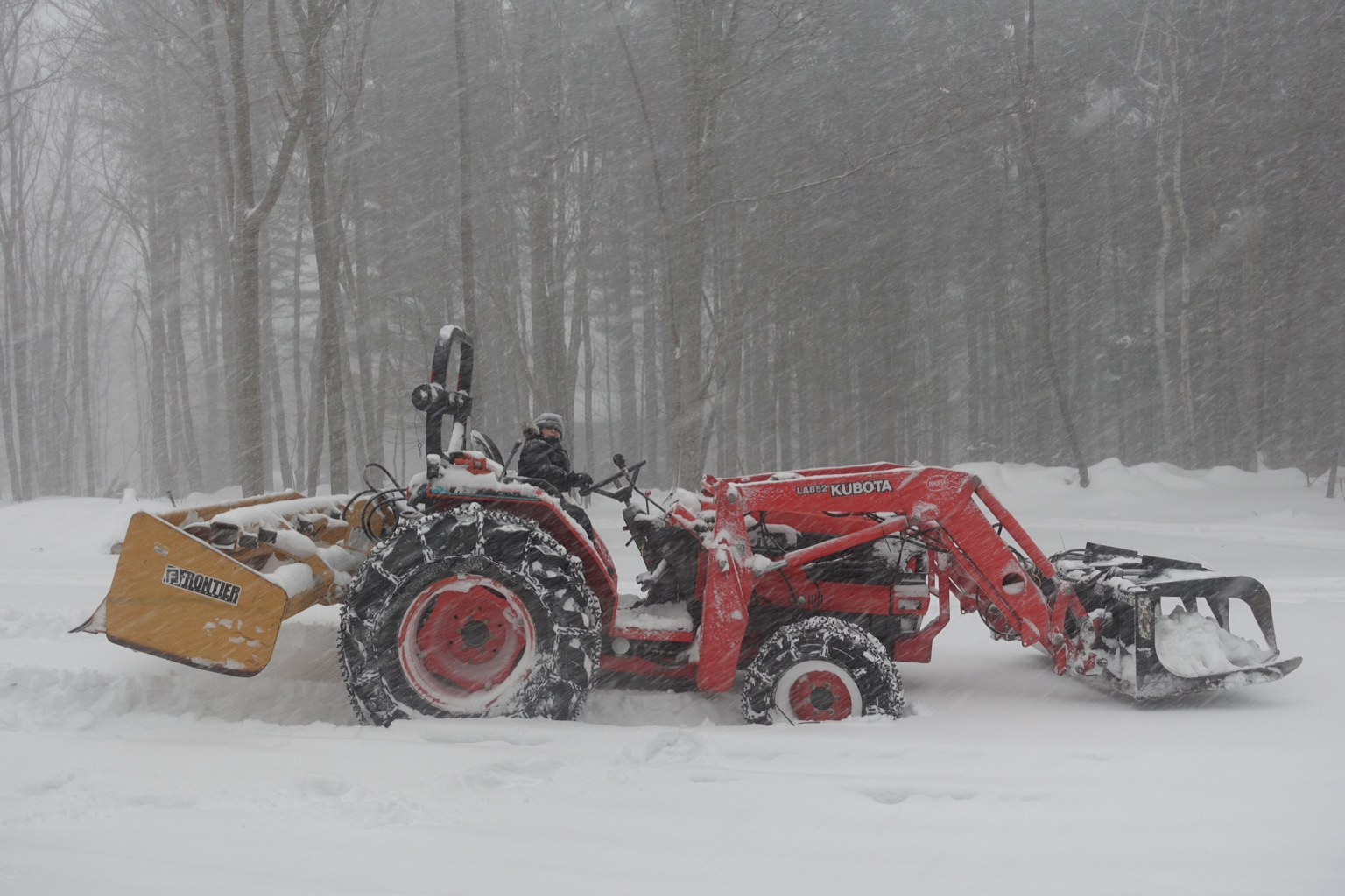

I also agree with Lou that chains with an "H" pattern are best. They are a lot more money though. Up hear in the NE there is no question that they are worth it if you work in the ice and snow 6 months a year. The last ones I bought were OFA brand EKO9 style chains made in Finland and put them on my M5640. I have 8 mm chains on my L3010. On hard packed snow and ice they are priceless. You should check what others in your area need for winter traction if these seem to pricey for your needs. Some with R4's use screw in studs with good results.

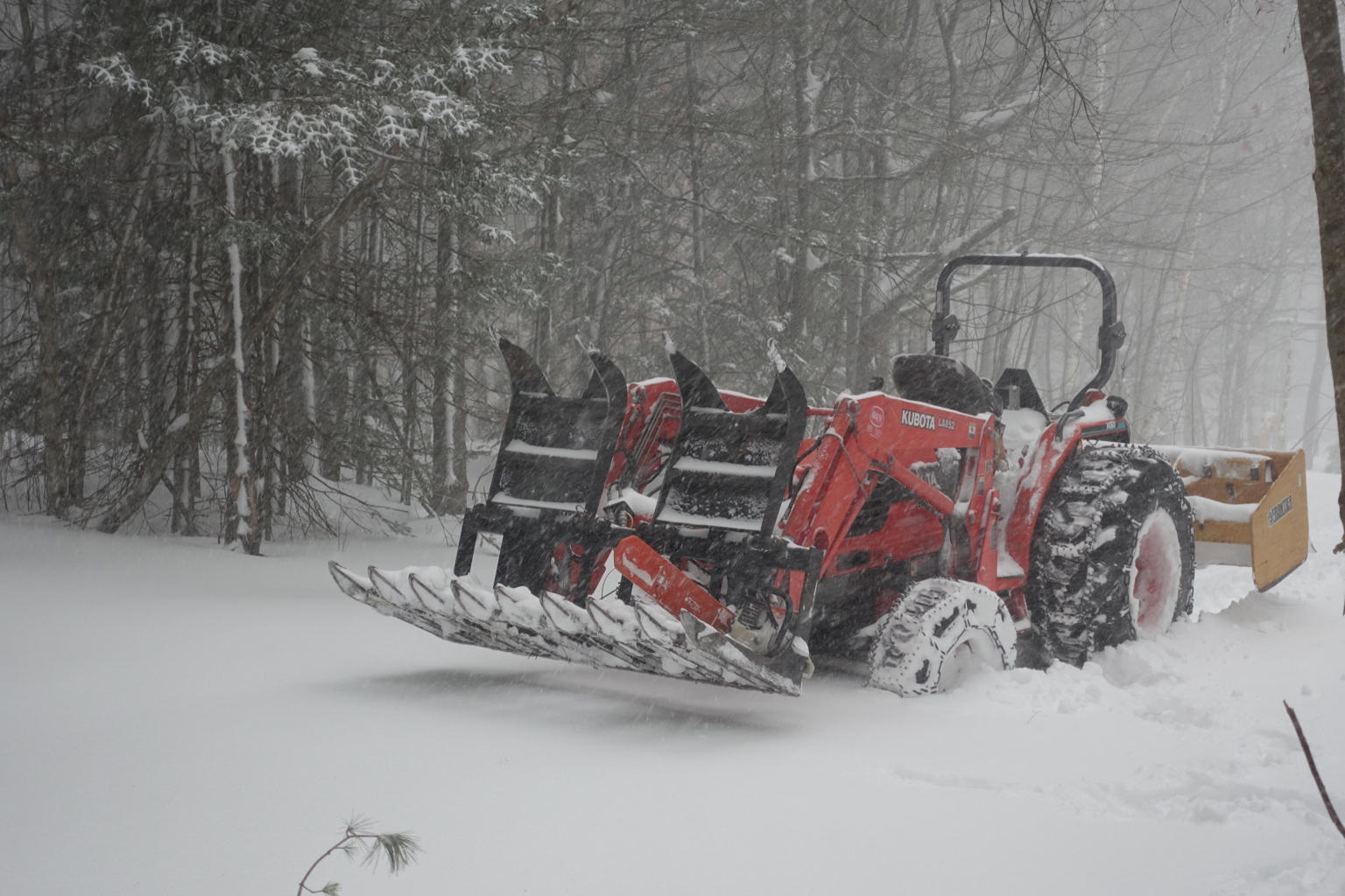

My l3400 is worthless with r-4 in snow. I have 2 link v bars on the fronts and do pretty well. I should get tire spacers to run chains on the rear too. The r-1 on the 5083 are just as helpless unless in deep snow. I have duo chains that are ok bUT the aqualine talon chains I have on the rears are flat out awesome. I MIGHT be able to climb a tree with them.
   / Tractor tire snow chains #7

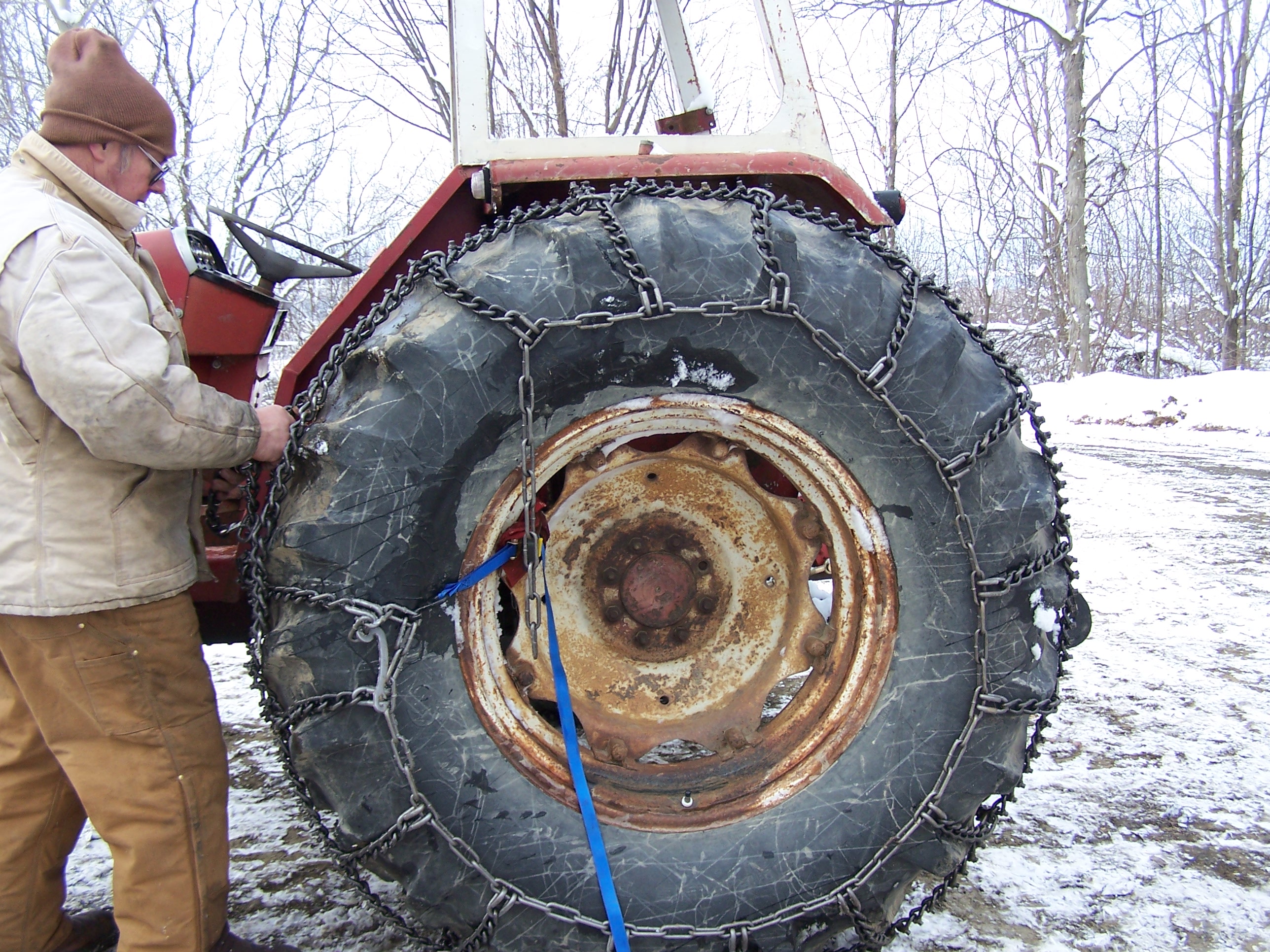

I started with 4-link Ladder style chains with V-bars. They did the job getting me up and down the icy hill in my driveway. for lateral traction (operating on sidehills) they were better than bare tires, but not good enough for my work in the woods where more lateral traction was needed.
I next tried Duo Grip chains with V-bars. They improved lateral traction significantly over the ladder style chains, and still let me get up my icy driveway. My only problem with these was the rough ride on hard surfaces (pavement, hard packed dirt roads, some frozen ground); running at higher speeds on hard surfaces was unbearable. Since I regularly run several miles over the road between two properties, I did not stay with these for long. If you are operating mostly off
I eventually settled on Ofa Eko 8 chains (larger tractors would use the Ofa Eko 9). Top quality materials and construction, excellent forward and lateral traction, and a smooth run on hard surface. I guess I knew when I decided to get rid of the Ladder chains that something like this was what I really needed. I just mistakenly thought I could get by with something cheaper.
