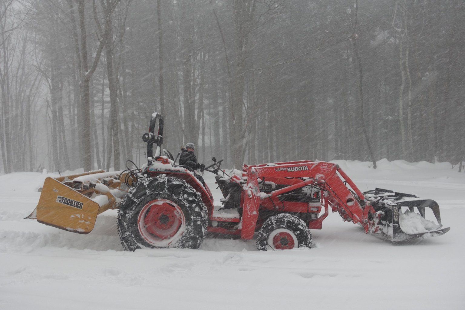

I have an MX5100 and use rear chains in the winter. The H pattern is good. It goes just about anywhere with these chains including the mud. I have R-1 ag tires. Can easily use the individual wheel brakes for steering in the snow. The only problem is that they are so heavy that I cannot lift them. I set them on the tread and drive them on. Once a year is enough. I put them on around Thanksgiving and remove them the end of March. Not afraid of using them to start plowing the fields.

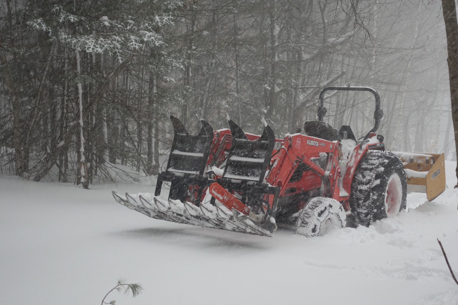

I use the euro style studded ice chains from tirechains.com
I have a long steep driveway that in during early/late winter in VT turns into solid glare ice. I've never had a problem going up or down

I second (third, fourth?) the OFA studded chains. I had a set of 4 link ladder chains that were somewhat of an improvement but not very much. Easy to spin them on pavement and they didn't do much for me off pavement. I then loaded the tires and that made a good bit of difference.
Last year I bought the OFA EKO9 from Windy Ridge in NH. Those made all the difference in the world, it's incredible how much better they work. I was able to go through the woods with snow considerably deeper than my ground clearance, and with those chains on all 4 tires I was virtually unstoppable.
I had originally ordered a set of the Aqualine Talon chains from tirechainsrequired.com, however cancelled my order when I read they were made in China. (I did not fact check this). I’m very happy with the OFA chains.
