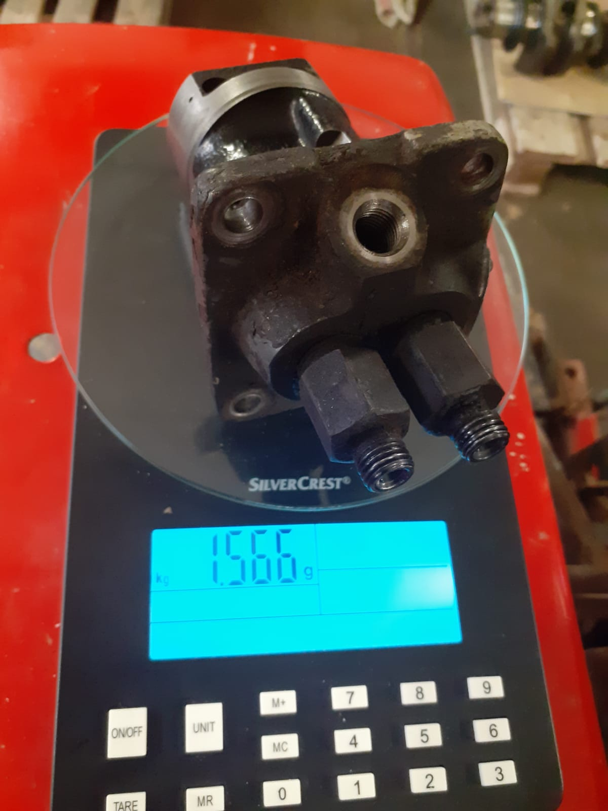

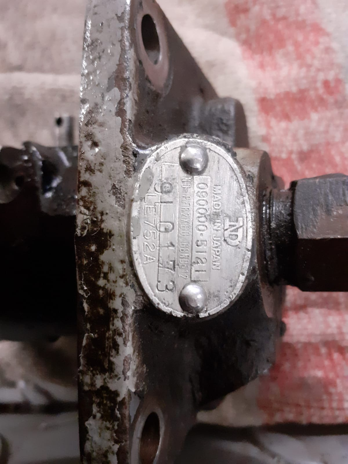

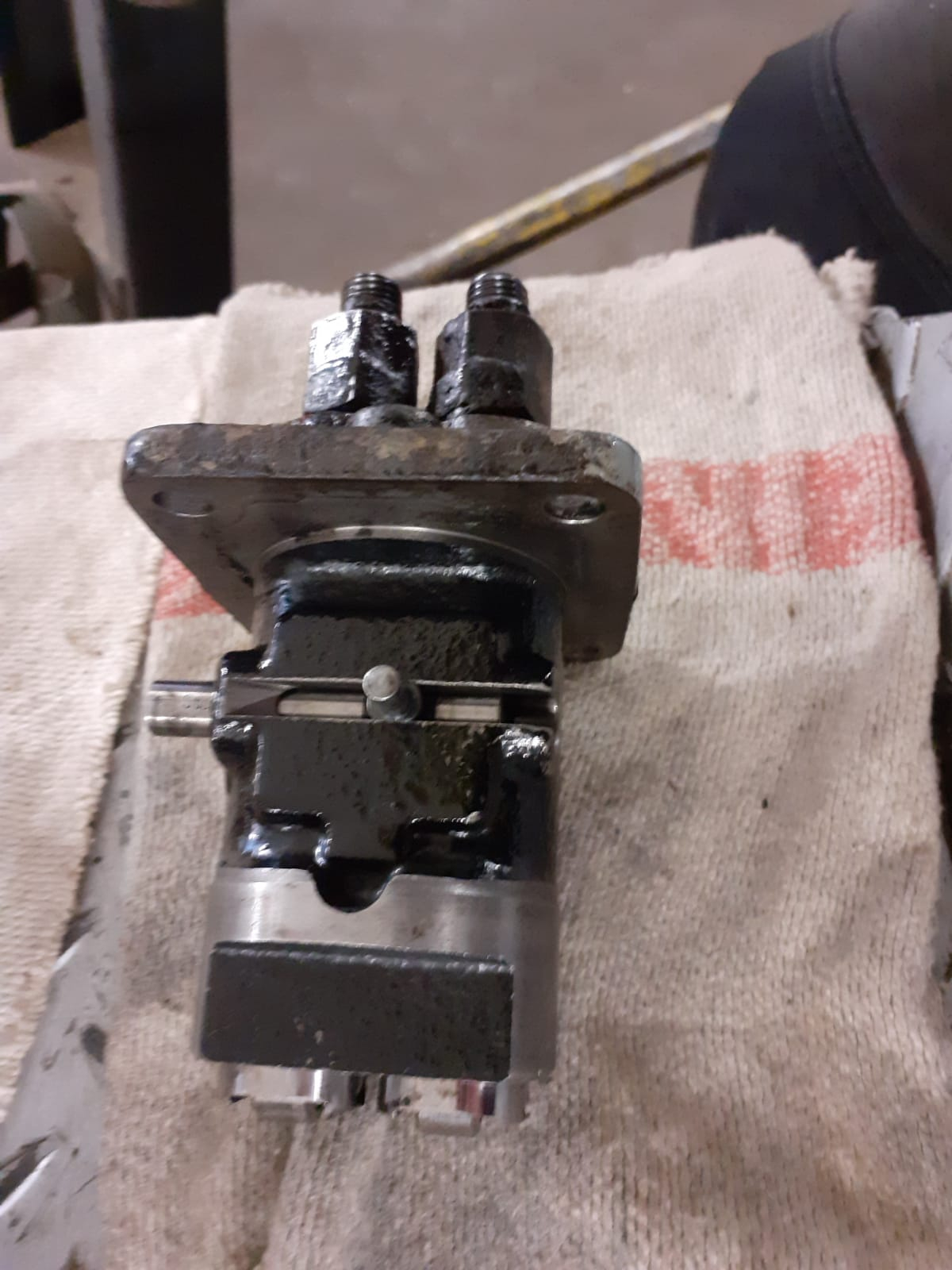

Hi all, I would like to kindly ask if you might know where to get one broker part to my tractor - type Shibaura Model S-070 Compact Tractor, LE752A. I need injection pump because is KO.
I guess these tractors were sold under the brand in Europe/US as New Holland as well but don´t know the particular type. Any help please

The Ford 1100s have that same engine. You can get an exploded parts diagram from the Messicks website with Ford part numbers you can search for but it doesn't appear that any of them are available through Messicks. You may be able to find one but I would be really surprised if you are able to locate a new old stock one as I'm fairly certain that they are no longer being produced for a 2 cylinder tractor that was last built in the early 80s by a now defunct company. You may be able to find a used unit from a junkyard as there are junk yards that specialize in older gray market Japanese tractors, but you are taking a chance that that unit is in better shape than the one you've got.
I suggest that you send the unit you have off to an injection pump rebuilder. Many of the internal parts are common to multiple units including the more common three cylinders and oftentimes a rebuilder will be able to repair your pump.

MTGreen thank you very much, I am trying to find it on Messicks but I am not able :/ could you help me please? :) I would love to find the spare part number .... THANK YOU

Not sure what the problem is but why not find a local Diesel pump service/repair shop which should be able rebuild your current pump?
If that's not an option, a new pump SBA131016911 for US $ 581.52 may or may not solve the problem?
