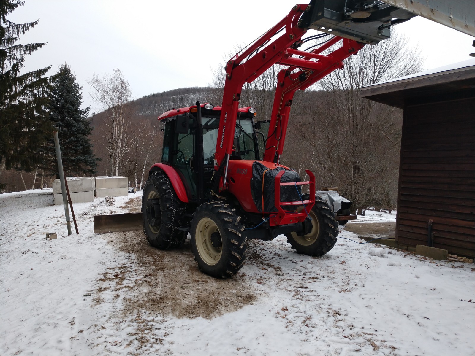

   / Tractor warm up #17
Mine has to sit outside so it gets the block heater so it will start easily,
once its started I'll give it a minute or two then place the range transmission in neutral and the main in 2nd or third and place the shuttle in forward or reverse, i'll hear and see the rpm drop a couple of hundred and then I'll get out and do a bit of shoveling or just put the power cord away while it runs for 4-5 minutes that way when I get back in I'l raise and lower the loader gently a few times, raise and lower the 3 point and then start working her gently
till she has a bit of heat built up.
I also have most or all of the radiator screen covered up when it gets cold.
If you look closely you can see it's covered in this picture, I worked her about 3 hours or so today and the
engine temp never got over mid scale the same as it runs normal in the summer.
The hydraulics are nice and responsive with no whine or chattering.
