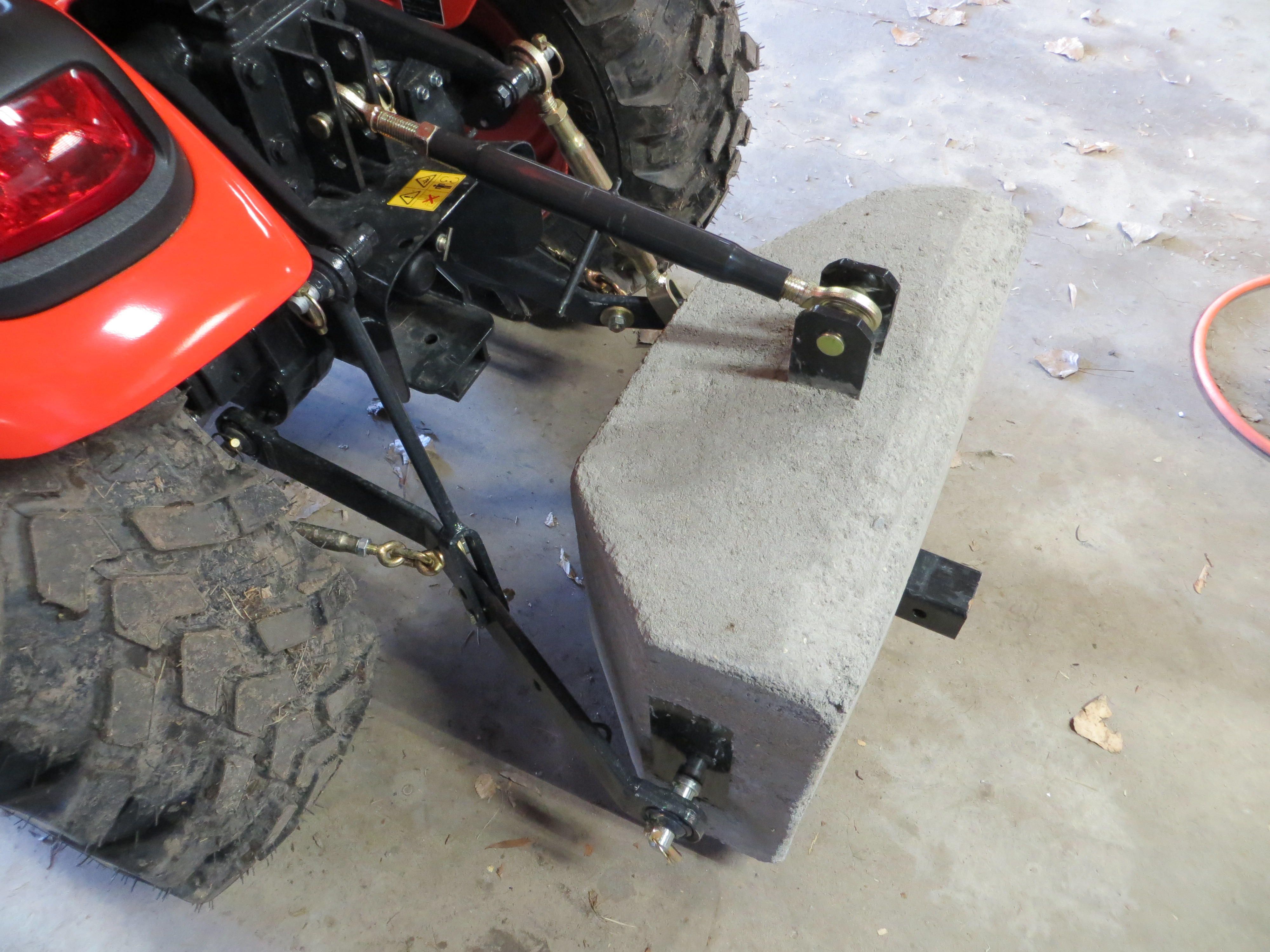

I have a Kioti CX2510 with loaded rear tires. It came with a FEL as well. I built a compact 400lb rear ballast. My land is overgrown farm land, about a foot of black dirt then mostly clay. This time of year the water table is close to the surface so the ground is soft but held together with the overgrown grasses and trees. My question is, will i do better with more weight, keeping my FEL on and rear ballast or will i do better if i take these things off and lighten the tractor? Not worried about leaving ruts but just worried about getting stuck. I have the new R-14 tires. What is best? I'm new at this tractor stuff.

Here is my ballast. $148 for the steel and $50 for some concrete and fiberboard. My 3 point lifts 1200lb so i can still use this to move a trailer with under 800lb tongue weight. Nice and compact.

Lighter tractor will stay on top. It's about PSI.
Dual tires help floatation, but not usually an option on compacts.
With narrow tires and low ground clearance, you are going to get stuck.
I'd shed the counter weight and leave loader on, at least FEL can help you push out if you do get stuck.
When in doubt, wait until it is dryer, easier to wait than spend time and money getting unstuck.

Cant overstate this enough. PSI is king. If you have the rears loaded and rear ballast on a small tire that might create a bunch of concentrated pressure on the ground. Dont venture too far out until you see how the ground responds.

With wet condition described and a 25-horsepower tractor, not quite sure why you ordered loaded rear tires, weight on all the time.
~~You may have good reasons for loaded tires which you have not posted.~~
If you do not foresee needing to lift max loads with the FEL, drop your 400 pounds of TPH counterbalance.
(( 400 pounds on TPH should be ample counterbalance for max FEL lifts with air inflated rear tires. ))
I would retain the FEL. It is very useful for pushing/leveraging the tractor out of a partially bogged situation.
Mud and wet are when R1/ag tires are superior to other tires.

With your conditions and a 25-horsepower tractor, not quite sure why you ordered loaded rear tires, weight on all the time. The main reason to load rear tires is to improve tractor traction; yet with 25-horsepower it is unlikely you will have enough power to break rear wheel traction except under unusual conditions.
"Wait a couple weeks and you will not have to spend the remainder of the summer repairing ruts."
Good advice from OOSIK.
Tractor can weigh 100k #'s and still be pushing down on the ground, here's an example running 14PSI.
Now, in your situation you're saying you don't care about damage you only care about getting stuck. Just remember that damage will probably drain even worse than what you have and create more mud or worse future obstacles for your small tractor. I wouldn't overlook the damage side of this equation.
But if you want to drive on it and not get stuck, decreasing the PSI is probably the way to go either through making the tractor lighter or getting larger tires.

Why did i ask for loaded rear tires, because in my first post, when shopping i was told on a small tractor weight is king and buying the heaviest tractor is the number 1 consideration. Why did i build the ballast, because even with the loaded tires [about 300lb add] when driving on snow, with the FEL the back felt light. I also loaded the tires for some snow work in the winter. I am in Michigan.
