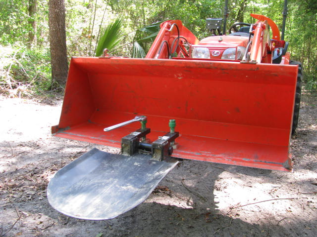

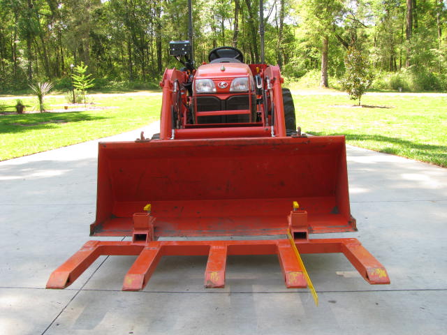

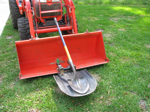

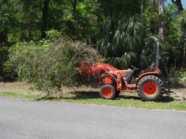

FEL ("bucket" ) something I wanted immediately. The B3300SU is a Kubota Tractor/Loader package; I use the bucket all the time; usually for lifting/transporting logs and loading dirt into a trailer. That said, it is difficult to PUSH dirt smoothly with a bucket. I own a rake and a rotary disc harrow which I use to level and with these tools I can leave a smooth finish, whether is is woodland trail maintenance or preparing a yard for grass. I used all three of these tractor tools today.
There are a multitude of bucket accessories for the work you envision. I have a Bucket Solution's Bucket Spade and a set of aluminum Debris Forks from Payne's Forks. Both are very satisfactory on my B3300SU; however I am I would not recommend them for a small/lighter Tractor-Loader.
Before you have your tractor long you are going to want to buy one or more implements, most of which are carried in the three-point hitch. (3-Pt.) Whenever I need to pick up something sufficiently heavy with the FEL to possibly make the rear wheels light I attach an implement to the 3-Pt. as ballast. For me that heavy load typically is a tree trunk chained to the bucket and the 3-Pt. rear ballast is a Wallenstein BX42 PTO-powered chipper, which weighs 425 pounds. Personally, I am not a fan of ballasted tires, front, rear or combination. Once the tires are ballasted you are always carrying the weight/compacting soil. With an implement you carry ballast only when required.
