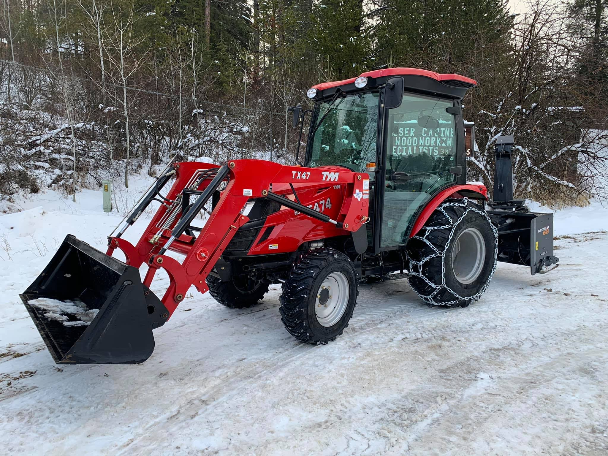

I am looking for a tractor probably in the 35 to 40 HP range with 4wd and a cab. Will be used for snowblowing and a 6 foot rear finish mower. A bucket is not needed since I have 2 tractors with buckets. What is everybody using and what are the opinions for hp required. Looking for used and speed will not be a necessity. How about a snowplow for the front and a rear blower ? The front blowers seem to be pricey. Thanks Ed

If you specifically do not want or need a fel, a front mount blower would seem to be the best option. They are expensive, tractor specific, and will limit your options in the used tractor market though. I personally like rear mount blowers, and don't mind looking over my shoulder.
I run a 72" blower on 32hp (PTO) without issue, and ran the same blower on 27hp with the previous tractor. As far as finish mowers, I run a heavy duty 7' finish mower and it was fine on both tractors.

My 35 runs my front mount 66" blower easily - no stress - I have a 72" rear finish again no issues at all - more than enough power - I do have a loader, mounting the blower is not difficult, one man job, take the loader off - set the snowblower frame on the ground - drive over it I use a small scissor jack to assist with the frame, once the frame is on it is all hydraulic from there, hook up the hoses and lift / lock the blower in place - on the Kioti CK's you need to install the mid mount pto, the blower and set up is pricy but the set up is well made and functions very well.....

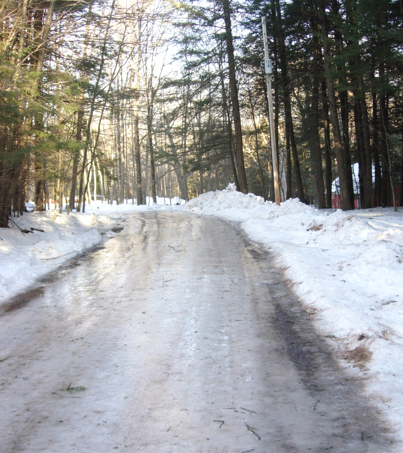

prior to the blade and blower, I dealt with a four foot storm with the bucket on my little TC26DA. I went thru 2 five gallon cans of diesel, plus most of a full tank, until I was afraid of running out. Then had to walk down the hill thru 4 feet of snow with two empty cans, to get my cousin to take me to town for fuel. Then, leaving a can at the bottom of the hill, walked back up with the other full can and dug my way down to the one at the bottom. Because the snow was so high, I often had to back up like 100 yards with each bucket to dump it off the bank on one part of the road. It was like using a teaspoon.
Things tend to get a bit icy in the spring.

Hard to beat a bucket up front and an inverted blower. I run both a 72" front blower and a 84" inverted. The inverted will out perform in every storm. Both machines are 56HP at the PTO but the 72 is a hydro.
