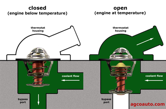

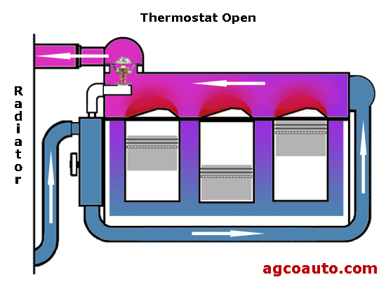

I'm sorry this is taking so long to resolve, so I appreciate you all sticking with me on this til I can get it resolved. I only get to work on mechanics on weekends or a day off. So, the thermostat (160) has been installed now. I can see water flow inside the top of the radiator (with the cap left off). It appears to (as I stand facing the front of the tractor) to be flowing from my left (where the top hose enters radiator) diagonally to the right. Is that the correct flow pattern? ----------------------------
You won't see that flow if the coolant is below 160 degrees, but yes that is the correct flow.
