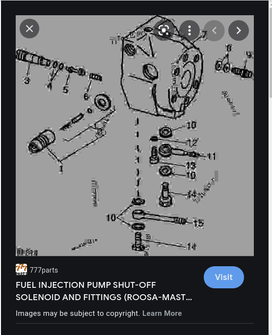

Stop soli has two control circuits normally, start and hold. Either can have a bad fuse or relay, this sounds more like maybe weak soli or dirty linkage. Couldn't figure out you exact machine from the pic, and didn't see it in the threads I read. The below as produced when I googled john deere 4020 stop soli. Try it with you tractor and should get something similar. Generally not too bad to get to, and not too hard to test.

Stop solenoid on the L3430 is in front of the injection pump.
