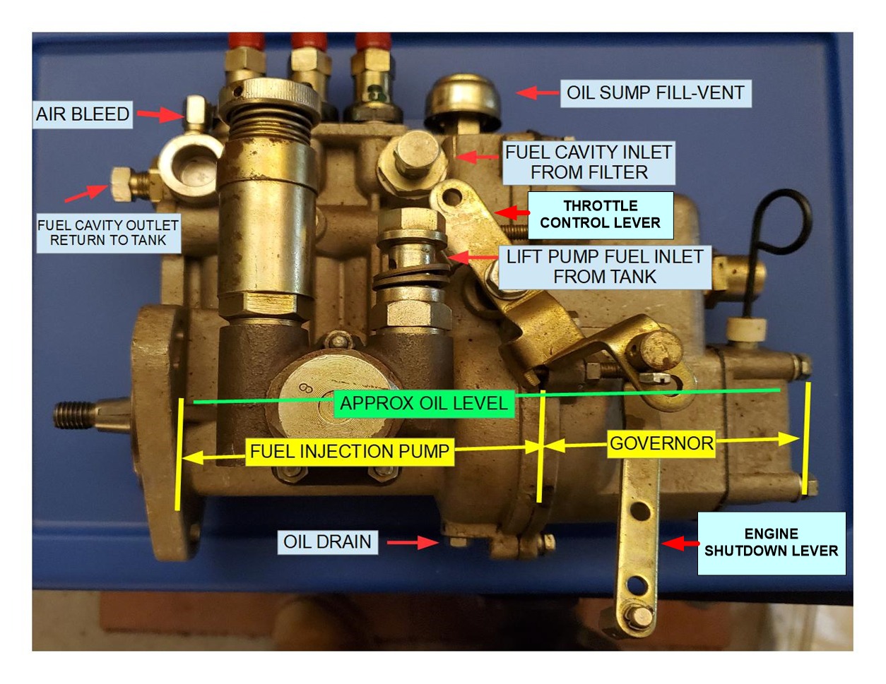

I'm ignorant (yes, female) about engines. I took off both sides. I can see what looks like the air intake. Call me stupid, but won't that overheat the engine? I saw what could be the solenoid but no a wire that could be removed.

All engines need air to run, find where they get it from and just cut off the air, may take a few seconds but it will stop.
Another good trick is to over power (bog down) the engine so much it can't run. Do this at idle speed (low as possible throttle setting), put it in highest gear possible (or press the 'go' pedal all the way down fast) while holding the brakes is a good suggestion. If the brakes won't hold try driving it up (gently) to an immovable object like a tree. With any kind of luck you will have enough traction to not spin a wheel and the engine will falter and die.

I took apart the front panel and can't see anything obvious. It is a key start. 20 year old Kubota 4310. I don't know where the air intake is. I don't want to overheat it. None of the front panel gauges are working. I thought of syphoning the gas. If it runs out of gas it will pull all the crap from the bottom of the tank. That will mess things up. I'm sooooo PO'd.

Call the Dealer. The air filter should be easy to find and block. Google it. Good Luck.
If you see a loose rod near a device with several small pipes coming out of it, try to reattach it or pull it by some other means.

I am not sure it is a good idea to shut off the fuel supply to a running diesel engine. At a minimum you are probably going to have to bleed the injector lines to get the engine running again.
I like the brake pedal down, high gear, idle and pop the clutch idea best I think.
My small tractor has the old reliable pull knob linked to the kill lever on the injector pump.
