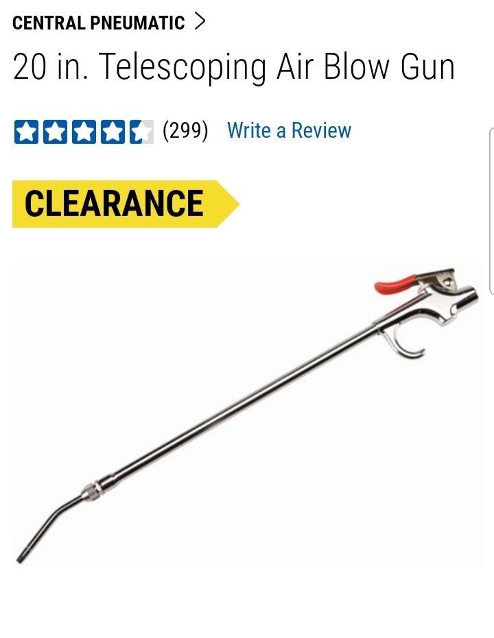

   / Tractor #7
Get one of these and really blow the radiator fins out. Flush and change coolant if it hasn't been changed in years. It could be the water pump not working properly. Check thermostat.
