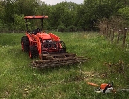

Well, it finally arrived!
After three hours learning at the dealer yesterday, I spent a couple here at home driving, backing, hitching and unhitching implements, reading the manual, and fielding "oohs and aahhs" from my son-in-law and grandkids.
I even began one of my projects, removing a welded wire fence and posts, and used the forks to carry it all away. Yes, I was careful, very careful. Low and slow! Even backed down the little hill behind, keeping the load uphill.
Thank you all for your advice, counsel, and resources. I shall revisit this thread often, making sure I utilize every bit of wisdom.

That is a very nice machine,although it is the wrong color for me (massey man here) haha.In all seriousness kubota makes a nice unit,I have owned 1 orange machine in my life and it was a great tractor.Take care of it and that tractor will do anything you need within reason obviously. When it's time for resale or trade in just like with anything a well kept machine will retain some value . congrats on your new tractor!
