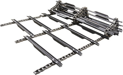

We planted our food plots this past weekend. About 16 acres worth.
This is our planting process
1. Spray with Roundup in late July
2. Spray with roundup in late August and maybe add some 2,4-D to the tank
3. Plow food plots in early October. (LSU says don't plant before Sept. 20 because of potential armyworms)
4. Seed with a mix of 100 lbs of wildlife mix and 300 lbs of 17-17-17 fertilizer mixed in a spreader cart
5. Cover with a feeder house chain.
6. Pray for rain.
The feeder house chain works really good to lightly cover the seed. But this won't work in all soils. It works well in our sandy loam soil.
We get a used feeder house chain at a local combine dealer. Sometimes you can pick them up for free. We cut it to about 6' length and then put 2 lengths side by side to make it about 10-12' wide.
