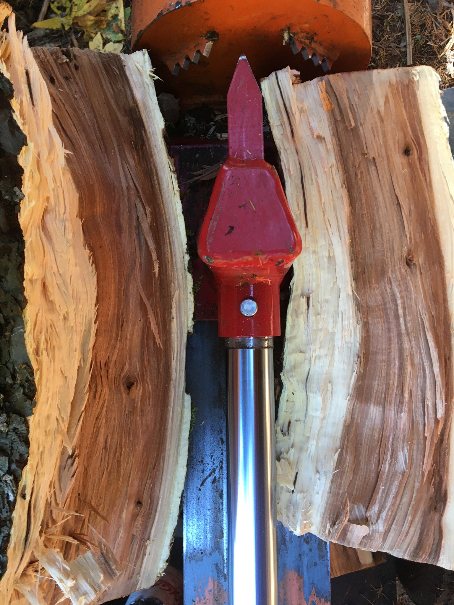

My buddy came over today to help with firewood, sure takes a lot of the work out of firewood, cutting over a wagon or trailer,
Anyway, best part is, he brought his two boys with him, so it was pretty easy to put a board in place and roll these big boys onto my splitters beam,
We ran some BIG oak through the 4-way,
and we over filled three of my half cord boxes with splits,
Not too bad for a few hours of work, and we didn't work steady either...
We have half of the downed oak cut/split/in boxes now, so next we need to go skid out the other half!
SR
