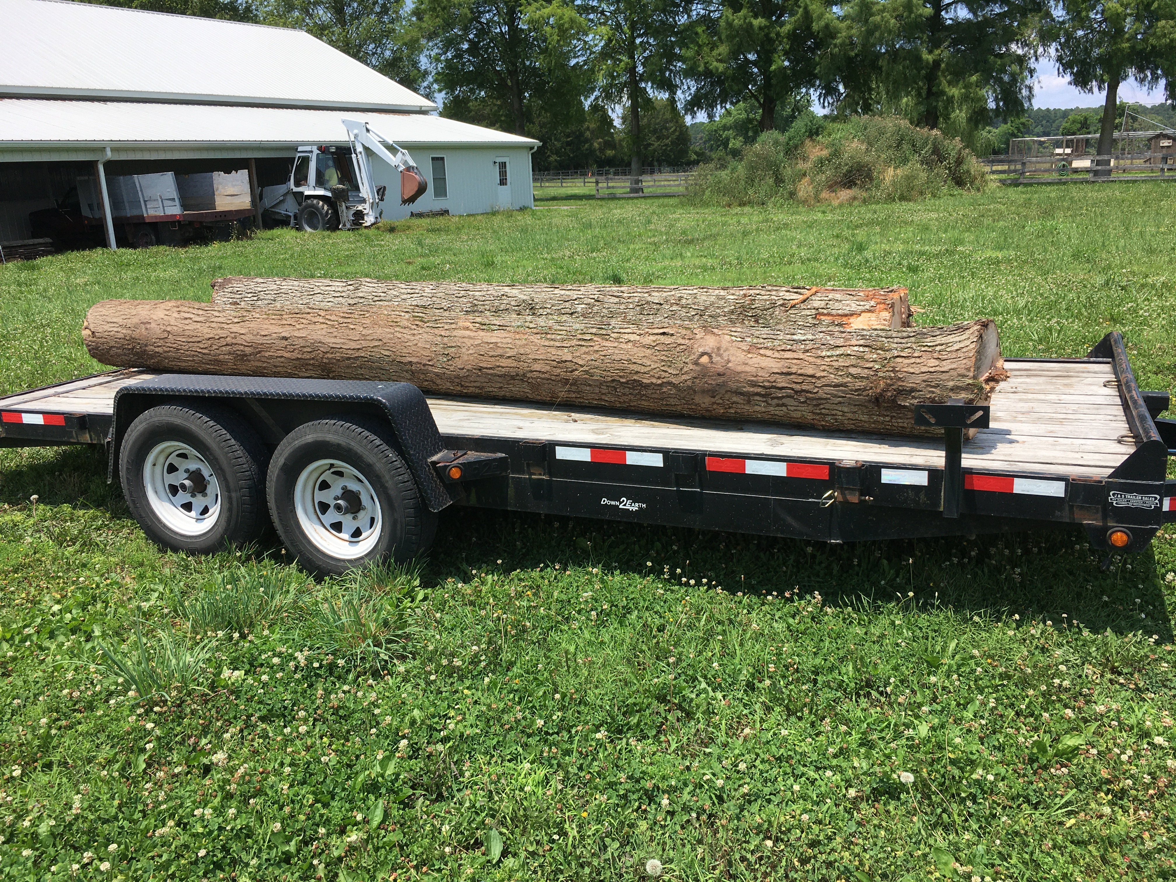

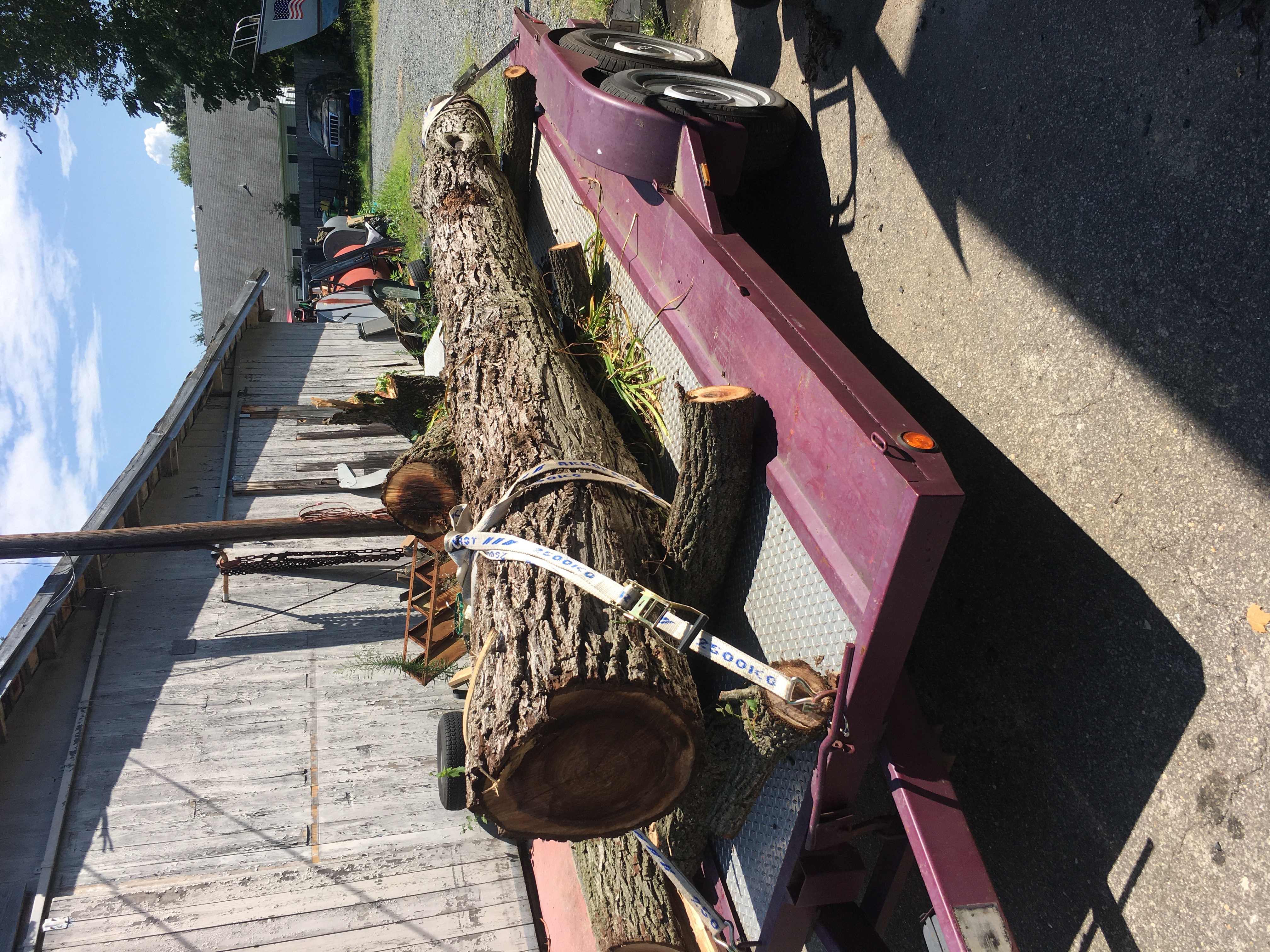

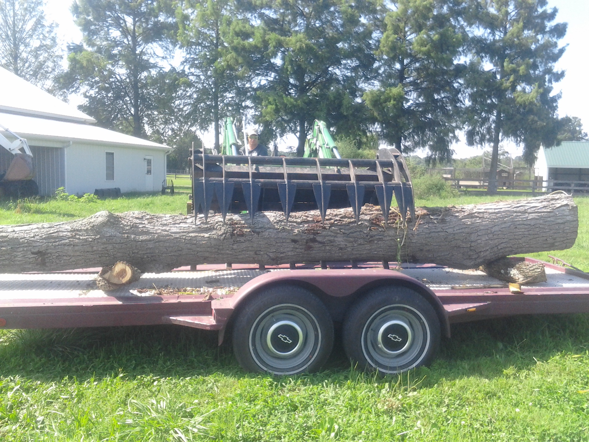

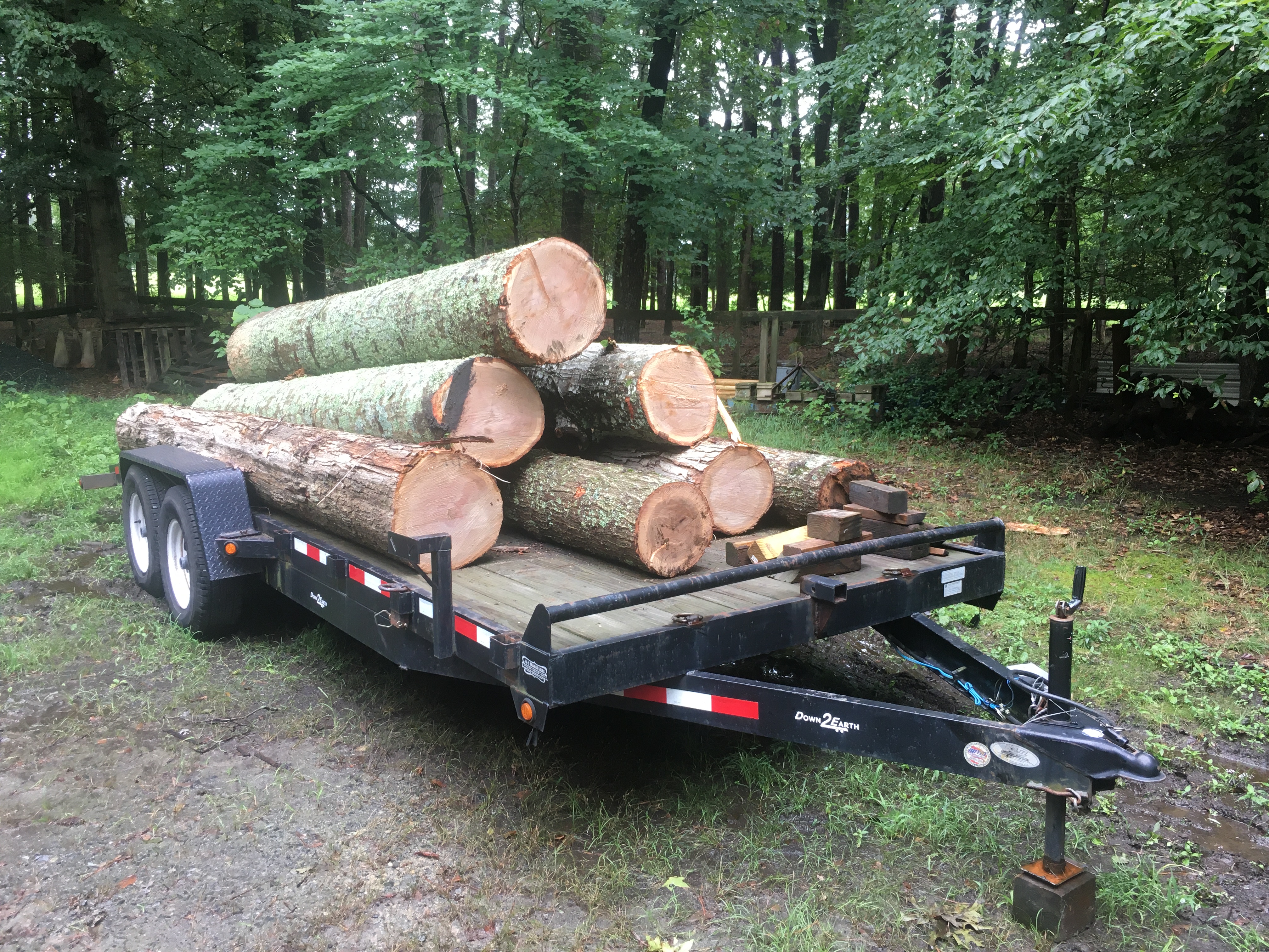

i've been collecting logs recently. some walnut
some red/white oak.

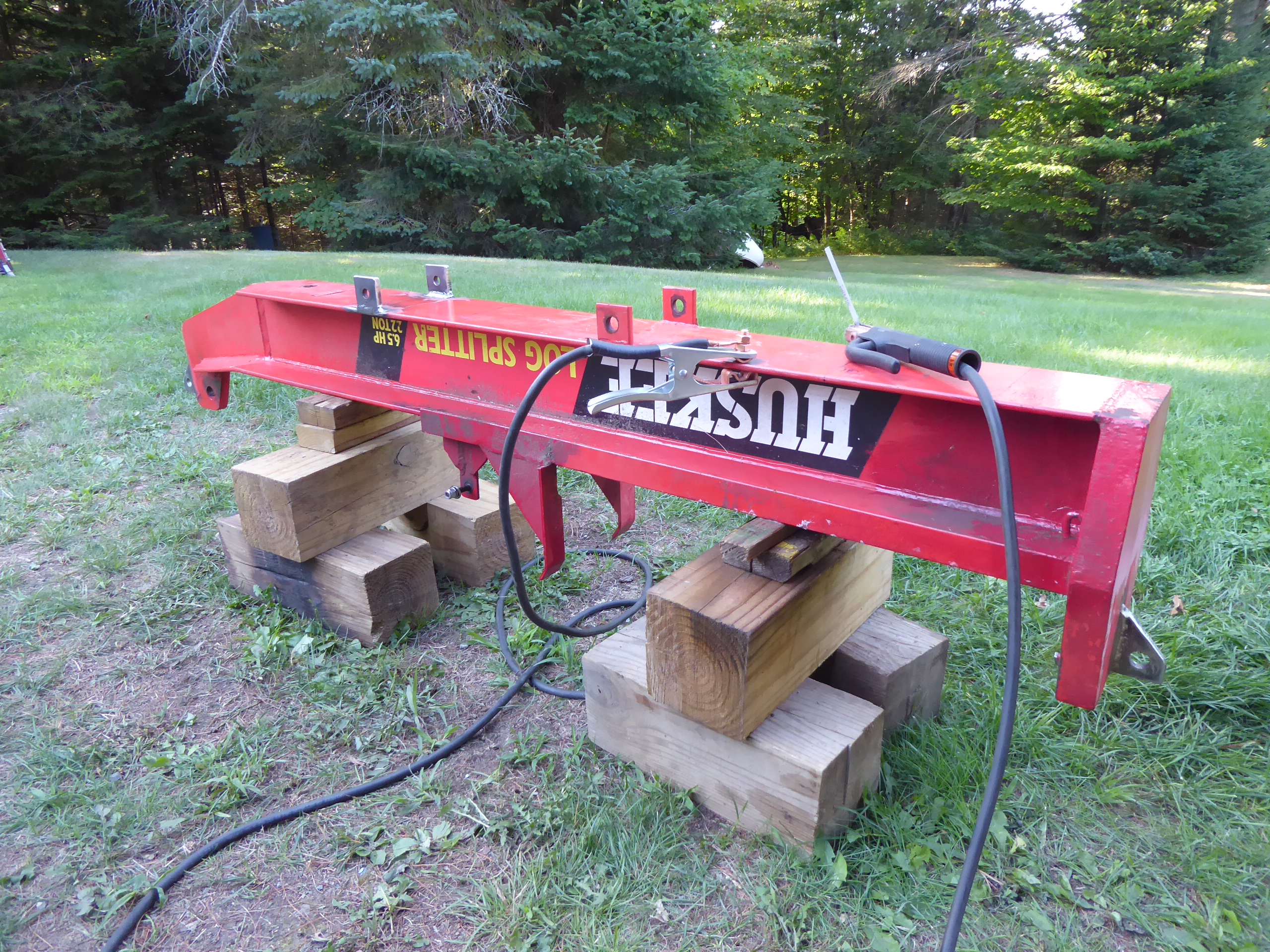

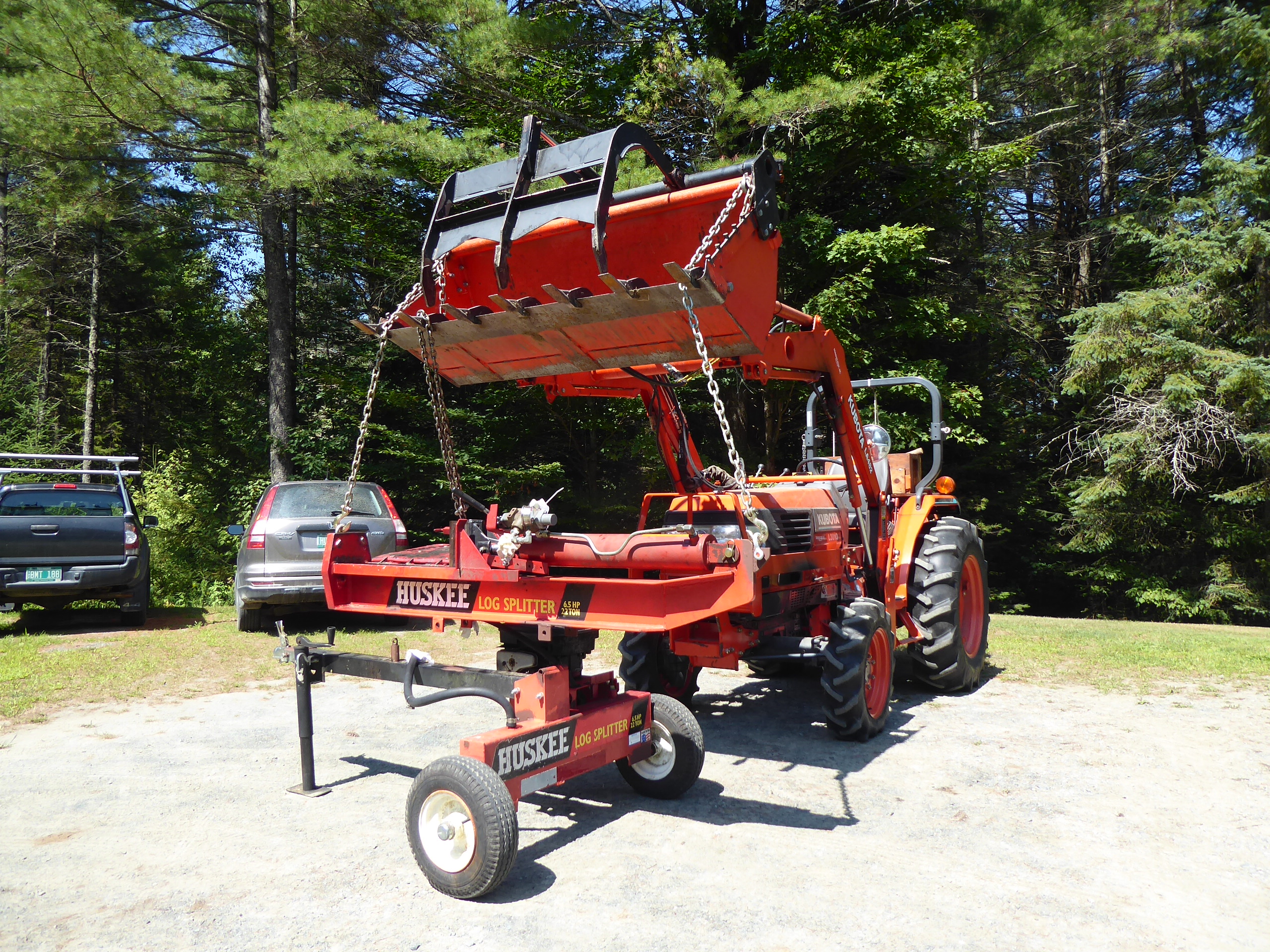

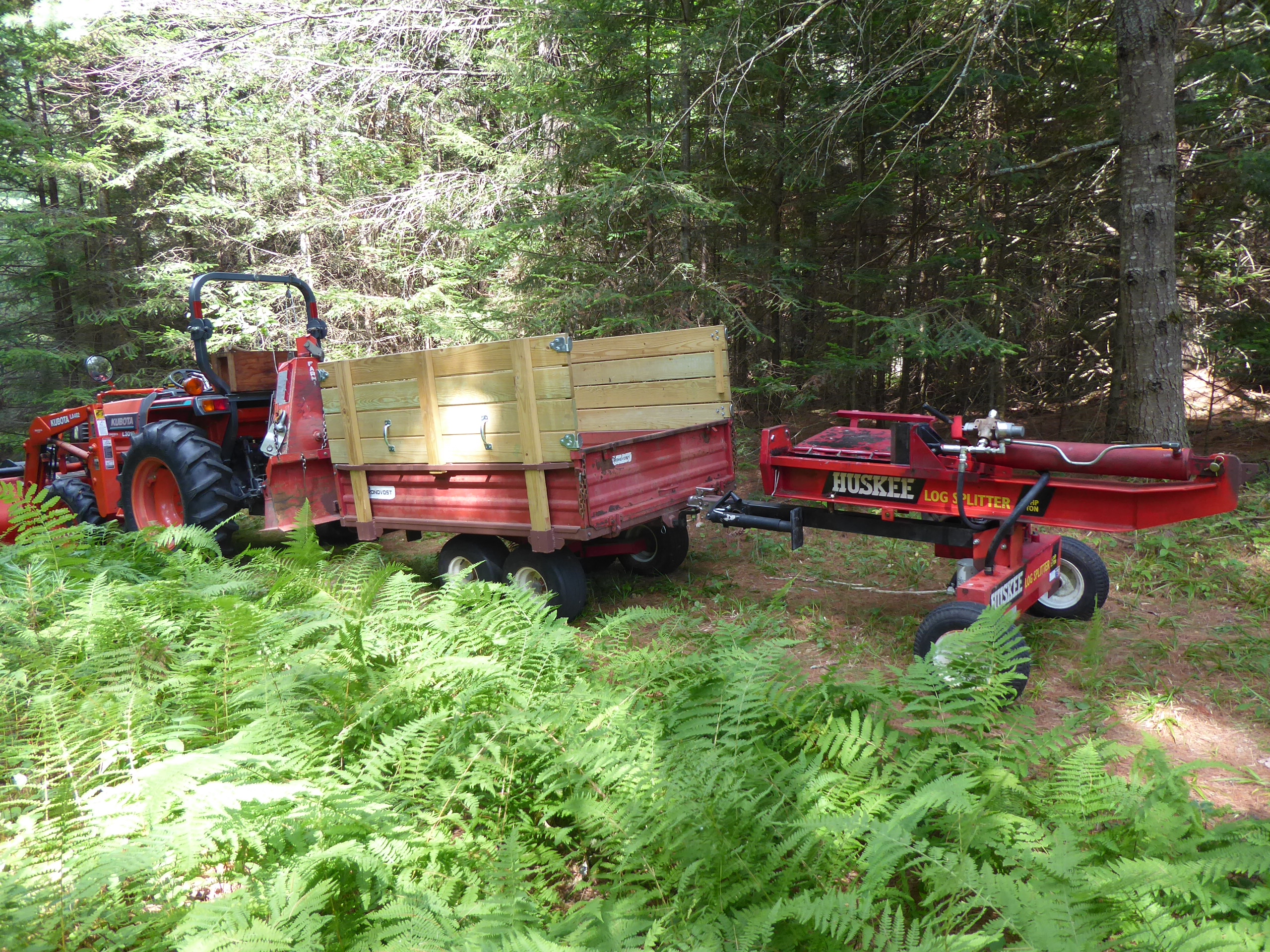

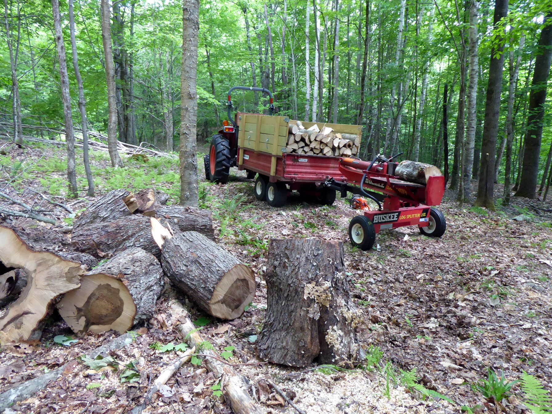

Thanks for the info on that processor Shooter. Looks like a pretty neat rig. As I looked at it I was thinking a higher price tag than it actually has.
Some times I like to run my trailer and splitter out in the woods and work up fire wood on site. It works pretty good. But the biggest problem is that it is a long throw from the splitting station into the trailer. A lot of pieces I have to take a few steps out around the tire to get closer before I can toss it in.
So I thought I would try to get the splitter turned around the other way so I would be working close to the trailer. Seemed like an easy way would be to put two more mounting ears on the beam and just turn the beam the other way on the frame. That way I could switch it back and forth pretty easy. In the process of playing around I found out the beam/cylinder were very top heavy and wanted to flop over if you lifted with straps under the beam so I put a lifting lug high on each end while I was at it.
To change directions I just remove the hold down clip on the hitch end, pull the hinge pin, and lift the beam free of the frame. Then turn the trailer frame around under neath it, set the beam down, and put it back together the other way around.
I think this will be a big improvement. I'm throwing from my strong side now too. An extra plus I hadn't planned on.

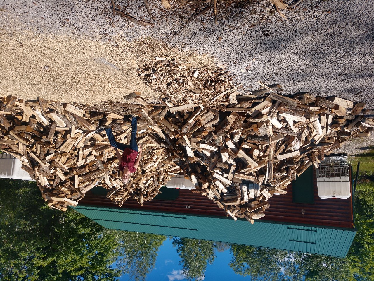

GG, yes the pretty lady is my fiancé!!! The photo was taken weeks ago after we had completed the processing work. Sadly, we learned three weeks ago she has cancer so we are praying for a good outcome. She was ticked that I would not let her help me stack any totes and felt sorry for me working in the heat alone. But she was recovering from biopsies, and it made no sense to push things.
View attachment 666607gg
Sometimes I guess it does help to read a post if pictures dont make sense, everything looked normal to me just couldn't figure what why you was welding on the spliter for, sometimes a picture isn't worth a 1000 words. Thats clever, should work good long as you have plenty of turn around room, backing up is out of the question.
