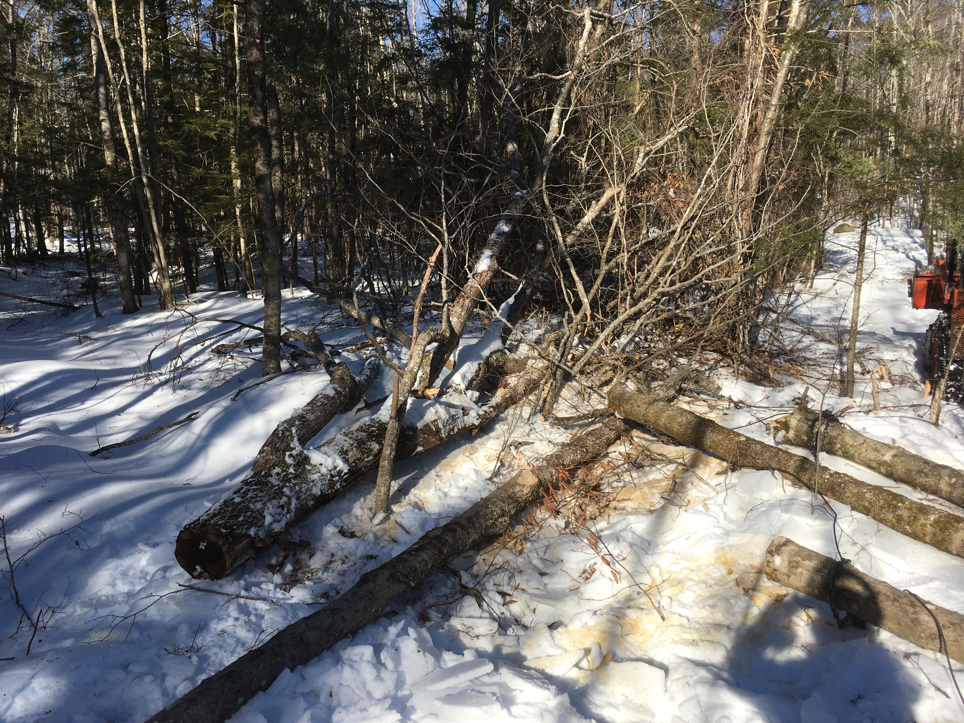

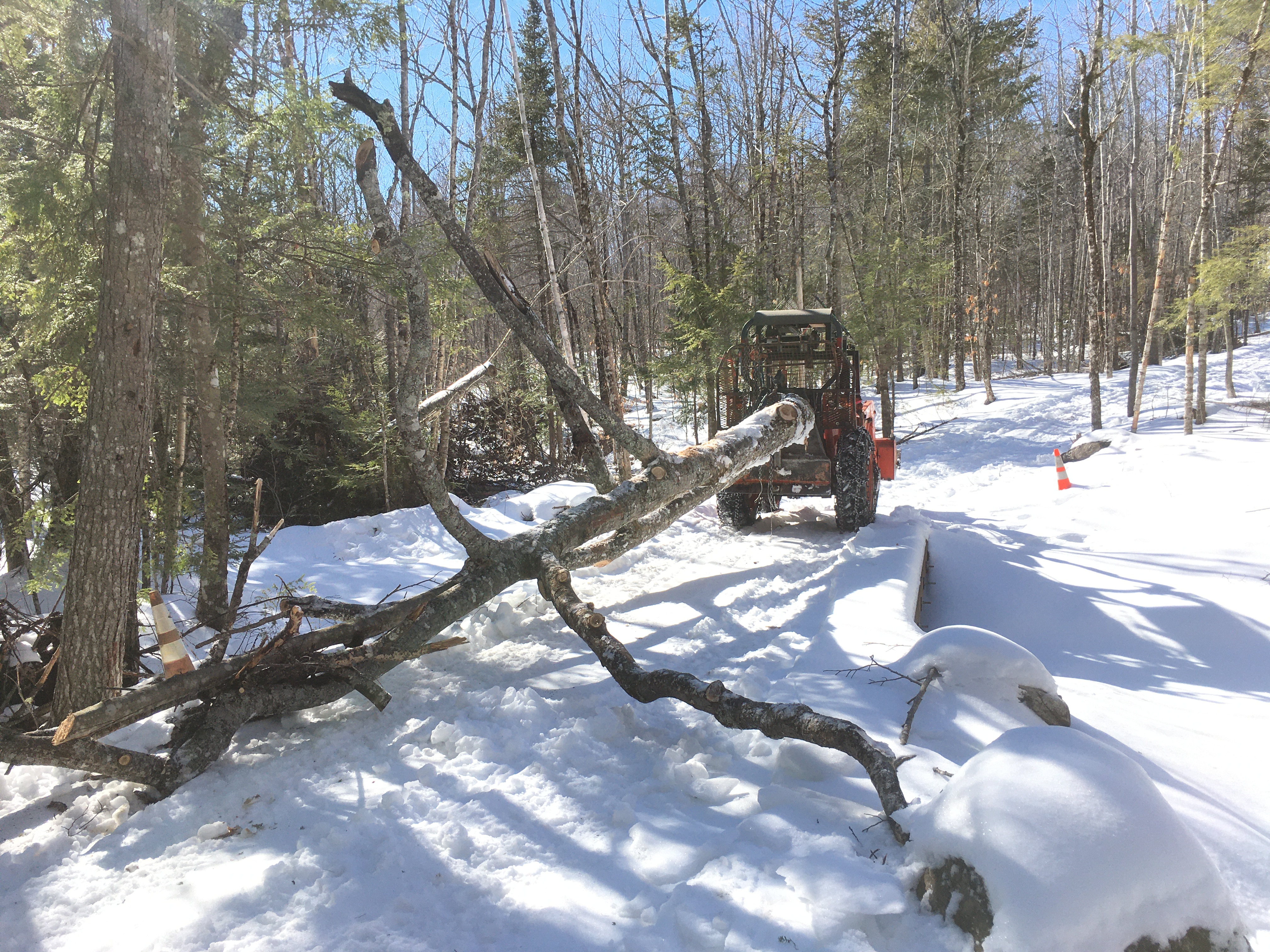

Theres about a dozen oak tops that need to be gathered up, some easy to get some not but all haul hard because of porcupine limbs. First pic is out, the 2nd pic is next week, the video is show and not tell.......
L34OO getting oak tops - YouTube
