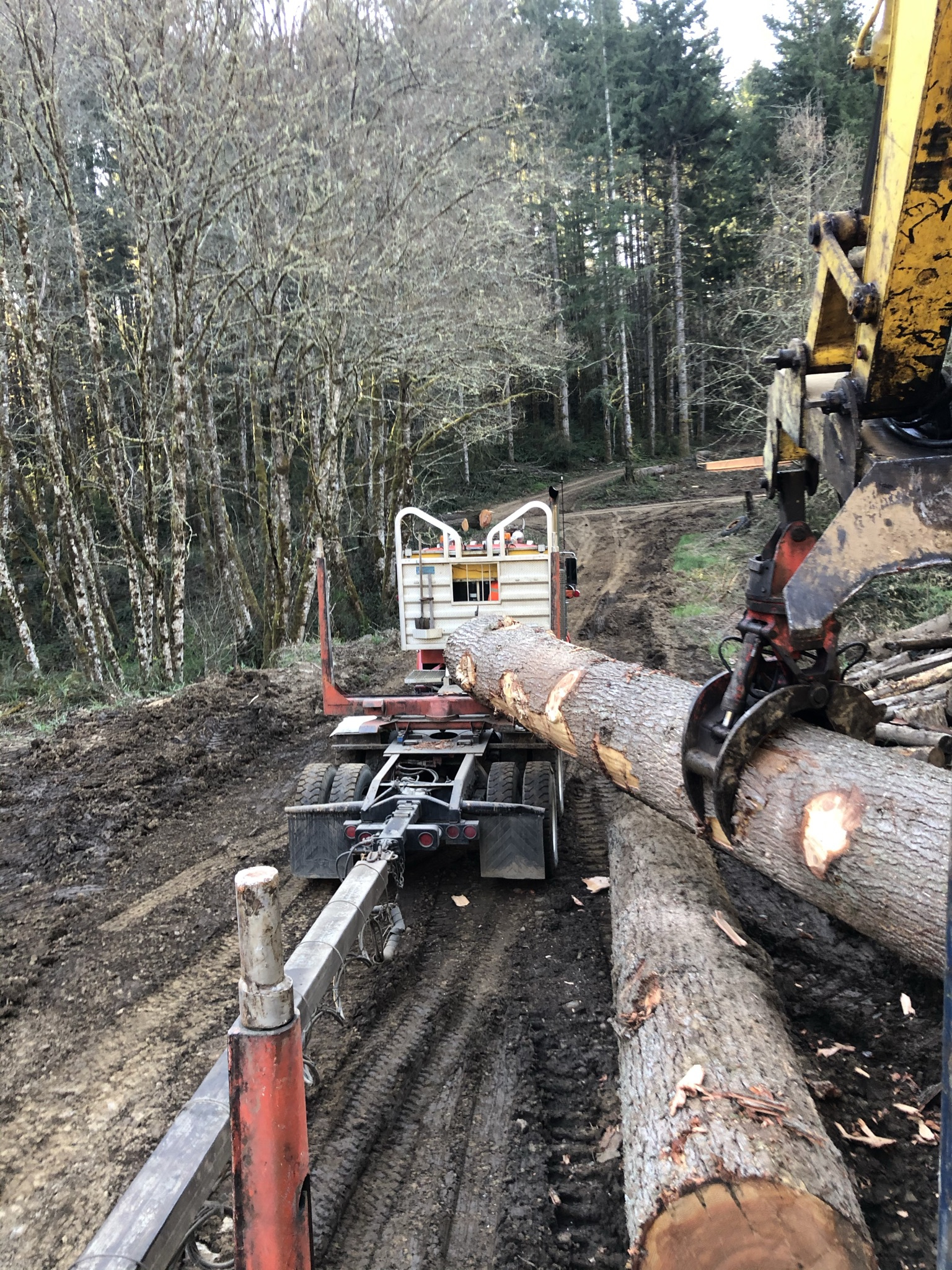

Try a grapple like this. Not heavy, bites the log, and allows precise control.

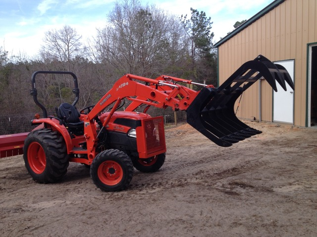

Looks very interesting. Only about 20 lbs heavier than my pallet forks. Around 350lb.
My HLA root grapple is ~950lbs. Really takes away from lifting capacity which is another reason I have been using forks .... this lighter grapple could be much better.

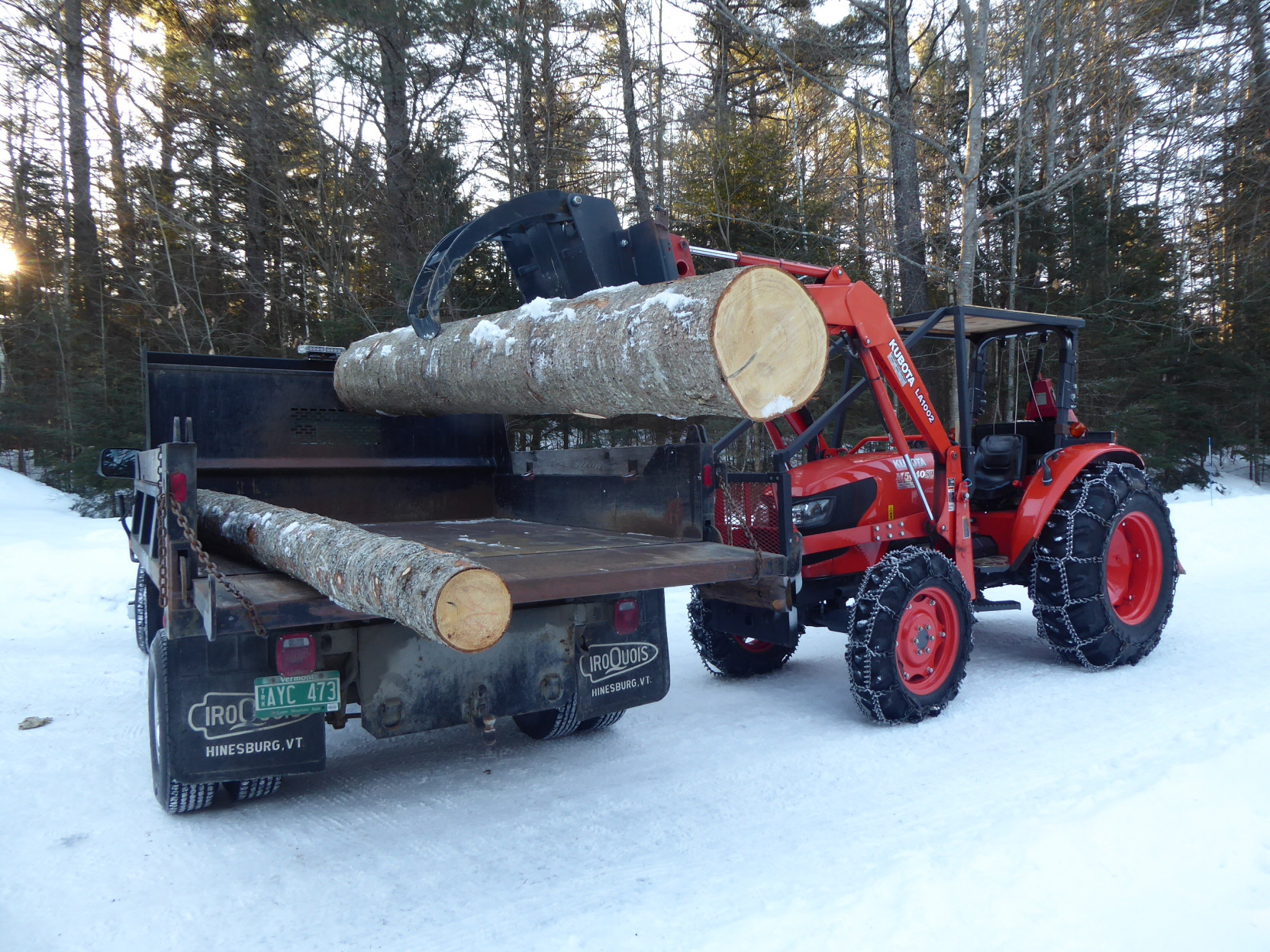

I have this one, its 4' wide and a bit lighter than my 6' bucket.. I its a no name job I got at an equipment place, works great.

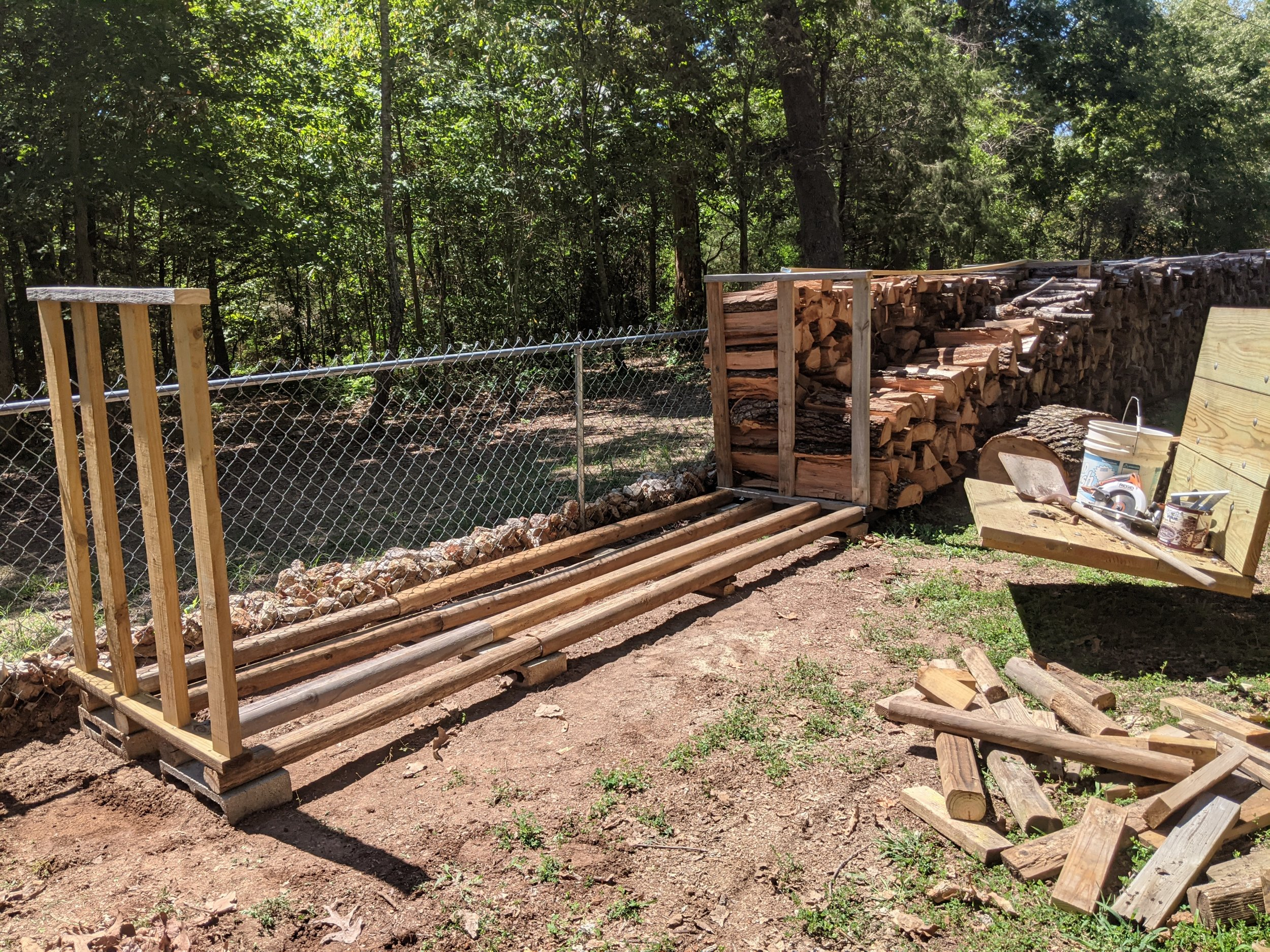

Used the tractor and carry all to move tools to work on building another rack to stack wood on. All materials were repurposed.

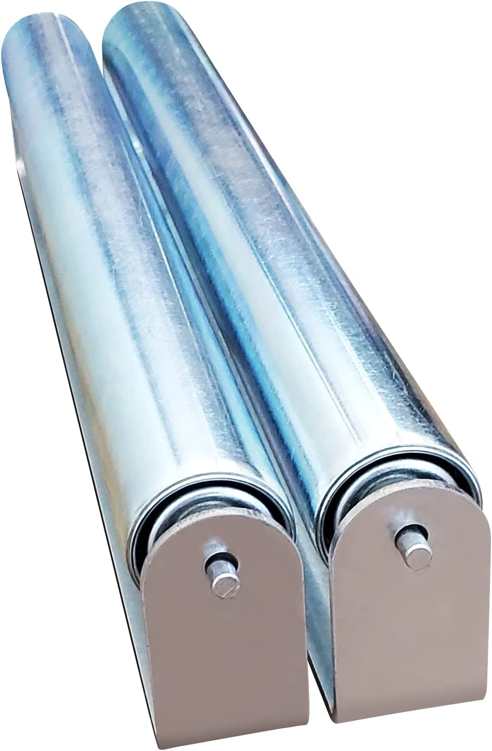

Just thinking out loud... what if you set up some rollers under the mill, 2 at each end running parallel to the log that raise on a jack setup. Some of you use a jack to help center the log for taper, what if that had rollers like an outfeed table to a table saw like these but farther apart:
This would take a lot of the friction out of the log rolling and keep it where you want it instead of having to roll then slide the log back against the uprights. granted this won't account for bark or knots, so maybe it needs to be solid wheels like these:
Weld up a plate bracket mounted to a jack, raise up under log, roll it to the side you want, then set back down on mill frame? You would only be able to use these when its still considered a log with some roundness, and not a square beam. Since I don't have a mill, I'm just throwing out an idea...
