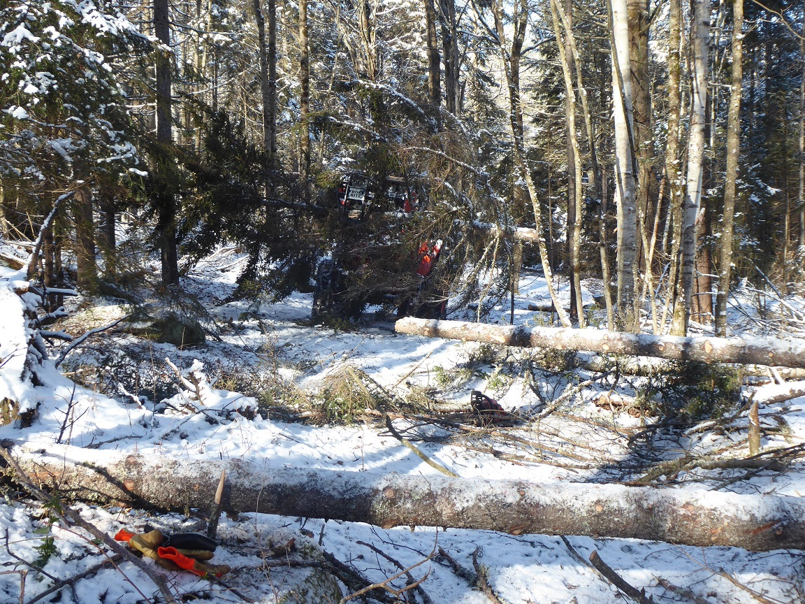

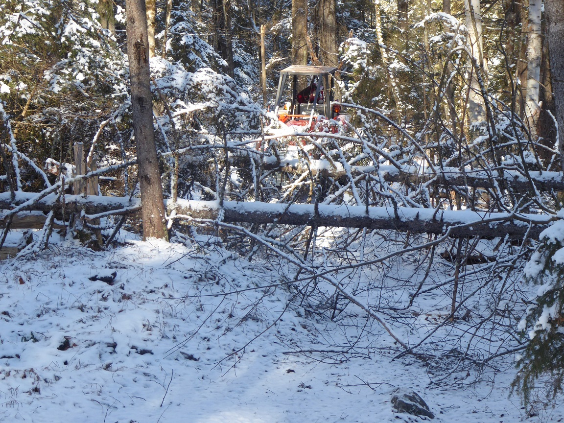

It was a beautiful winter day to be out in the woods - finally after all the warm, wet, and brown. Still moving Christmas storm blow downs off the trails. A couple of Red Spruce.
Limbed them out for stud wood. Grabbed the first top and backed down the trail to where I could put it to the side.
Winched them out into the trail in two pieces each using a snatch block and skidded them to the landing. The minimum stud log is 12'-6" long and at least 6" diameter on the small end. I got 6 logs from those two trees. Nothing to write home about but scavengers can't be fussy.

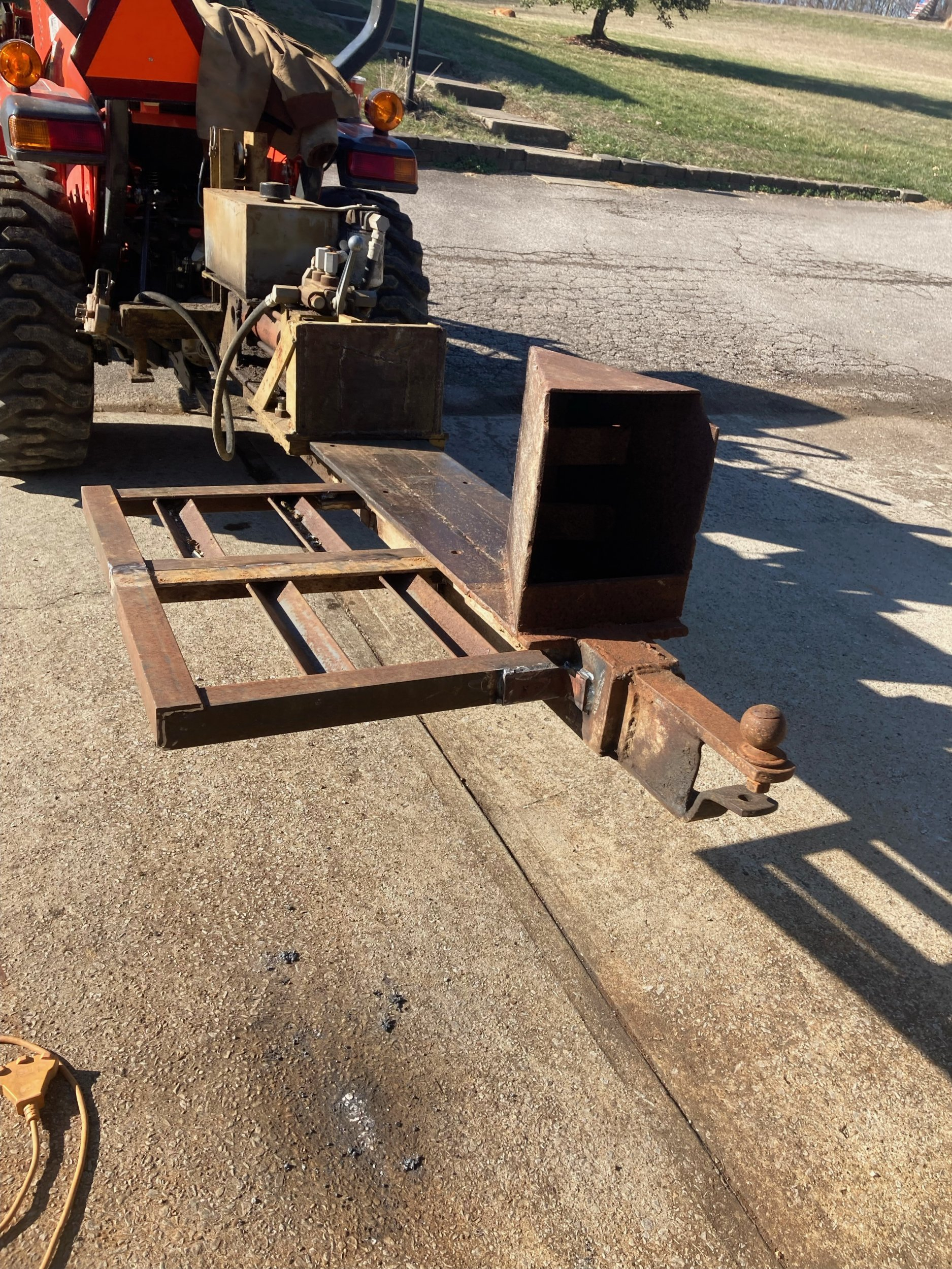

My take on a simple log lift and table for my Three point splitter.
I’ve wanted to add a log lift to my splitter for quite a long time, I’m not getting any stronger or younger. I also see the need for a table that one side of the split can rest on and not drop to the ground for me to have to pick up to finish splitting.
I watched a lot of YouTube videos, and I just didn’t want to spend the time and money for a hydraulic or cable driven lift.
It dawned on me that with a three point splitter I actually had the “lift part” already from the tractor. I had some scrap angle from a ramp I no longer use.
I lower the splitter to the ground then roll a log on the table then raise the splitter with the tractor hydraulics. I may add a extension to the end as a ramp for splits to slide off the end into my trailer. There are more steps involved (lowering hydraulics, rolling log onto table, walking back to the tractor lift).But it’s worth the trade off.
Mike

I like your splitter mike. Combo lift and table is a good idea (y)
