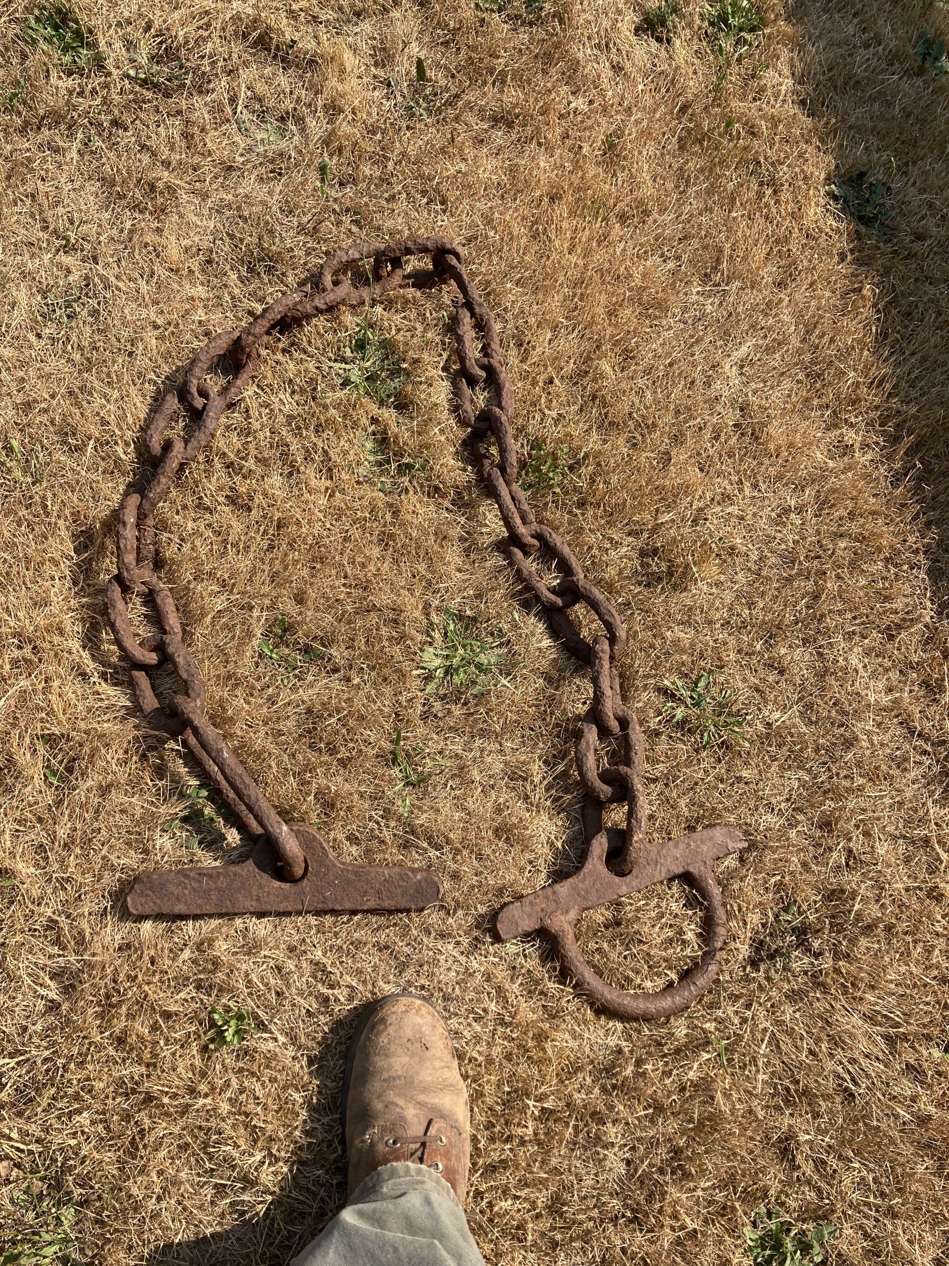

What was this used for? I found it in the woods, likely logged 100 to 120 years ago. It looks like it could be used as a choke, but it would be awful small for the trees in this area a hundred plus years ago when 3 foot diameter trees were considered weeds.

Apparently, Google says it is a boom chain. Used to string boom logs together to contain logs to be processed. I should have known that since I worked at a mill that floated log booms in the salt water, although I did not work the log booms. The perimeter logs had big holes drilled through them. The toggle end of the chain was slipped through the holes on the ends of the logs and linked into the loop end to hold the two log ends together. I don't know how it found its way into the woods. I learned something today.

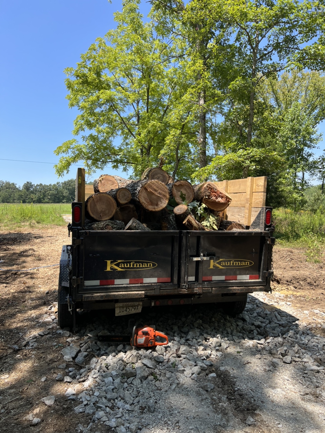

I hauled in a few loads of firewood. It will probably be a couple months before it cools down enough that I’ll cut and split them.

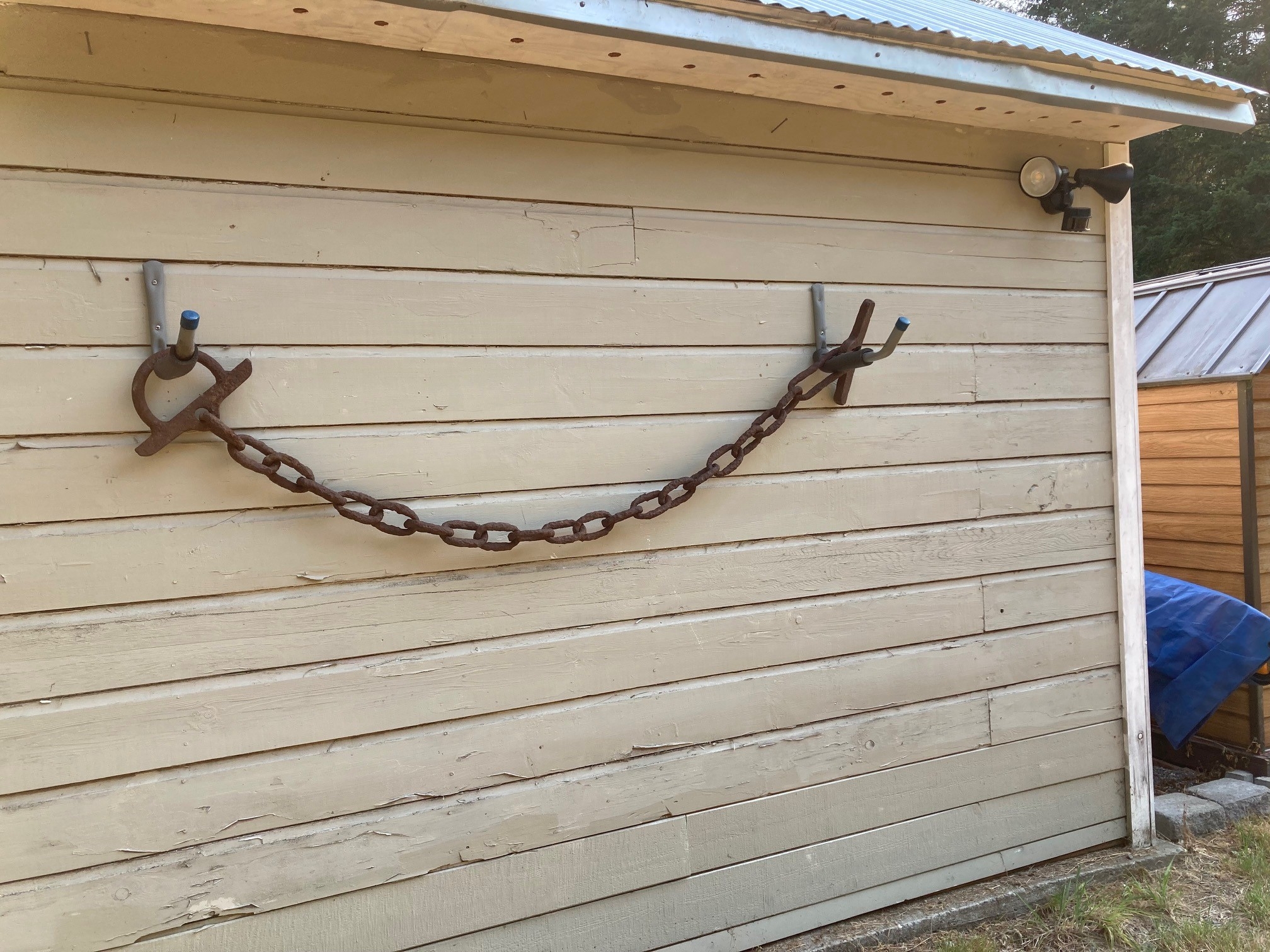

Could be a boom chain I suppose. Looks similar to several I have in the old barn my father had called bridle chains. They were looped around the runners of logging bob sleds when going downhill to act as drag brakes so the load wouldn't push the horses and cause trouble. The picture attached shows one. The end ring is missing as father removed it for another purpose. Heavy 5/8 inch chain. I attached a picture of a painting by a local artist titled The Day The Bridle Chain Fell Off. See the chain back on the hill and the result.

You are correct sir. It is indeed a boom chain. My brother in law was a boom man and log tug operator almost his entire working career. The boom sticks were 70' Douglas fir logs, with a 4" diameter hole bored through each end, about 1.5 to 2 feet from the end. The toggle dropped through the hole at one end of the stick, then a pike pole was used to fish the chain end out of the water so you could connect it to the next boom stick, through the ring on the end of the next chain/stick combination. This boom chain looks a little shorter than chains I am familiar with. I think they were usually about 8' long or so.

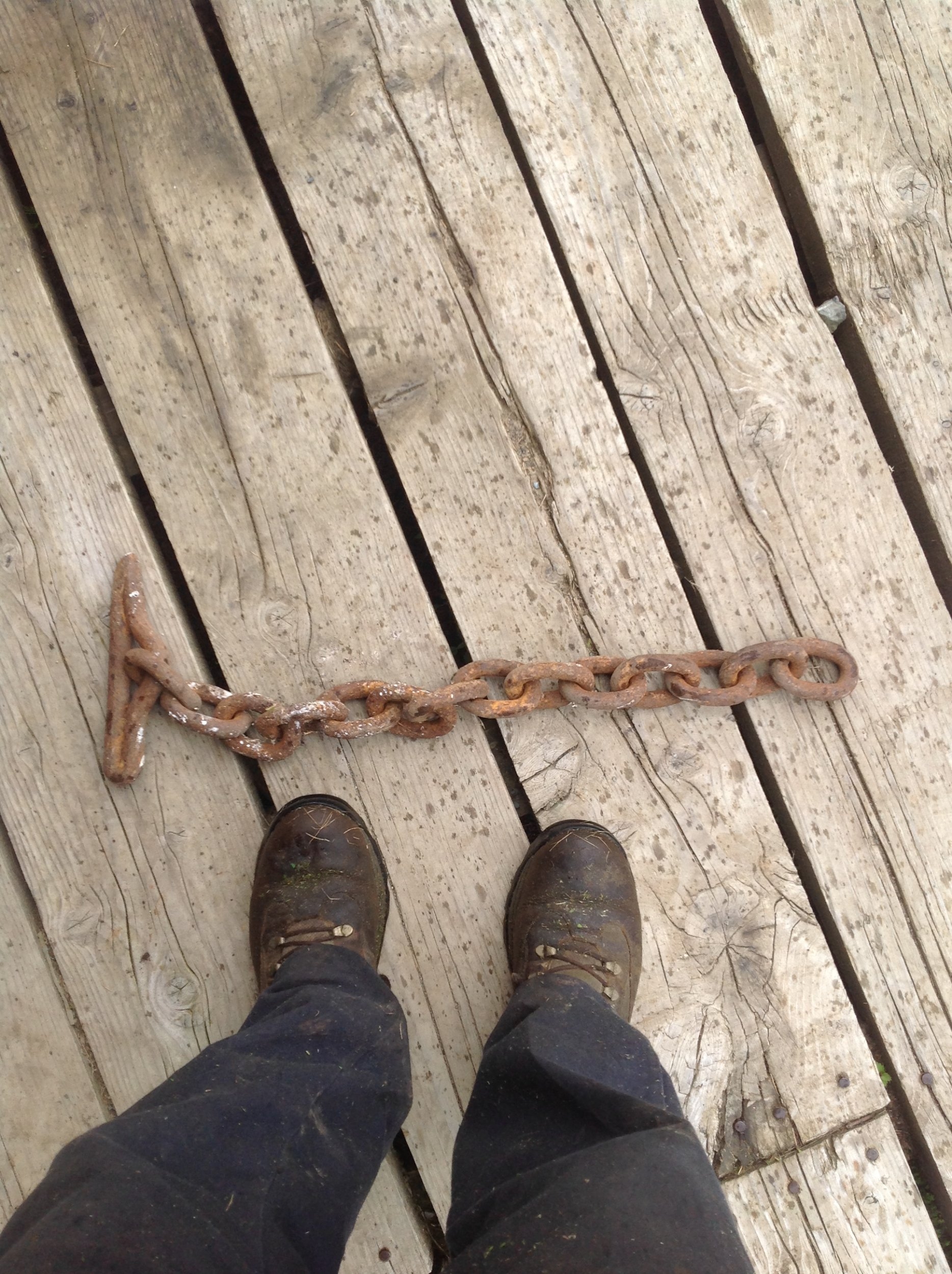

It might be close to that length; I did not measure it. Probably 6 feet. Here it is stretched out on an old shed wall.
