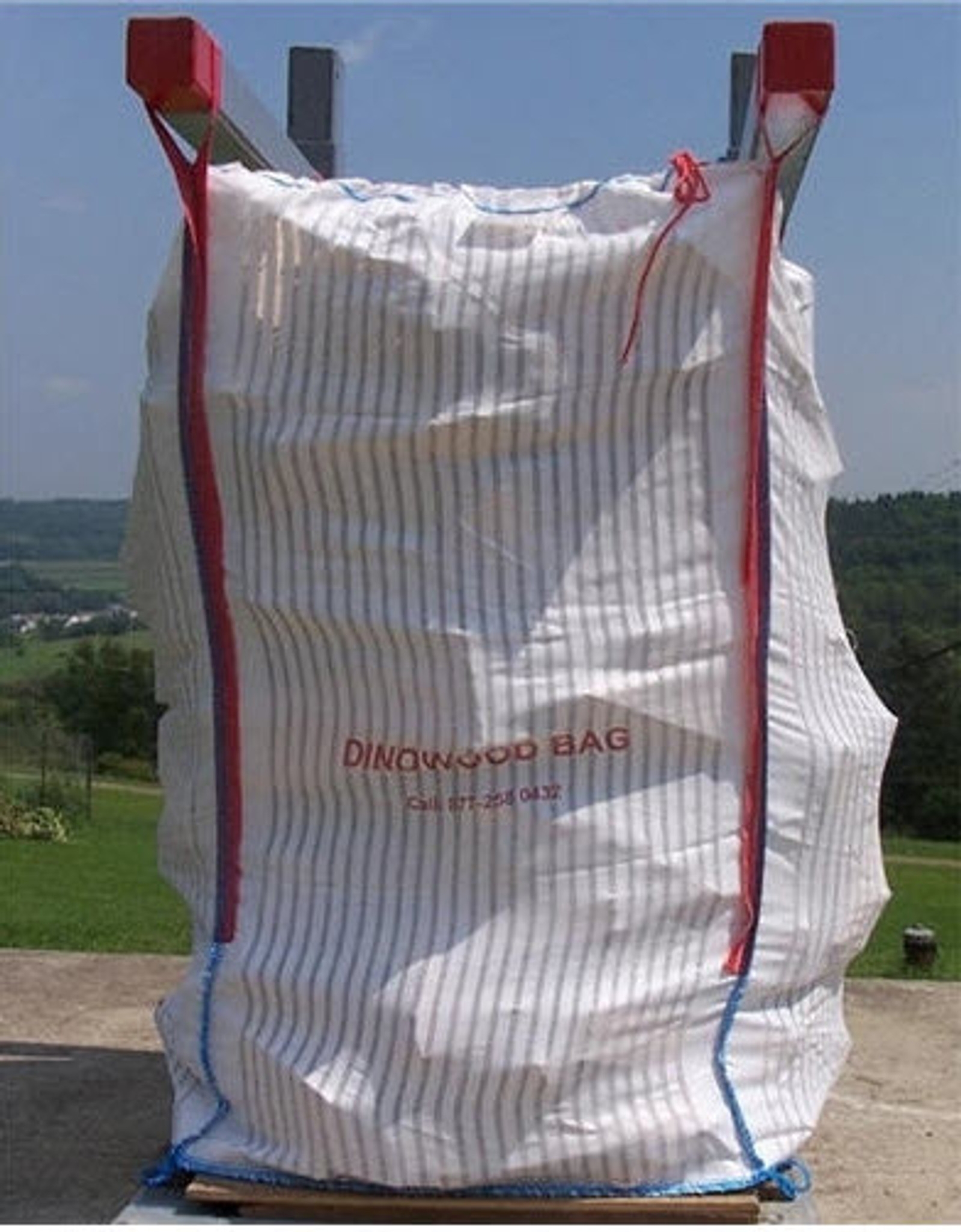

But the down side is the wood still needs to be stacked. So I am looking at using bulk bags than hold 1/3 of a cord and can be loaded directly off the conveyor of my wood processor:
The bags cost $16 each delivered and should last 4-6 years. I put them on pallets I get for free from the local industries. This is the second year I am testing bags. Using bags, and the processor, I can cut logs, split and pack a cord in about three hours working alone. Using IBC totes, I need a person stacking.
Almost any tractor can lift 1/3 of a cord on the 3 PH. I have forks on the 3 PH and a grapple on the FEL.
Last week did 2 cords of oak firewood bagged in less than 7 hours. Not a "walk in the park, but not back breaking either. The processor works best with logs 6-12" in diameter and without a lot of twist or "knobs". left by branches I have learned to cut off the "knobs" to ease feeding instead of manhandling 12"x8 ft logs.
No perfect system for everyone, but sharing ideas gives food for thought.
I typically work alone and hope to have a small side business, so the investment was worth it for me.

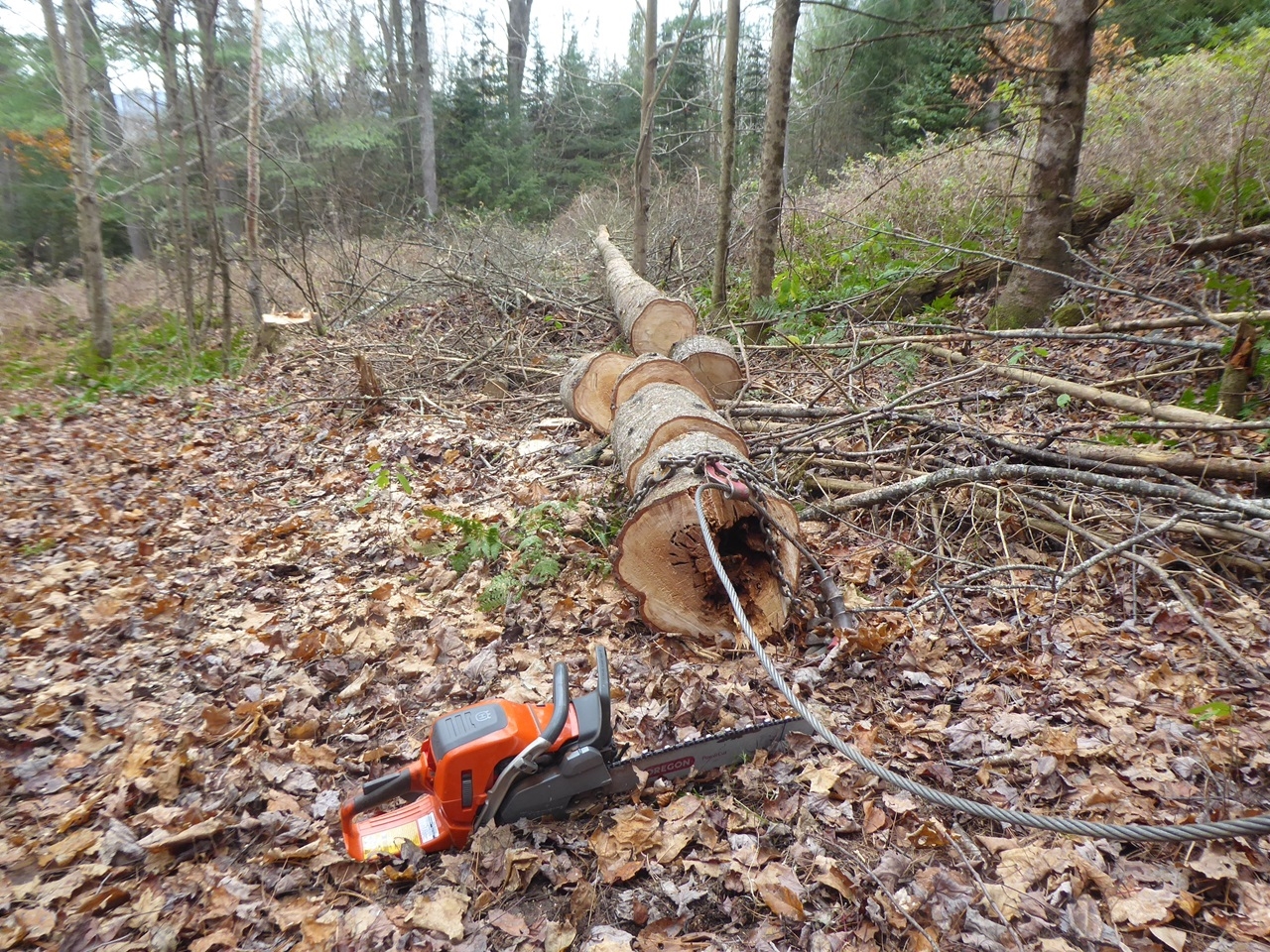

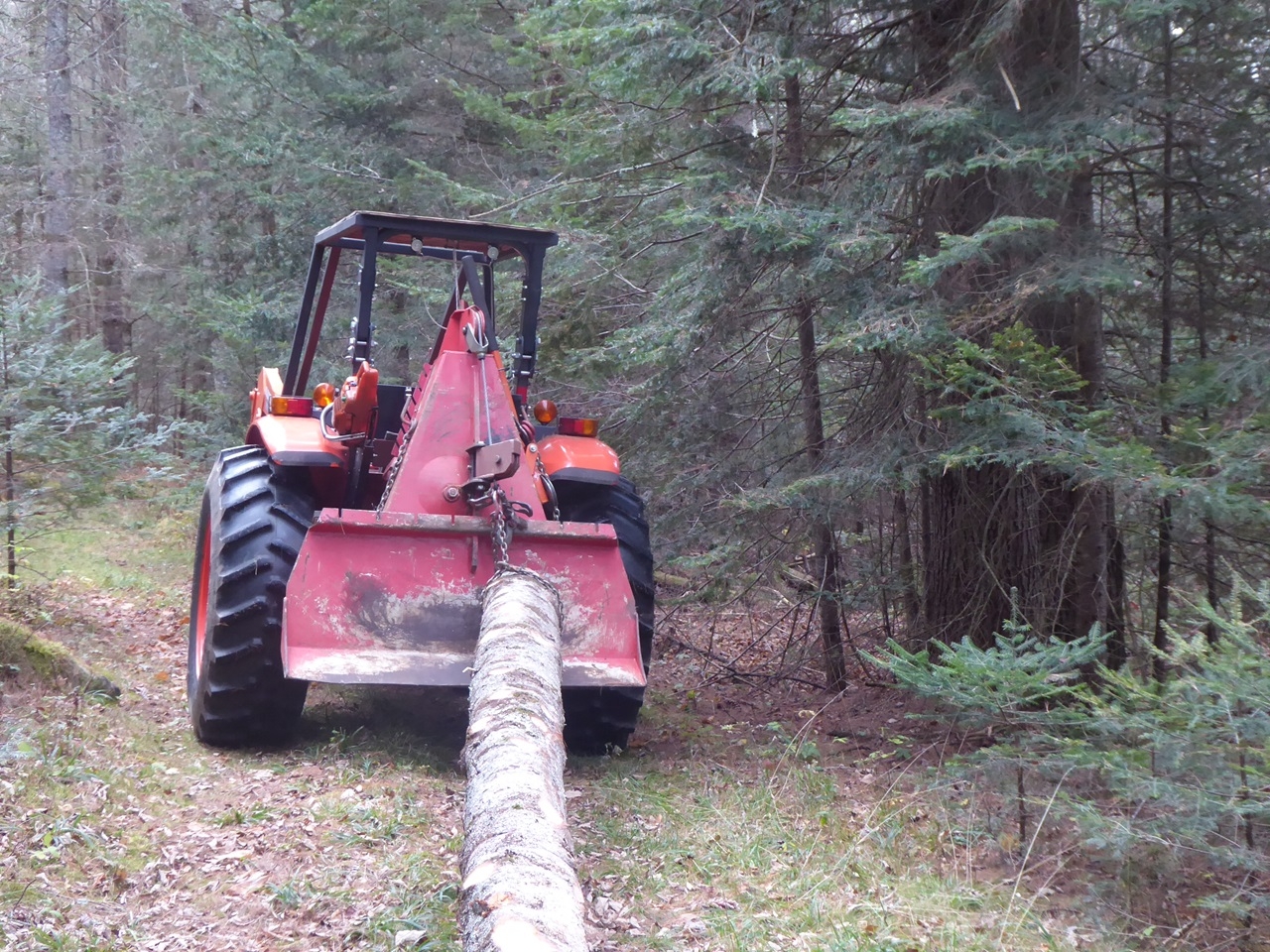

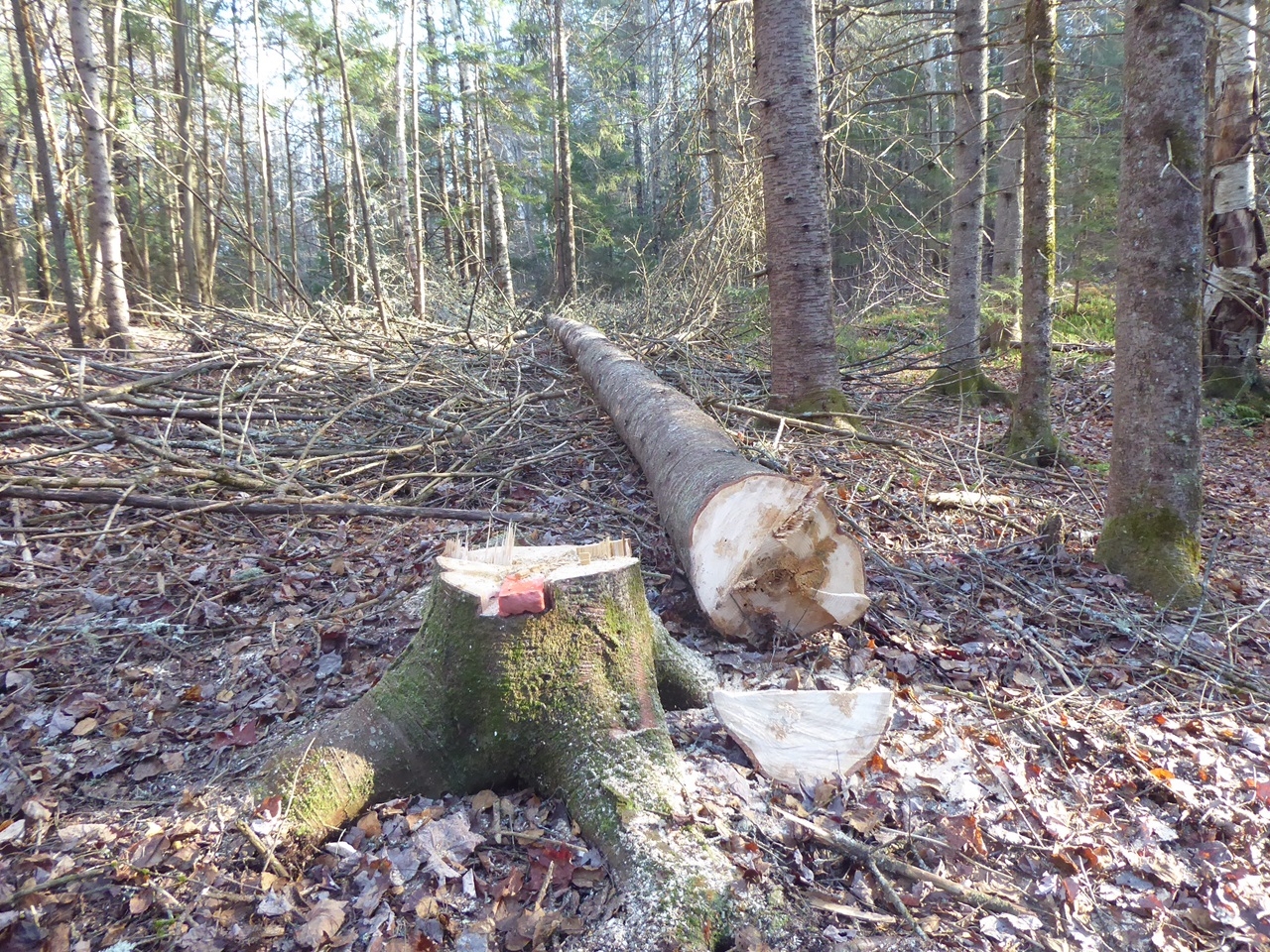

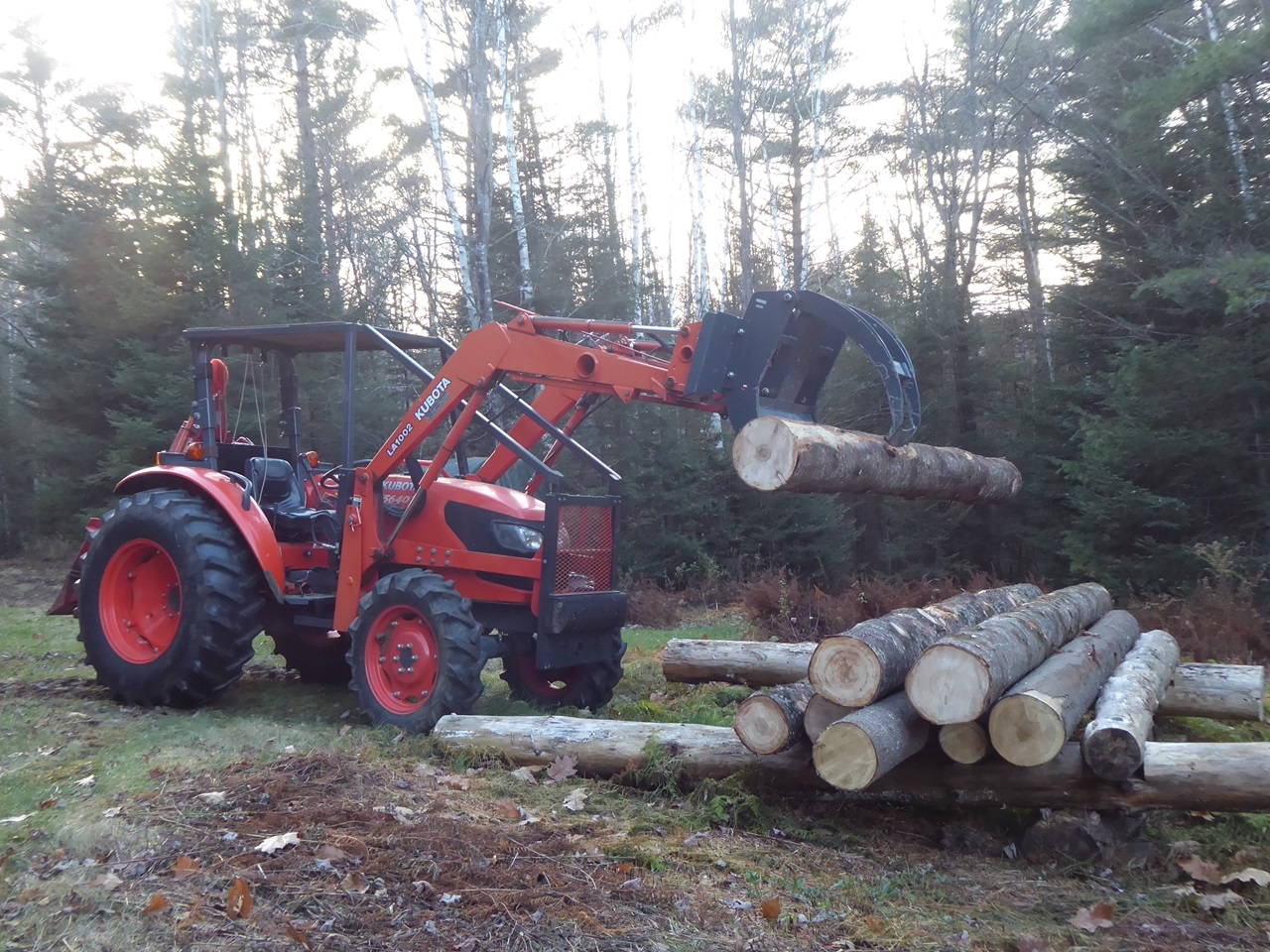

I haven't been out in the woods cutting since August. But finally the other day I started cutting some junk fir to start a load of stud wood logs. I pick up any easy firewood as I go. My favorite winter activity. I had the camera so I made a couple videos for fun.
After going by this little bound up Yellow Birch a couple times I decided to stop, get it out of the way, and add it to the firewood pile. Size doesn't matter.
This one had a leaner lodged in it and was hung for a while before coming down.
