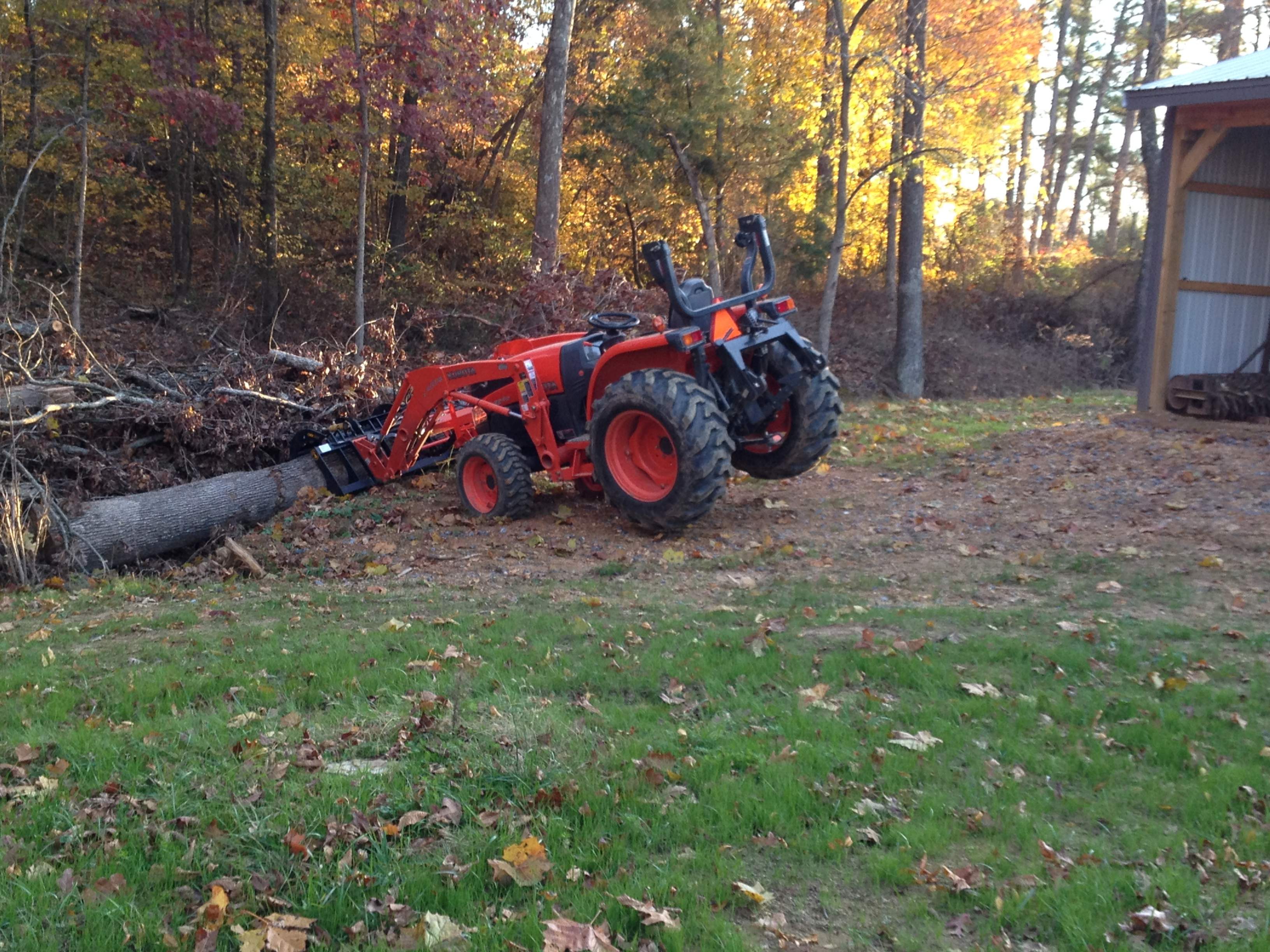

Here is a shot of my little Kubota trying to pick up a small log, ended up dragginh it out of the ditch instead of lifting it out, it's all firewood now.

Ummmm... I know you're going to take some heat for that pic so don't take it personally and listen to the advice given. What you're doing is torturing your front axle. Your manual lists how much ballast is required for your loader and you're not using any. Loaded tires don't take the stress off the front axle either, that's been debated here and finally had somebody try it out at their local scale. Anyway, it's probably not overly safe, but I'd be a lot more worried about damaging the tractor, you now have the weight of the log AND the full weight of the tractor swaying back and forth on your front axle.

Apparently front axles and FEL arms are made of balsa wood 'round these parts.
While I don't disagree about ballast etc., it isn't like the tractor has been driven like that its whole life.
On the other hand, with that ROPS down, you're going to die instantly. Get that thing up if you're even still alive.
Somewhere not on the internet, we've all been there. I enjoyed the pic. I wish I had a grapple.

The rear was only up long enough to take the picture, thought it was cool that the loader actually had enough oomph to lift the back of the tractor. I took the picture and then let it back down.
<img src="http://www.tractorbynet.com/forums/files/owning-operating/401119-tractors-wood-show-your-pics-img_0911-1-jpg"/>
It is best to square off with the load so the loader is lifting close to equal weight on each side otherwise you are twisting the frame while under heavy load. As was mentioned, you now put the entire tractor's weight on the front axle plus whatever weight you have lifted of that log. A good ballast REAR of the axle REMOVES weight from the front axle. As also was said, the ROPS should be up. A load extreme to one side can tip a tractor on its side when lifting. Not to mention roll over possibilities in other situations.
Having said that, nice looking tractor and firewood!!

Good way to pop front seal,more so if quick jerking on loader.

That's what I figured, I reckon we all had similar experience...I know I have but maybe not to that extent. We live to learn , thx for the pic .
