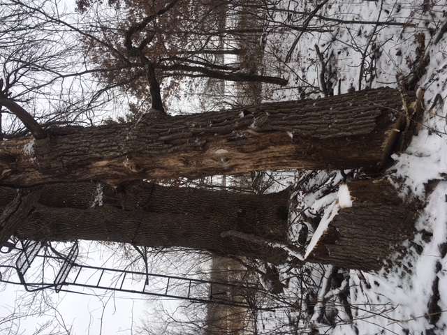

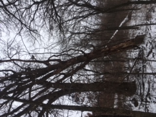

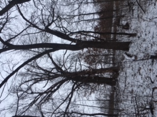

So, I need to pull down some trees that are hung up on other trees. Some are very large oaks. I own a small 25hp tractor. After some research, it looks like a few snatch blocks and cable will do the trick. I don't believe I need to invest in any sort of winch attachment to do this, as I just cut wood for myself in my own woods. Maybe a hand winch like the More Power Puller would do the job, but that thing is over 300 bucks. So, could someone recommend a few snatch blocks and cable? Other thoughts?
Watch the sales at Harbor freight, you can get a 12,000# winch for that tractor for $300.
Or..... 65' of 3/8 cable for $35 before discount, snatch blocks $28 before discount & the 20% coupons are easy to get.

What’s the plan of attack. Cutting the base off the root ball and pulling backwards?
   / Tractors and wood! Show your pics #5,277
No roots attached.
I've rolled many leaners out of the tree they're hung up in. Wrap a chain around the trunk many times, then use a tractor, 4x4. or come-along to unwind the chain. Doesn't take nearly as much horse power / brute strength to roll a tree as it does to pull them down.

Here are some pics of the tree.
I plan on pulling the trunk of the tree away from the leaned on tree.
