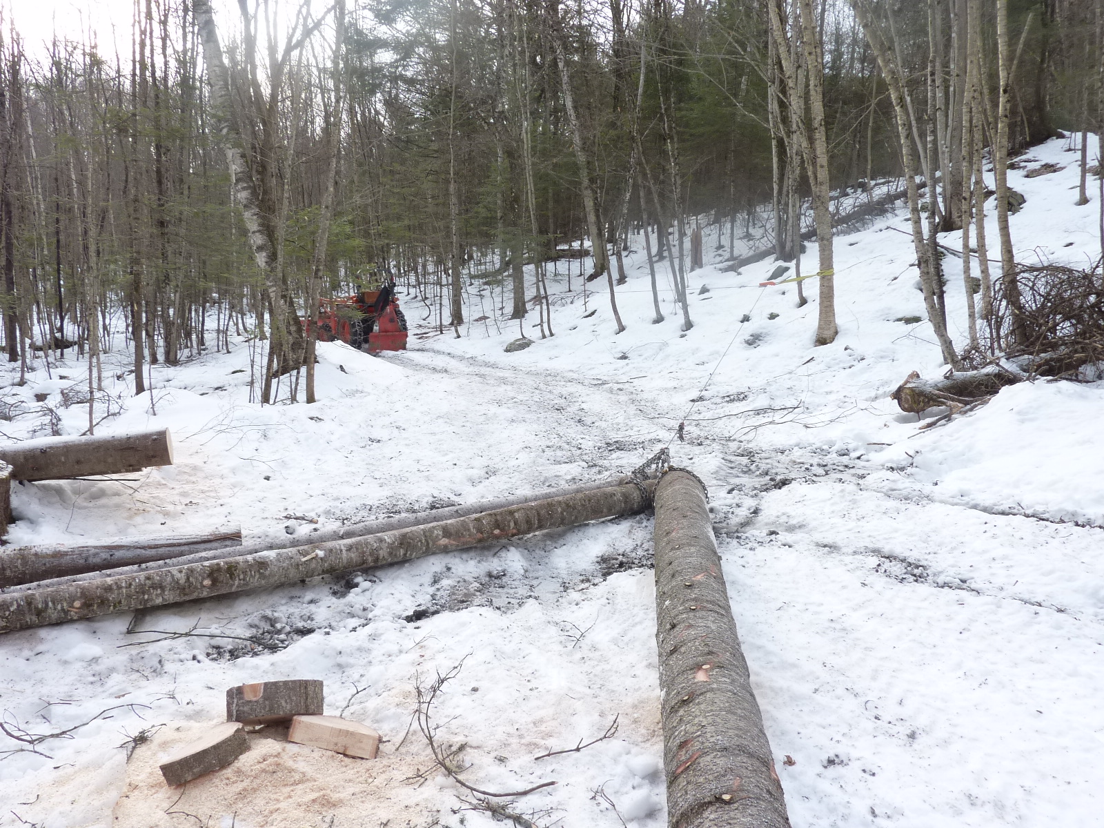

Here are some pics from today's little operation. It went pretty smooth which doesn't always happen. I cut and limbed 8 fir trees. I fell them away from the trail so all the slash would be down the bank. As I cut them I trimmed the rot off the bottom of the butt, cut the top at about 6" diameter, (The mill takes down to 6" on the small end) then I winched them up close to the trail but out of the way.
I set my self release snatch block on the far side of the trail and pulled logs out of the woods one hitch at a time.

The next two are the last hitch on the skid trail. The skid to roadside is about 1/4 mile. It doesn't look it but it is pretty icy which is great for traction but not so great for steering . I have to use the steering brakes in a couple places to keep the front end from sliding side ways down hill.

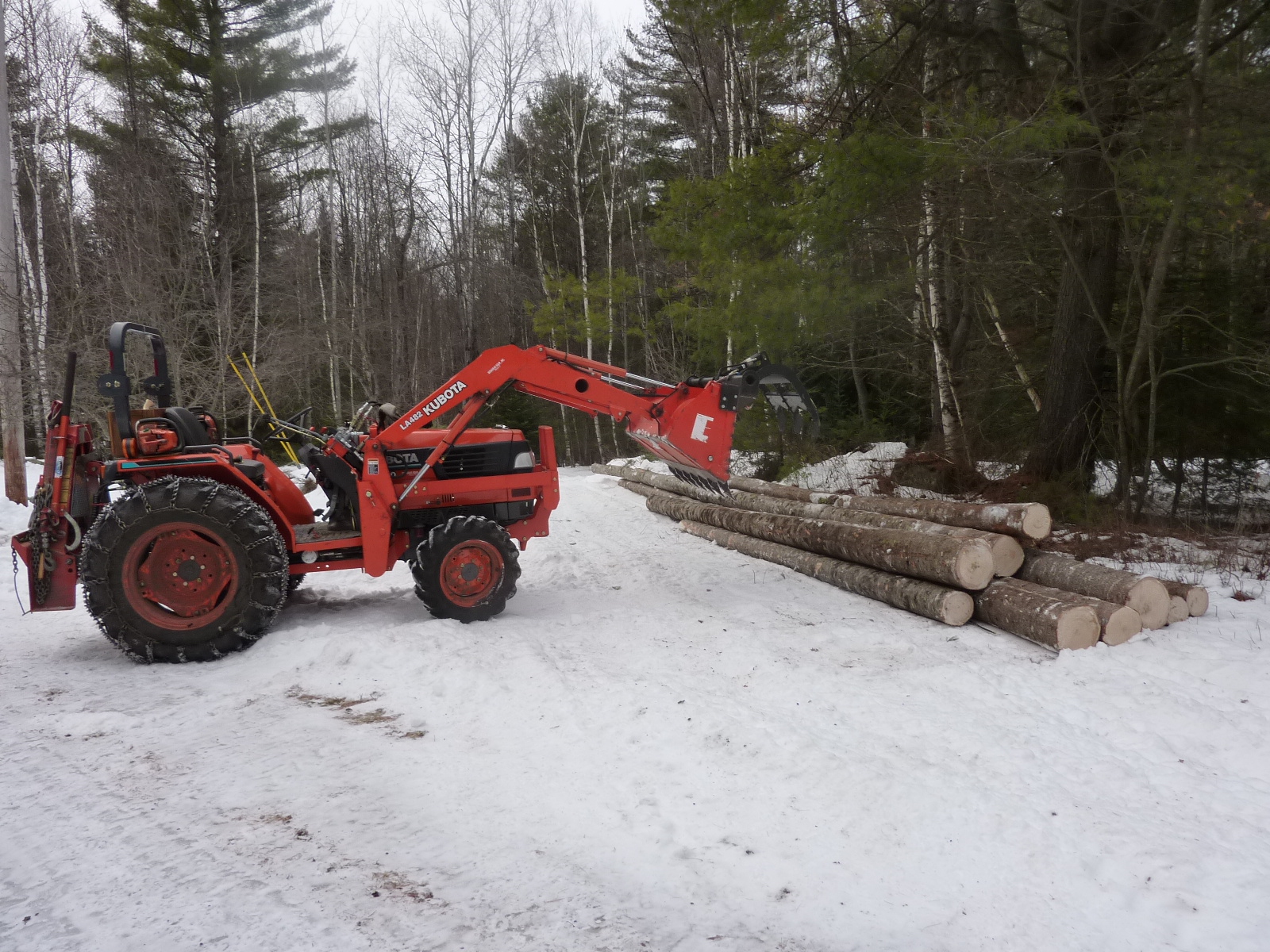

My little roadside landing. That is a strong cord of wood. Tomorrow I will cut it into logs either 12'6" or 10'6" and bring it to the mill on my one ton dump truck. It should make a little over 500 board feet of lumber. My check should be about $175.

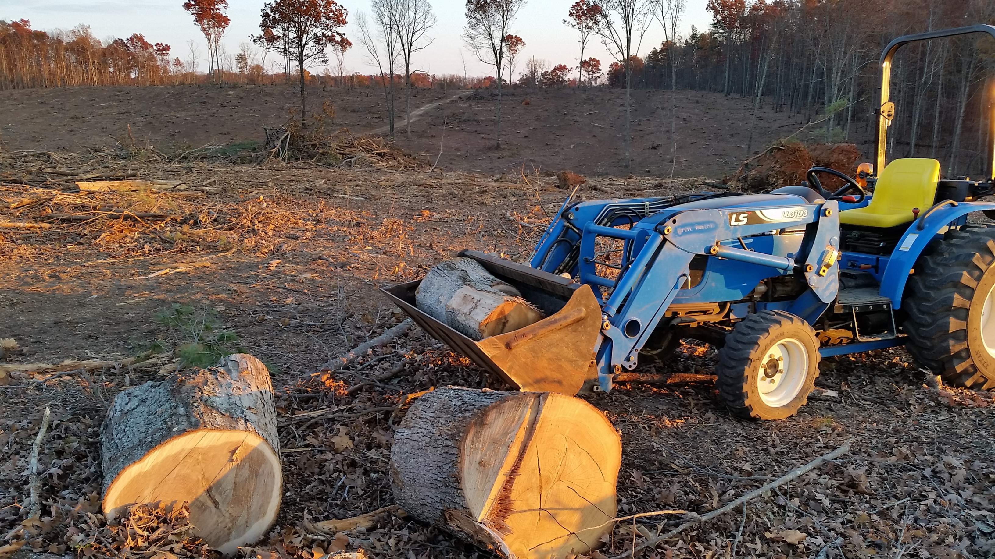

OK, posted a picture of 'major' wood in last post but forgot the tractor so here is the obligatory 'tractor and wood pic'
Looks like the start of a wonderful setting in a lovely slice of nature.
Are you replanting or turning it all into bowling green or crops, or ?
What equipment and system did the loggers use to harvest and did they or you clean up so well afterwards? I seldom see land left in such good condition after harvesting here.
