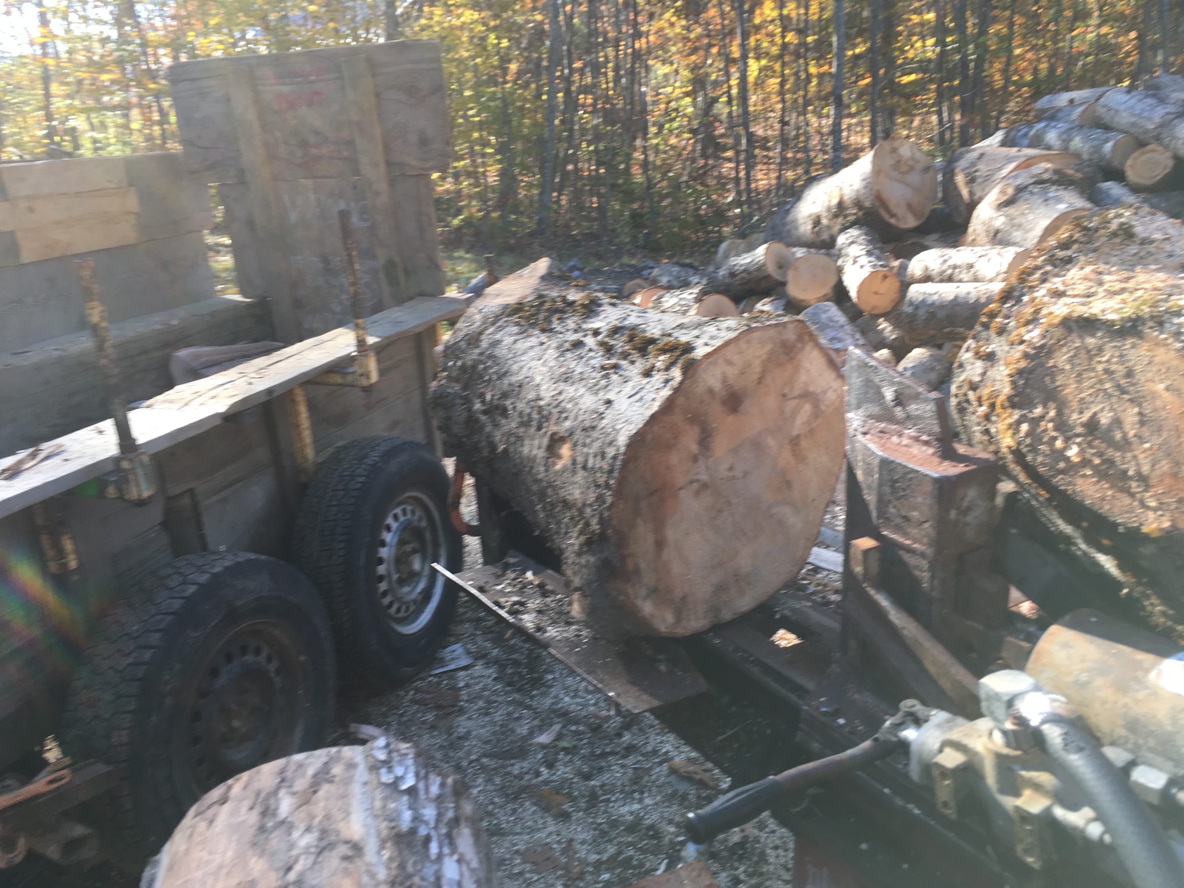

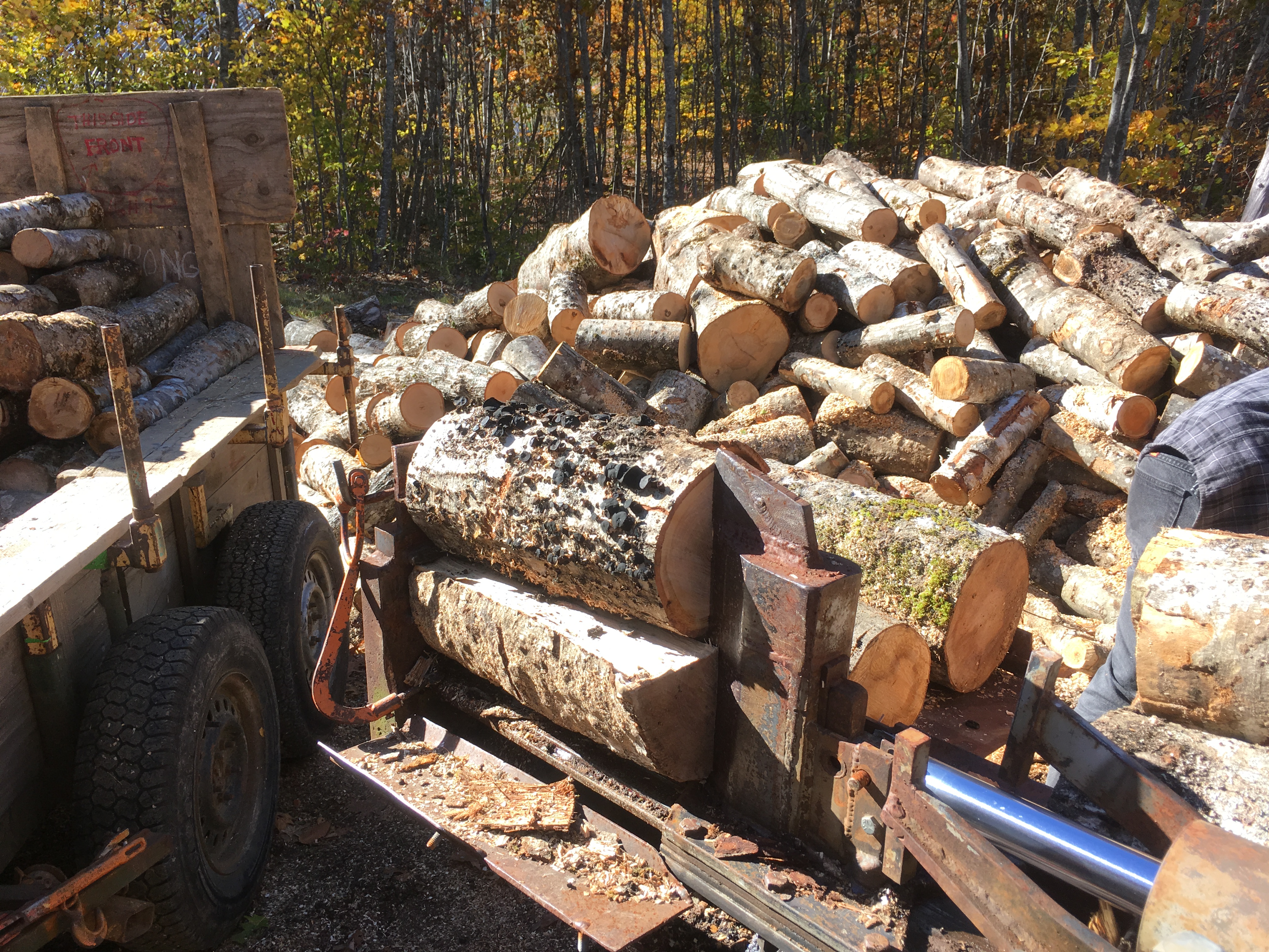

Another round at firewood, this time making rounds outer round. I haven't run wood splitter in a year, 4 pulls and fire up on last years gas with Star-Tron, one thing I notice about wood splitters, they last a long time so choose your weapon wisely, the first thing I did was increase the wedge size, the standard wedge size mine came with was pathetic,

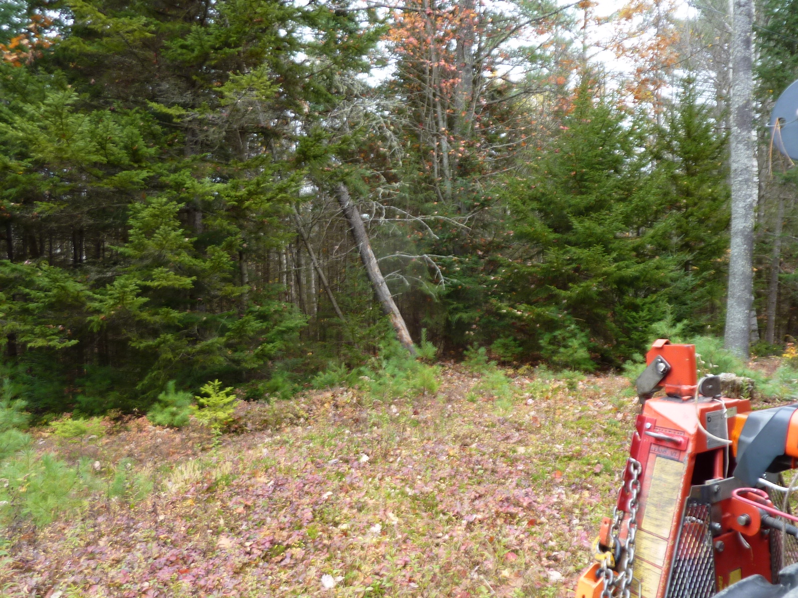

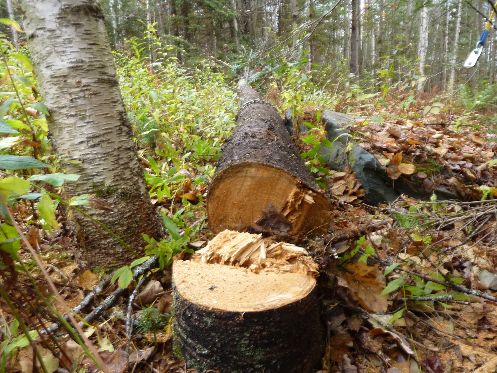

I did some pre-winter roadside maintenance today which included taking down two dead trees leaning out towards the power line. I used my winch and a snatch block set up as an aid. When you do this on a dead tree you have to be careful that you don't break the hinge as it can be very weak. If the top meets resistance from an obstruction when you winch you can break the hinge and cause the tree to fall the opposite way directly towards the thing you were trying to protect. Just a cautionary note in case you haven't tried this before because it is very different than working with a live tree and it's pliable strong hinge.
The first one was a pine. They usually stand a long time after dying and this one has but is now starting to look pretty shaky.
First I put just a little pressure on it with the winch and lock the break then I cut the notch and back cut leaving a healthyish hinge. Then go back to the winch and pull it over. I leaned this pine on a clump of fir, took off the snatch block, reconnected the cable to the butt and winched it to the tractor pulling the tree out and down.
The next was an 11" diameter pin cherry. Pretty big for a pin cherry. They rot quickly and don't stand long at all after dying. This one required more caution because besides the rot the top was entangled in a neighboring birch. I went very easy with the winch pulling it over and kind of shook it free of the birch.
You can see that the hinge could not have stood a lot of pressure it is quite rotten.
