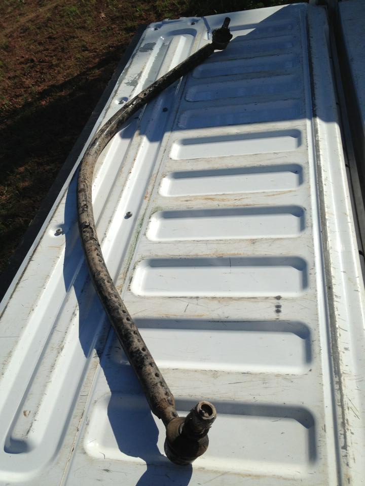

Was out clearing some trees with the TN yesterday. And got a little reminder that tractors are not built like dozers.
Four wheel drive and a hard push with good traction will break stuff. She hopped once and before I had a chance to get on the clutch she was done. Luckily in my case the repair is not that expensive. About 250 for the parts and I should have them on tuesday.
This is the culprit.
Save yourselves a little money and learn from my mistakes! The worst part is though you cant see it in this pic, there is a high track D5H sitting about 50 feet from the tractor. I was just trying to save a few bucks in dozer time by taking out the smaller trees with the tractor. Worked well till I wrecked the tie rod.

I did cut the ends off and make a new one out of square stock today to get me though. It ain't pretty but its probably stronger than what was in there. The ends aren't in that great of shape though anyhow so I'm still gonna replace the whole unit.
I will say when I looked down and saw the tires like that my guts dropped until I realized it was only a bent tie rod. I thought I was gonna have major carnage the way they were sitting. Set out bales with it tonight though and all seems well.

Did you hit something with the tie rod, or did extreme traction from the front wheels pivot them toward the center, bending the rod?

In this case it was all about traction. I had it in B1 so I had a good bit of torque and it decided to start hopping. I just didn't get on the clutch fast enough. If it wouldn't have hopped I probably would have been fine.

You could have just straightened the original and got by til the new one came in. I honestly would have hooked a chain from the bucket to the tie rod and pulled the bend right out. They are mild steel.

I thought of that option as well, but they way it was bent and hung behind the diff wouldn't make that option practical. Took about an hour to fab the new temp replacement one with a chunk of heavy wall square tubing that I had in the scrap pile and its working for now. New one should be in tuesday anyway so I will just replace it all then. Needed it for setting out hay for the animals and unloading trailers (hay season is in full swing for me right now).

I bent the tie rod on my old B7500 by catching one wheel over a big chunk of concrete and reversed. It put a nice bend in it about like that one.. I took it off and beat it straight on a piece of railroad iron.. I used it several more years. Of course it is a much smaller tractor, and the tie rod was a lot smaller.

Just be careful until you can get the original one back on. When you replace the weakest link with something stronger then next weakest link will bend or break. It could be a lot more expensive to repair.

Understood, that leaves the bucket option out. But a chain to a tree works well also:laughing:
