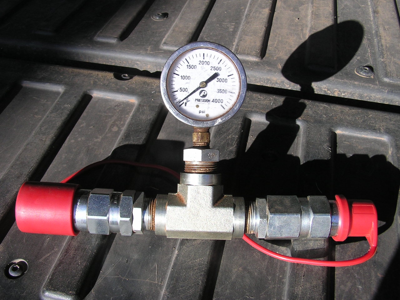

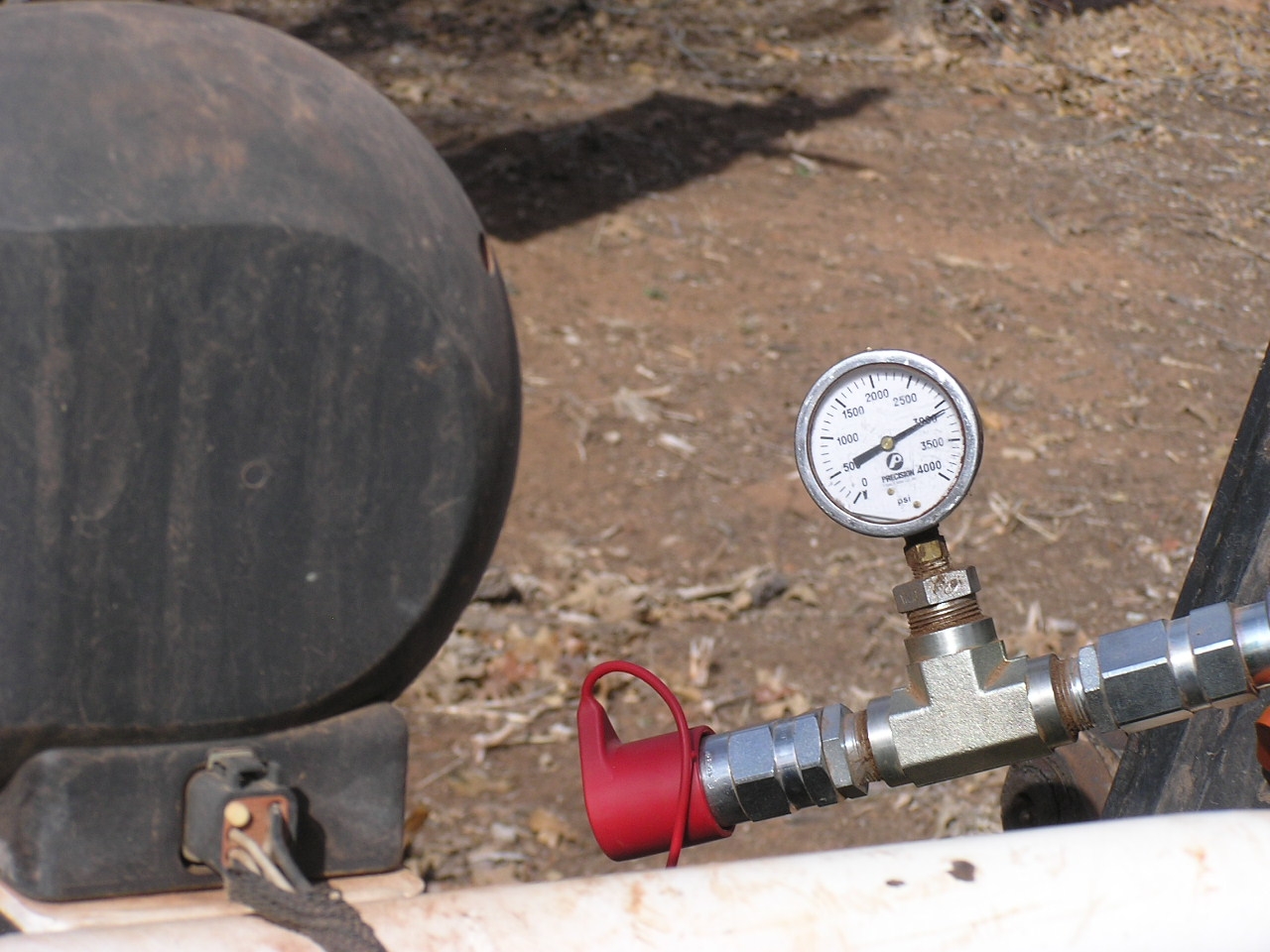

I bought a pressure gauge, hydraulic tee and connectors so I could check the aux pressure on my V417 Versahandler.
For your tractor a 3000 pound gauge would work best on the input to the loader from the pump. Connect it so the flow is through the tee to the loader.
View from the seat:
