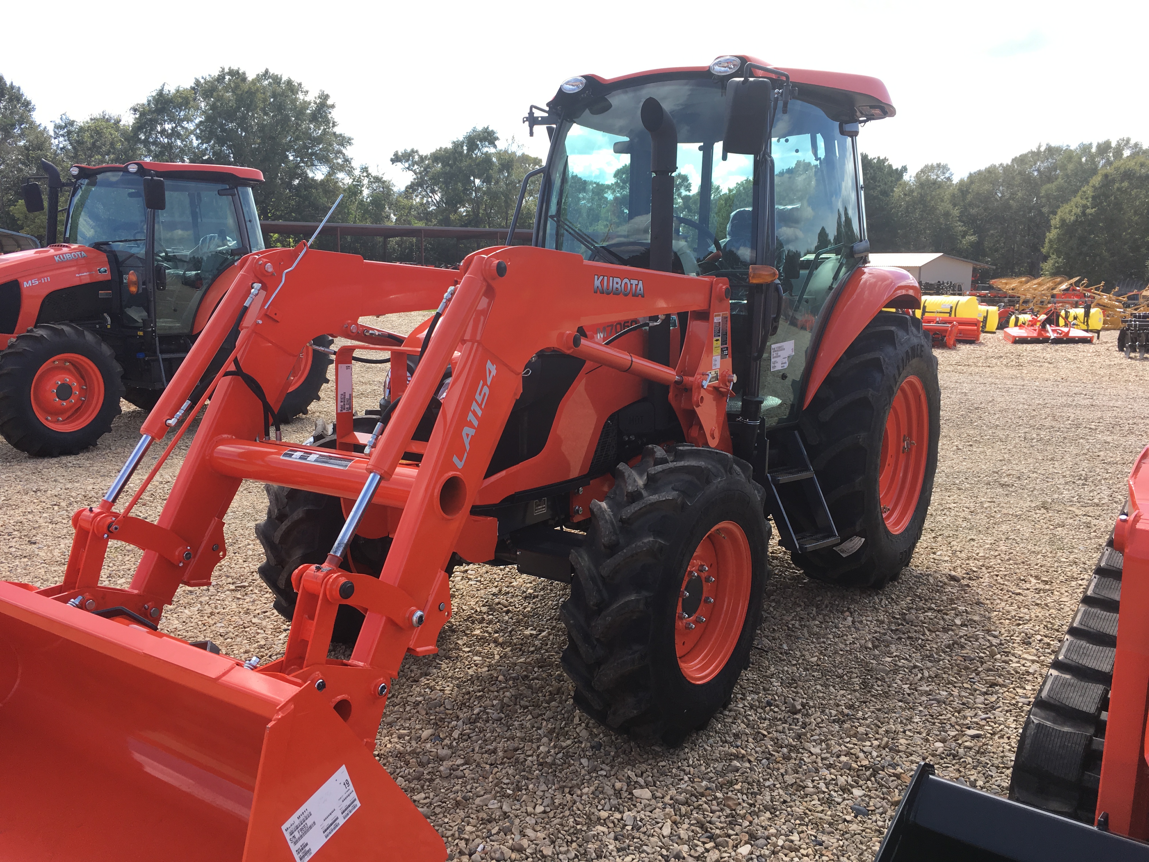

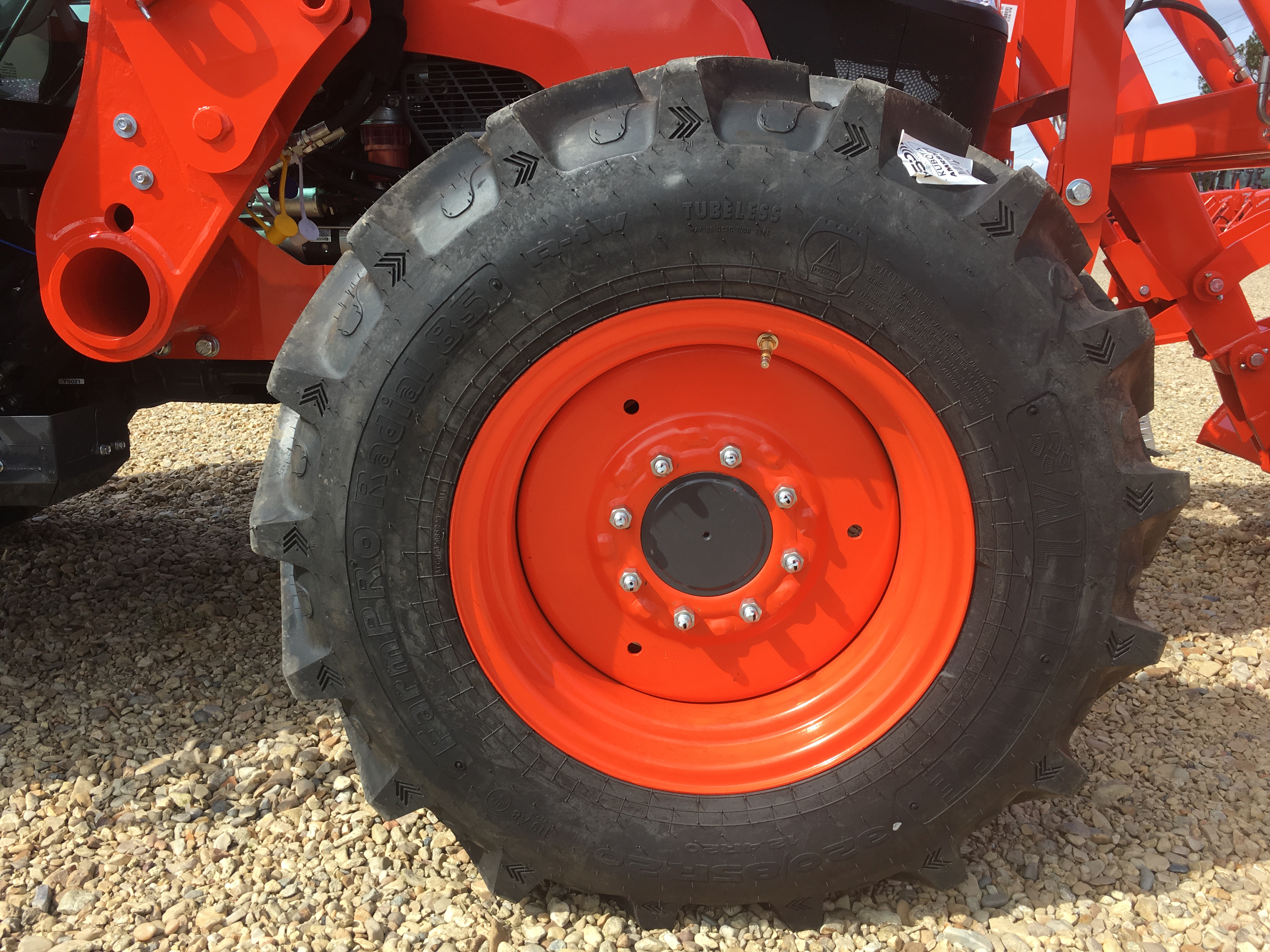

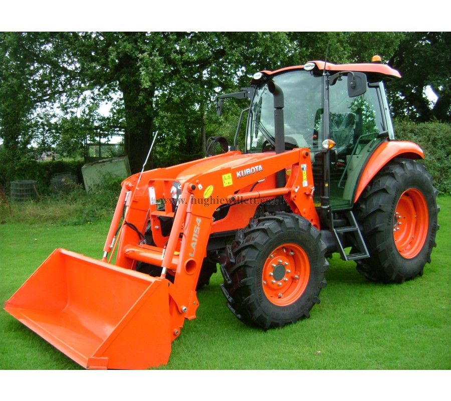

I have a new M7060 due to be delivered this week. I upgraded to radial tires which will get the wider front tires. They do not show as an option in the USA but my dealer was able to get them.
Mine should look like this:
Do you have anymore information about those front tires?
