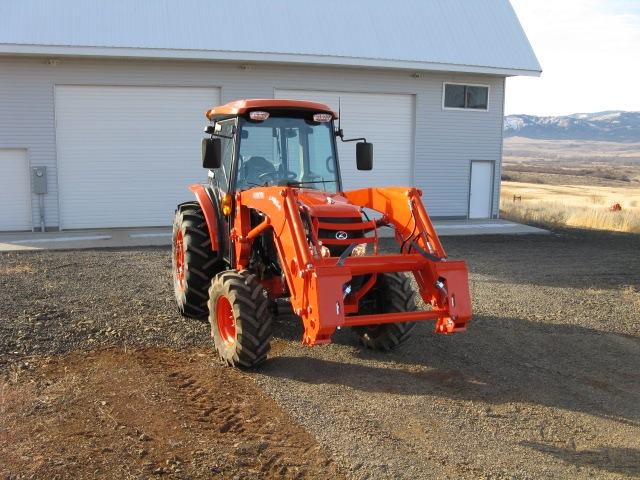

These are the R1 pattern with R4 sidewalls; Michellin XM27's
25 mph 20 mph 05 mph PSI
1,710 lbs 1,830 lbs 2,500 lbs 14 psi
1,940 lbs 2,070 lbs 2,790 lbs 17 psi
2,160 lbs 2,330 lbs 3,080 lbs 20 psi
2,390 lbs 2,570 lbs 3,370 lbs 23 psi
2,620 lbs 2,810 lbs 3,660 lbs 26 psi
2,850 lbs 3,050 lbs 3,950 lbs 29 psi
3,080 lbs 3,310 lbs 4,230 lbs 32 psi
3,310 lbs 3,550 lbs 4,530 lbs 35 psi

Thanks, RFB, for the tire specs. I knew nothing about them, and that's very useful info that I'll copy and keep handy.
