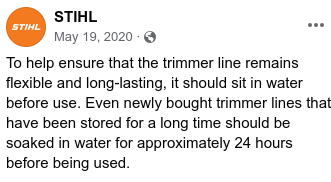

Some years ago I had a salesman* tell me that nylon absorbs some water and wetting or soaking string before use makes it last longer. Going to larger string always helps it last longer. If you're not working against buildings or something you hope to not damage, I'd go much larger than 95.
* complete BS?

I’ve read keeping it wet helps also. I think it’s on Stihl website. At the Stihl dealer they said put a little water in a zip lock bag and seal the string in it. The old string I just threw out I soaked in water overnight and it didn’t help.

I saw this mentioned a few messages up and I was like "pfff right" but reading further on the 'net apparently the nylon the trimmer line is made of is a hygroscopic material (absorbs water from the air or liquid) and it helps keep it plastic.
Given that my tool shed gets very hot in the summer, and dry, this is going to be a game-changer for us here; I think I'll get a bucket with a lid, put water in the bottom + a brick, and keep the spool of trimmer line on top of it.

I did read up on nylon and see it does indeed absorb a micro amount of water. Nonetheless, when we are whacking our way through whatever weeds-n-shoots, green juice gets flung everywhere. So trying to keep them wet in advance was not worth the hassle so we don't do it.
