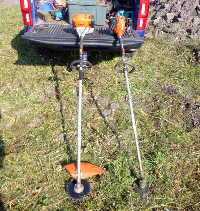

We use both Echo and Stihl powerheads at the time so here is a side-by-side comparison of the two. Both are good units, just a bit different..
Echo powerhead is lighter in weight, easier to pull start.
Bad is the bottom is so rounded, it readily rolls when you set it down,
slightly less powerful than the Stihl.
Attachment connection is rather poor.
No cold weather air intake.
Choke is manual and because of its location is occasionally turned on.
Sthil powerhead is slightly heavier in weight but more powerful and its pull starter takes more energy to actuate.
Good part is the machine control setup is superior.
Has cool weather air intake and has an automatic choke like their saws have.
Tool connection is far superior.

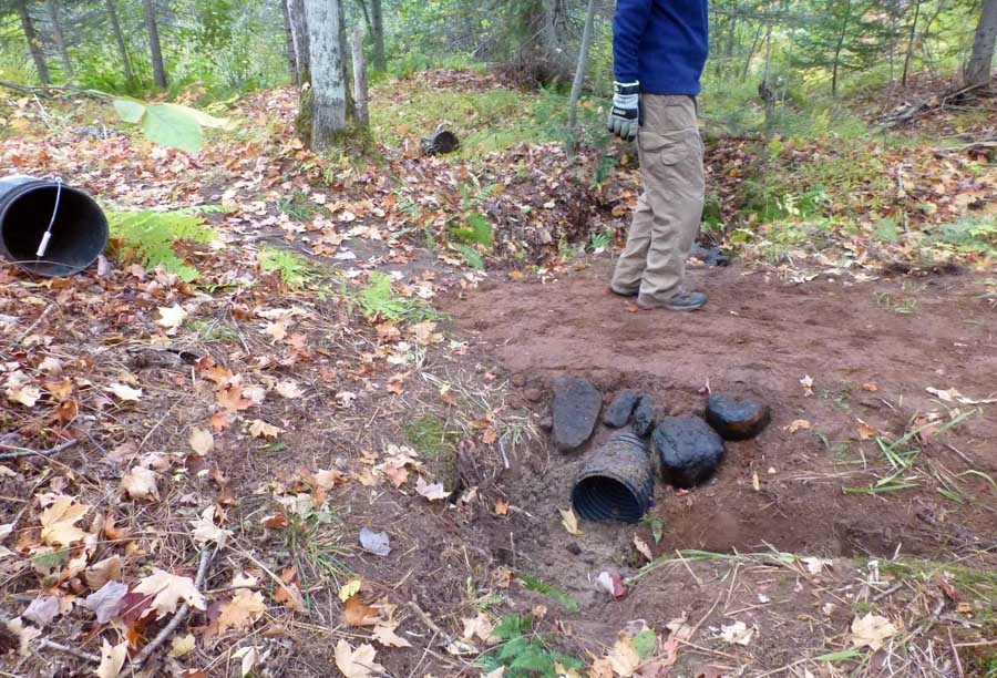

That culvert was likely the last trail work we'll do for Boundary Road trails that we've been caring for over the past 7 or 8 years. We can't afford to do it on our own. Not sure if we'll groom it this winter or not.
