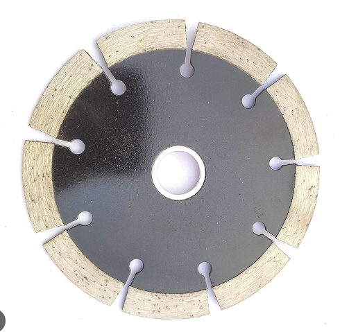

Chainsaw cutter style blade is easier to resharpen, but be cautious of buying one that is too heavy for your power head. Won't spin up as fast. Harder on the saw. This is what I bought most recently that seems to not be too heavy. https://www.amazon.com/gp/product/B07Y32ZM58/ref=ppx_yo_dt_b_search_asin_title?ie=UTF8&psc=1
These chainsaw style blades are effective, but throw debris so an arborist style helmet with face shield is recommended.
Those are great on thicker stuff, but I found it got bound up by Stiltgrass (tall and thin).
Does this particular one do well in tall grass?
The worst with the saw blades are when they throw the thorns like darts...

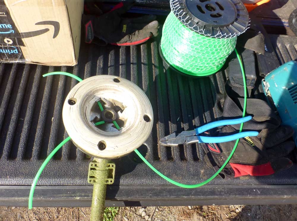

Just to be clear, .095 string is good for your house and garden but not worth taking into the woods. We are waiting for the 170 heads to arrive but still have a roll of .155 to use up.

THe string works great for grass and smaller weeds. If you need to remove tougher stuff, you really need a metal blade.

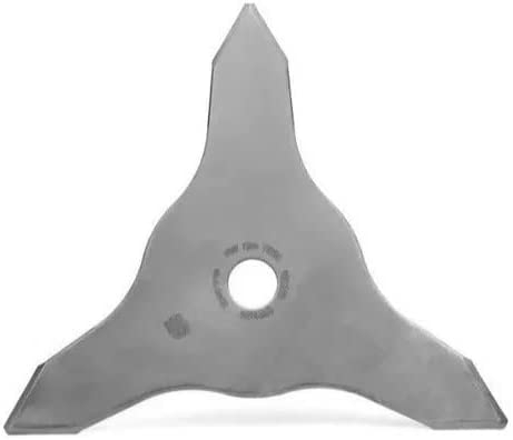

Fore stuff that is to heavy for string, but which wraps up around the saw blade styles, I use one of the 3 pointed metal blades. It works pretty well from grass up to seedlings and small saplings.
   / trail clearing technique and tools #840
I tried one of those, after about 15 min I threw it out.
The blackberry vines and autumn olive saplings would slow that down too much to be useful. I have a pretty tight mix of tall grass and saplings, and have seen these work great for others, but not here.
