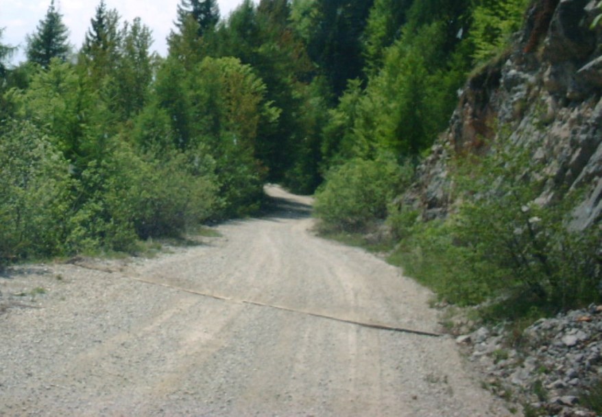

When we visited in Italy, we noticed how they handle the issue in their parks. They run a pair of timbers (like railroad ties) diagonally across the trail. They leave about a 2" space between them and are buried so that you can drive across them. The water crosses the path through the space. I need to find our pictures to see if I photographed them.
   / Trail Maintenance #12
The Romans built the first aqueducts, so they would know.:thumbsup:
   / Trail Maintenance #13
Here's a picture from our Italy trip in 2002. Being a city boy, I had no idea that we'd be living the life we are now. If I would have known, I would have gotten a better shot. It shows the wooden drain going across and downhill on the trail. Our friend who lives there said they use that idea quite a bit and it works well.
