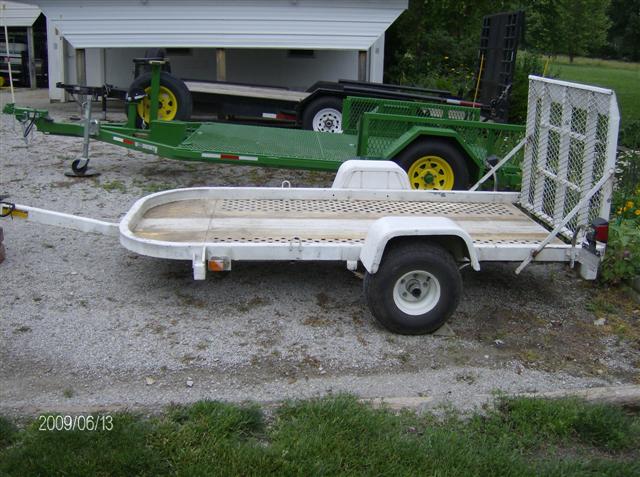

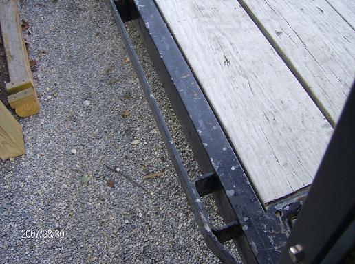

I prefer no "side rails" on my trailers!
But "rub rails" along the edge of the trailer makes finding the right tie-down point easy. ~~ grnspot110

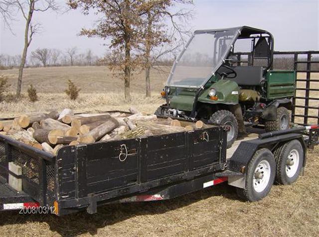

That's what sideboards are for! I do have full sideboards for this trailer, just use the front ones frequently. Slated sides for my green one, aluminum ramp sides for the little Snowco. ~~ grnspot110
