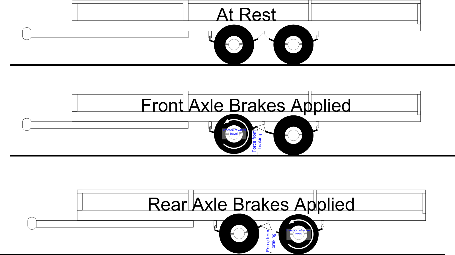

I'm mentally going through the free-body diagram of the axles under braking forces, and I see where Dexter and Alko get their answer.
The front axle spring is fixed at the front of the spring. This is the pivot point for the spring; the spring can move up or down as well as laterally at the rear of the spring. When that axle brakes, the friction between the tire and the road exerts a torque on the axle, from both the direct braking torque and the torque that comes from the force of the tire on the road multiplied by the perpendicular distance from that force to the pivot point. Both of these torques make the axle tend to pivot...upwards off the ground.
The reverse is true on the rear axle. The torque acts in the same relative direction as the torque on the front axle, but the spring is fixed on the rear and free to move upwards or down at the forward end of the spring. The axle will be force downward. If the equalizer didn't stop the spring, in fact the axle could even ride under the spring pivot point and flip....

I agree with you on the not all loads needing brakes, but I disagree on the importance of different equalizers (as long as the front and back arms are the same length), as I understand it (and someone correct me if I missed something) if a trailer has dual axles with leaf springs and an equalizer between them, the weight on both axles will the the same when the trailer is loaded and stopped, if there is more weight on the front the front axle will be pushed down more than the back, this will cause the front spring to push up on the front of the equalizer which will push down on the back of the equalizer, causing the back spring (and by extension the back axle) to take an equal share of the weight, this continues until you run out of travel on the equalizer at which point the load becomes unbalanced.
Attached is a diagram of a dual axle trailer at rest, with front brakes applied and with rear brakes applied, it shows the forces applied to the equalizer and the result of said forces.

Can you perhaps use those same drawings for dual axle with brakes on all wheels, and explain which axle will cause the brakes to grab and lock, and why? My thoughts have been that the equalizers serve to equalize or compensate for irregular surfaces, such as a pot hole or a rock or bump, etc. In the normal trailer situation, the front axle already has more weighI on it due to the 10% tongue weight, and I am thinking that the load shifts fwd, even more in a braking situation. How much weight is shifted to the back axle is up to conjecture. No one seems to know. It would be neat to see a trailer being pulled down the road with a video camera looking at the wheels and springs to actually see what happens to the wheels, when a hard braking situation occurs, and which set of brakes will lock up.
The question might be is. if the equalizers are designed to equalize the load on the frame, do they also equalizer the braking force on the axles. Some people say some grab, and others say never.

Ok - from this picture, it would explain the front axel lockup esp when its unladen and said trailer has WD bars installed. The rear axel is the same height as front so when the braking force is applied, it appears the front rotates and LIFTS the front axel up just a hair and it would seem it locks up due to the fact there is less pressure on the road. Now this doesnt seem to happen when loaded. perhaps there should have been some sort of a cutoff switch to ONE of the axels brakes so its doesnt seem to lock up when its in unladen mode. Why do you think some manufacters put brakes up front? 80/20 weight rule and the torsion of the equalizer ? ( looks like we gonna argue on this till we are blue in the face.:rolleyes:)
