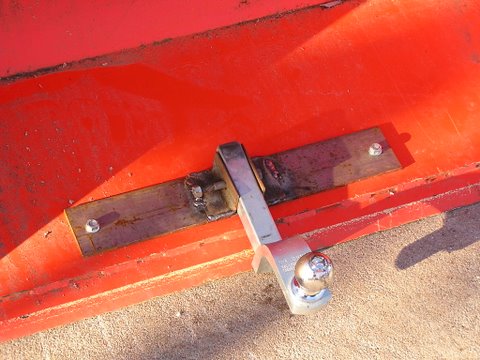

I needed to move some empty trailers (and my light sailboat), so I built this. I already had the hitch. Having it set like this, I can curl the bucket and see the ball over the top of the bucket, so hookup is easy without leaving the seat.
When I take the hitch out, the base doesn't hinder dirt work.
Enjoy.
ron

cobbkevin said:
Bird, I thought about the bucket but I have a hard enough time 'guessing' where my lip is so if I put a ball there it would require way too many off the seat peaks to line up a trailer :eek:
Kevin
You dont put it on the lip-BAD NEWS. The hole would weaken the cutting edge and lead to prompt failure. You reinforce the top edge and put it there.
larry
