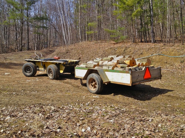

I've been through several trailers behind my tractor. The one I used for years was a home-built by my neighbor. The bed is just under 5' wide and about 8 1/2' long. He made it from an old mobile home axle and some left over steel. It had a 2" ball on it at one point, but now has a tractor-style pin hitch. Usually, I pull it from the logging winch on my 3 PT hitch (the winch has been modified with a receiver hitch. I just put in an insert without a ball mounted on it and hook the pin hitch to that. Occasionally, I'll put one of those draw-bars that mounts between the lower 3 Pt hitch arms to tow it. It was inexpensive (he gave it to me) and will carry 1/2 cord of green Beech or or Oak without a problem (shown here behind my Coot. That load is really too much for the Coot, but the trailer has no problem.) It has some decent size wheels on it, which have proven useful in the woods. If the sides ever need to be replaced, I'll probably go about 6" higher than what is shown here. Overall width is about 6'. This works out OK on most of my trails, but is wider than my tractor, so not really ideal for working in tight quarter in my woods.

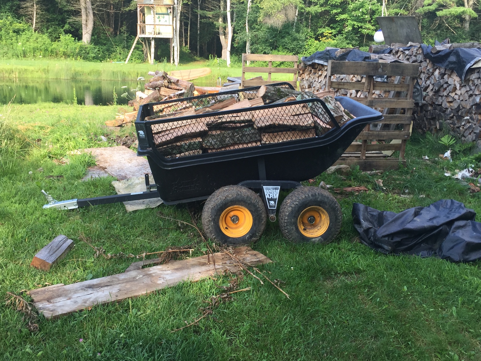

I also own a Polar model 8262. Manual dump (works surprisingly well, 1500# capacity, walking arm suspension. I added the optional extended sides. It's a nice for use behind an ATV/UTV (I bought it to use with my Coot), but much too small to be practical behind my 33 HP tractor. I do occasionally use it as a tool hauler, or when my other options are full. The pin hitch on the trailer would not fit the tractor's built-in drawbar, so I towed it similarly to what is mentioned for the home-built trailer above. This trailer has since been converted to a 2" ball hitch. Generally I don't recommend this for anything larger than a subcompact.

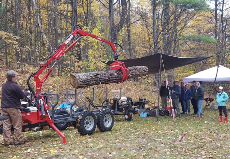

Log forwarding trailer - Hard to justify the expense of one of these just for personal use. There is a huge jump in price from the typical ATV-sized ones to something more suited for use behind a tractor. This one is a Metavic M95. I found it for sale used - in like new condition, from a guy a couple of hours down the road from me.

Now THAT Polar trailer is on nice little trailer. Ideal for 'round-the-farm' use. But, for $700, I probably won't be buying one. I'll just have to continue using my old Snowco snowmobile trailer. Thanks for your post though - very informative.
