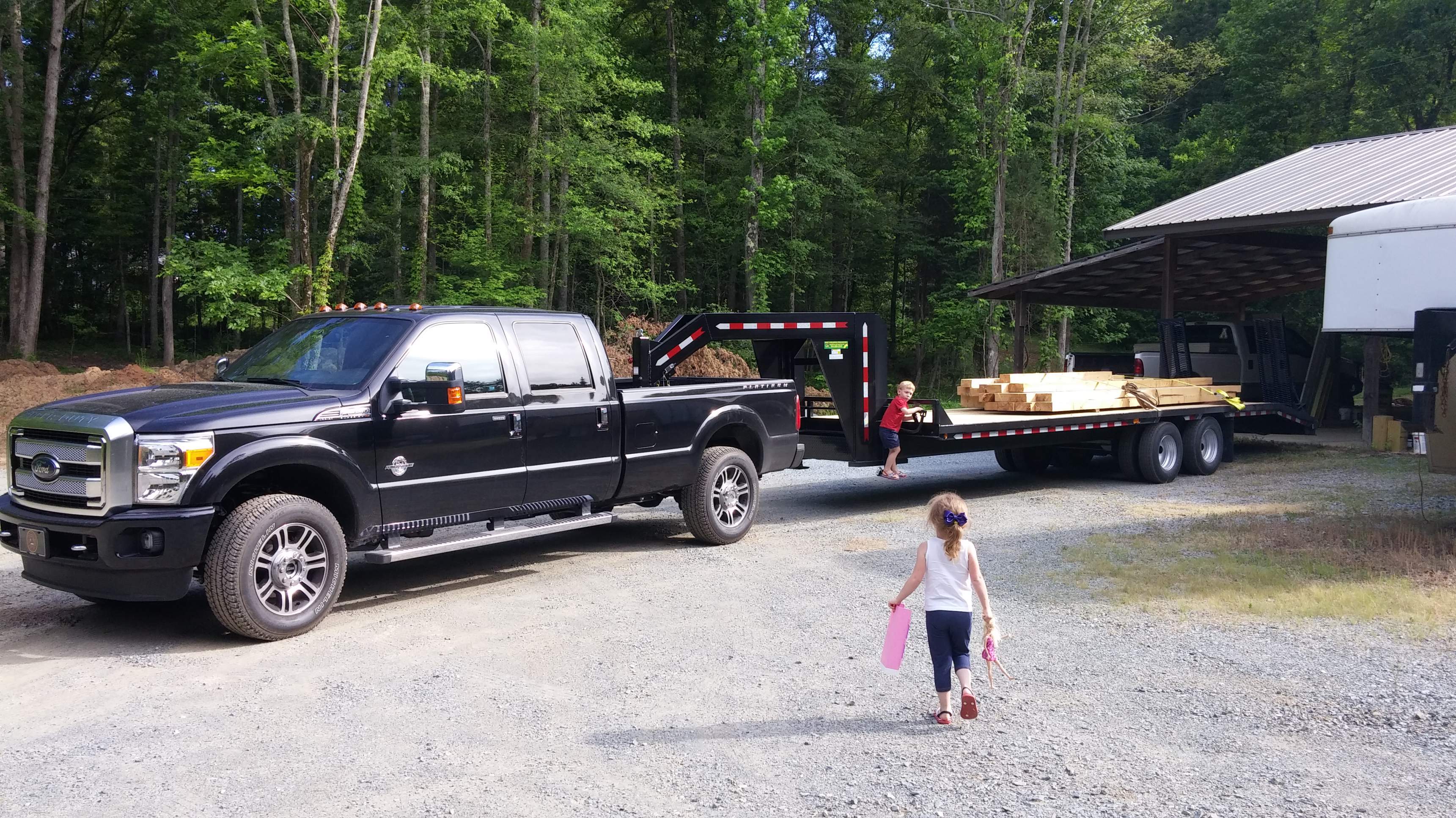

To check amperage, do I need to cut a wire and put the meter in the path? Haven't done anything like that since college and that has been a few. I think I need to send the P3 back to Tekonsha. I can put my foot on the brake and the voltage will go up to 3 then back to 0 and start climbing again. Can make for a little pucker factor.
Day I picked the trailer up and got it home.
