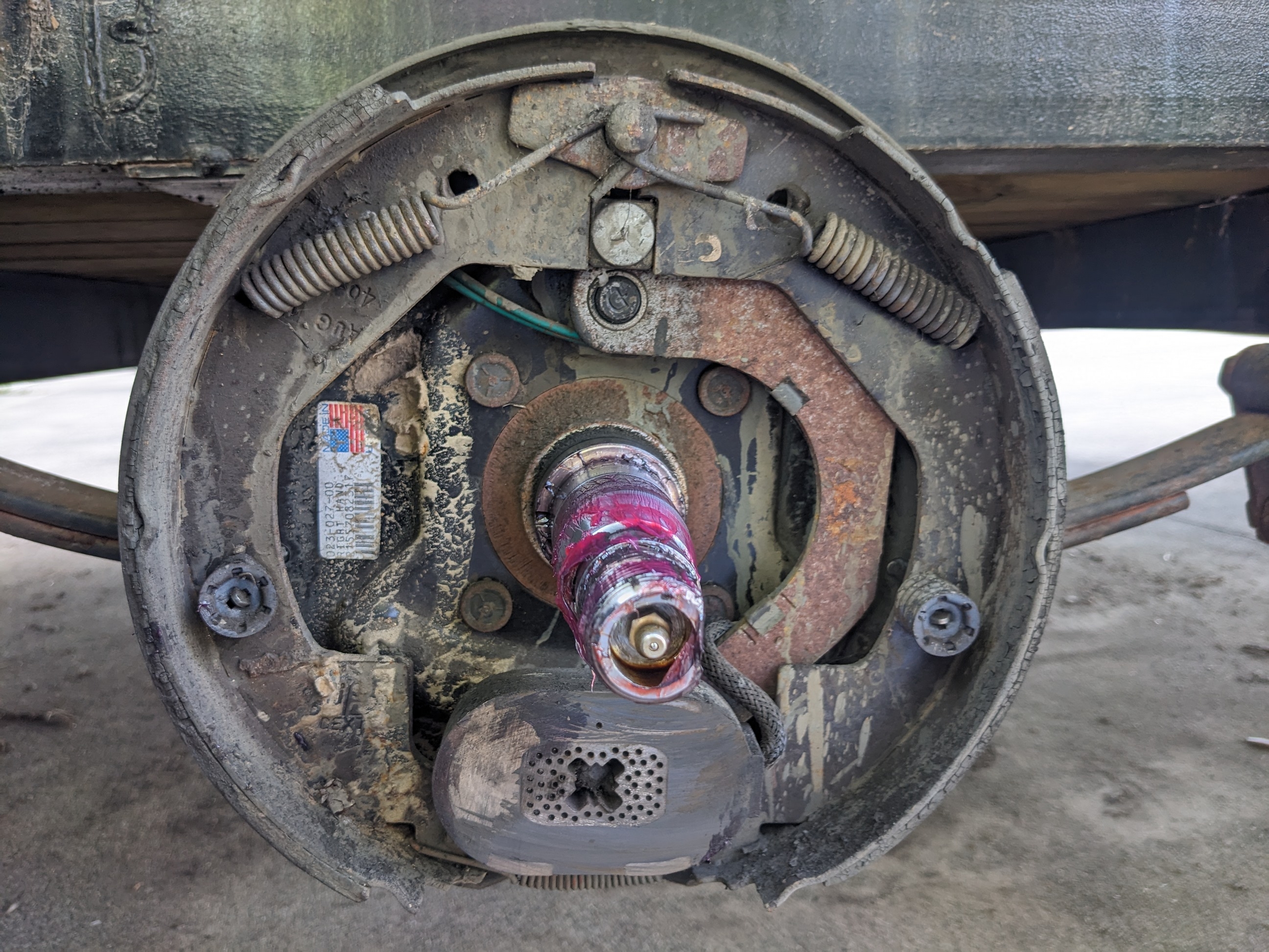

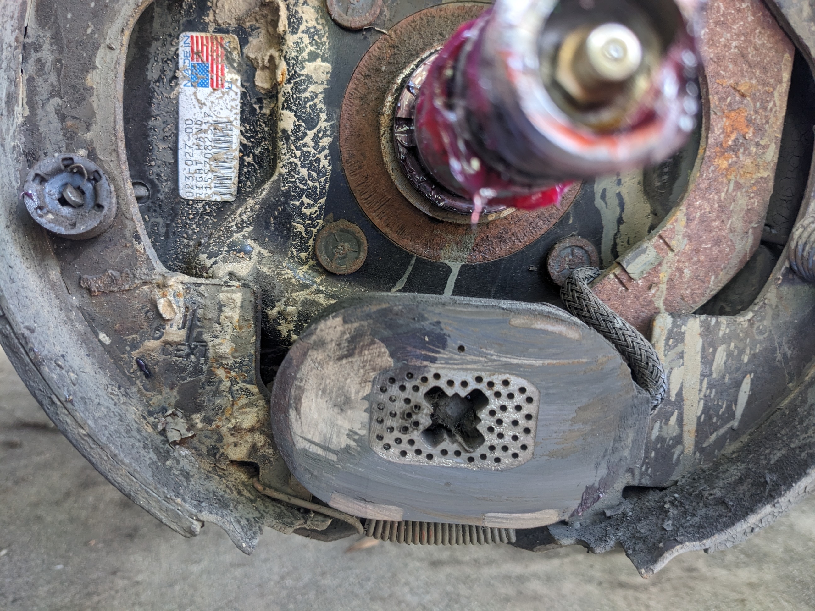

Thank you ! I realized later that this thread is over TEN YEARS old, so I was wondering if I'd get any response. Lol!
Anyway, I pulled the drum on both sides and my left wheel (hotter side) shows the magnet rubbing more than the right side. Is this normal?
I also backed off on the axle nut a little, but couldn't do much without getting some play so I don't think it was too tight...
Went for another test drive and it's still getting hotter than the other side, without a load on the trailer...
I have questions about the P3 controller, but I'll search first...
Thanks in advance for any input!

Assuming mechanical is good (adjusters adjust, everything else is reasonable clean and moving freely), check electrical next.
You need to make sure the cold side (right) is getting adequate voltage, and the magnet is functioning.
Axle on jackstands, drums and wheels on, brakes adjusted so shoes are close to the drum, then get someone to apply the brakes while you turn the wheels. If the cold-side doesn't lock-up the way the hot side does, then you may have a wiring issue, or a weak or even open-circuit magnet. Check any inline splices for corrosion or loose wires.
Easy to add to somebody-else's To Do List :cool: ..... if you haven't already, once you are done with brakes, check the pivot bushings on the suspension spring shackles for wear. I ended up replacing all of mine (visible wear), when I overhauled my new to me travel trailer a # of years ago.
Rgds, D.

My buddy had the same problem as his trailer sets a lot anymore and called for advice. I told him to check the arm the magnet is attached to and see if it was hanging up. Sure enough, it had rusted from all that setting. It would hang up a little not completely releasing the brakes.
Pulled it off, cleaned it up and applied a little never seize, problem was solved.
