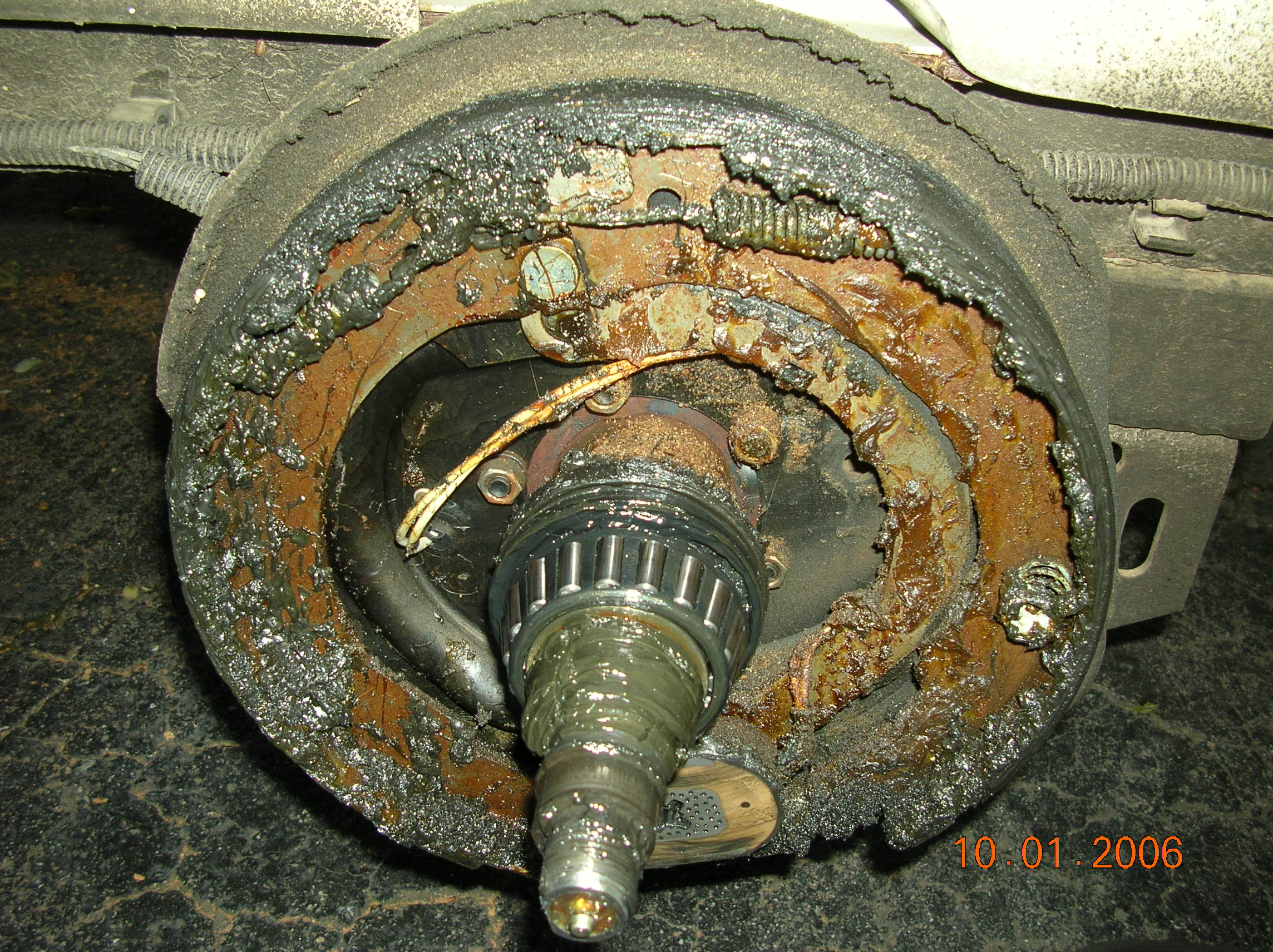

Does just lubing E-Z lube axles until new grease flows out count as repacking the bearings?
Some folks may have had good service from EZ-lube but this is what I got from previous owner.'

I bought a 20' Diamond C trailer last month. When I asked the dealer about lubing the EZ lube axles he said 'DON'T!!' He claims that lubing these axles forces grease past the seals and onto the brakes. He recommended a yearly teardown and re-pack of the bearings.
That's not happening. I have been lubing these types of axles with the grease gun for years with no ill effects. And in that time, I've probably towed five to ten thousand miles per year. In the future, I plan to jack up the wheel being lubed and spin it as I pump the grease. This should help the grease get through the bearings instead of through the seals.
Anyone every tear down their properly lubed axles and find grease all over the brakes?
Yes, all the time.
I do about 20 trailers a year. We find rear seal failures often.
I still use the ez lube feature a few times a year but a full tear down takes place every other year.

FYI, an ez-lube axle also lubes from the rear bearing to the front. The grease travels through the spindle to a hole between the inner bearing and seal... The better seal of the vortex is nice though...
If you spin them while pumping slowly, you won't have seal issues. If you feed them a lot of grease quickly, you may push out the seal.
