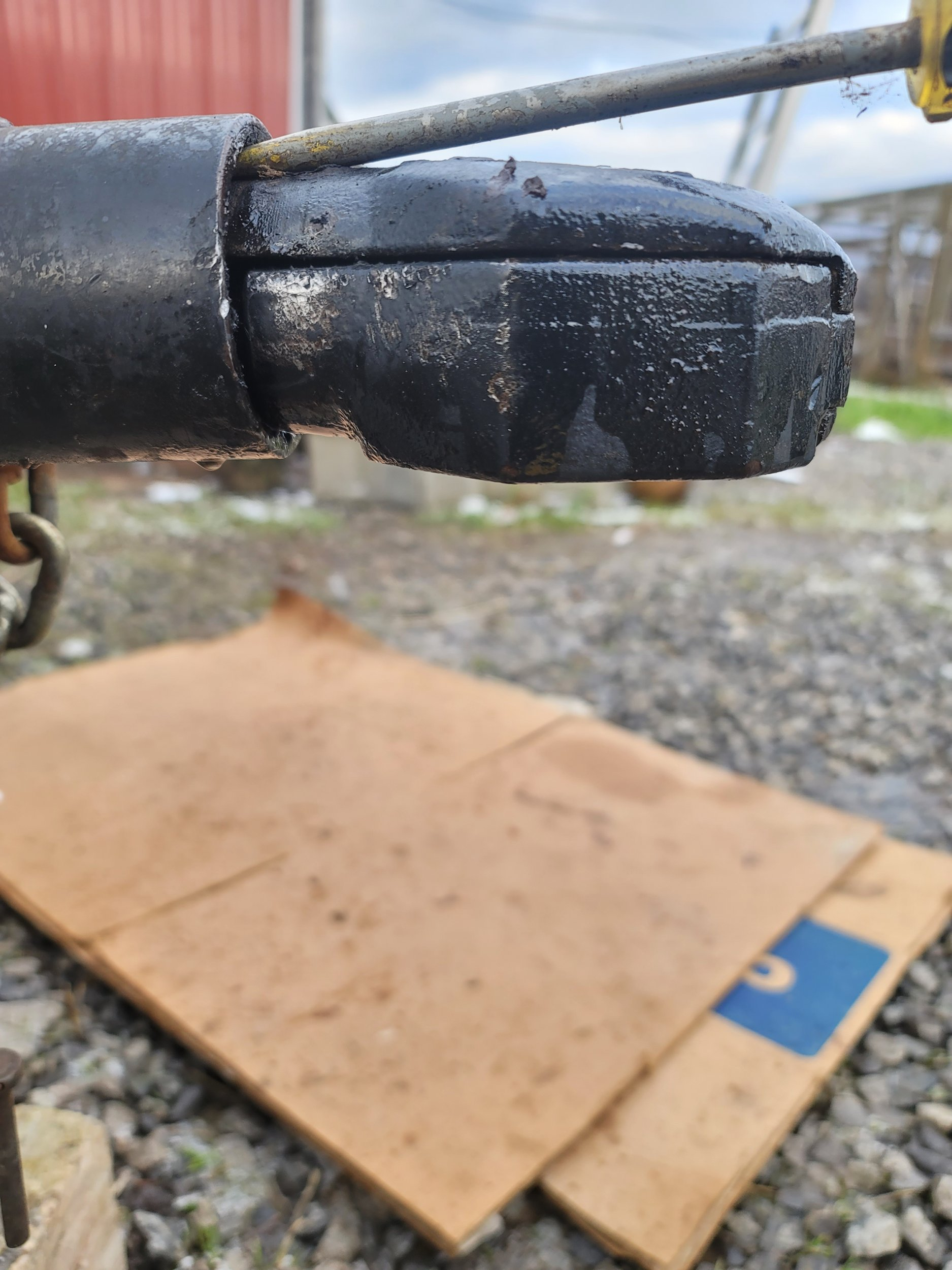

No difference with the oil. I've taken the spring out since it's not strong enough to open it. There's not much of a gap between the jaw and the top of the coupler...is there a way to remove this piece? I could clean it better and grind down the top of the jaw so there is some space to move...

Clean all the grease & schmutz off of it and paint it red or yellow whn pulled back. Then look for the paint scrapes when you get it in and out of coupling. Then grind the area where the paint tell-tale is.
Of course, the collar may be oblonged because of an over travel. Can you roll it around to check this ? If it's ok when parked and not attached, then suspect a ball or ball compartment problem.

My guess is your greater problem is disconnecting, rather than connecting. If that be the case, then be sure there is no tension between the tow vehicle and the trailer. A way to avoid that tension is:
Block the wheels of the trailer. If you have backed into the trailer's parking place, then move the tow vehicle forward every so slightly - like 1/4". If you have pulled forward into trailer's parking place, then back up ever so slightly - again, after blocking the wheels. Either way, you've released tension at the connection point of the ball and the coupler.
You should not have to bang, pry, beat on any hitch

Just a quick update. I got it moving. Needed a second set of hands to operate the torch and we heated up the end while I moved the jaw back and forth. Took a bit but then it just gave and went easy. It is now all greased up and ready to go.
   / Trailer Coupler issue, any tips or tricks? #16
Once you get it moving, I would get grease in there. I don't think penetrating oil is much of a lubricant.

Our sliding collar was sticking too. Made it easier to work the jaw back and forth when I first started messing with it. Then I hit it with WD40 along with the jaw and the collar worked great, hence the need for the screwdriver to hold the collar back...Overall, I prefer this style because it does feel more robust over other styles and its my first time really having an issue.
We normally grease the ball but stopped a few years ago for some reason. I think we will be back to greasing the ball and that should help with this style coupler.
