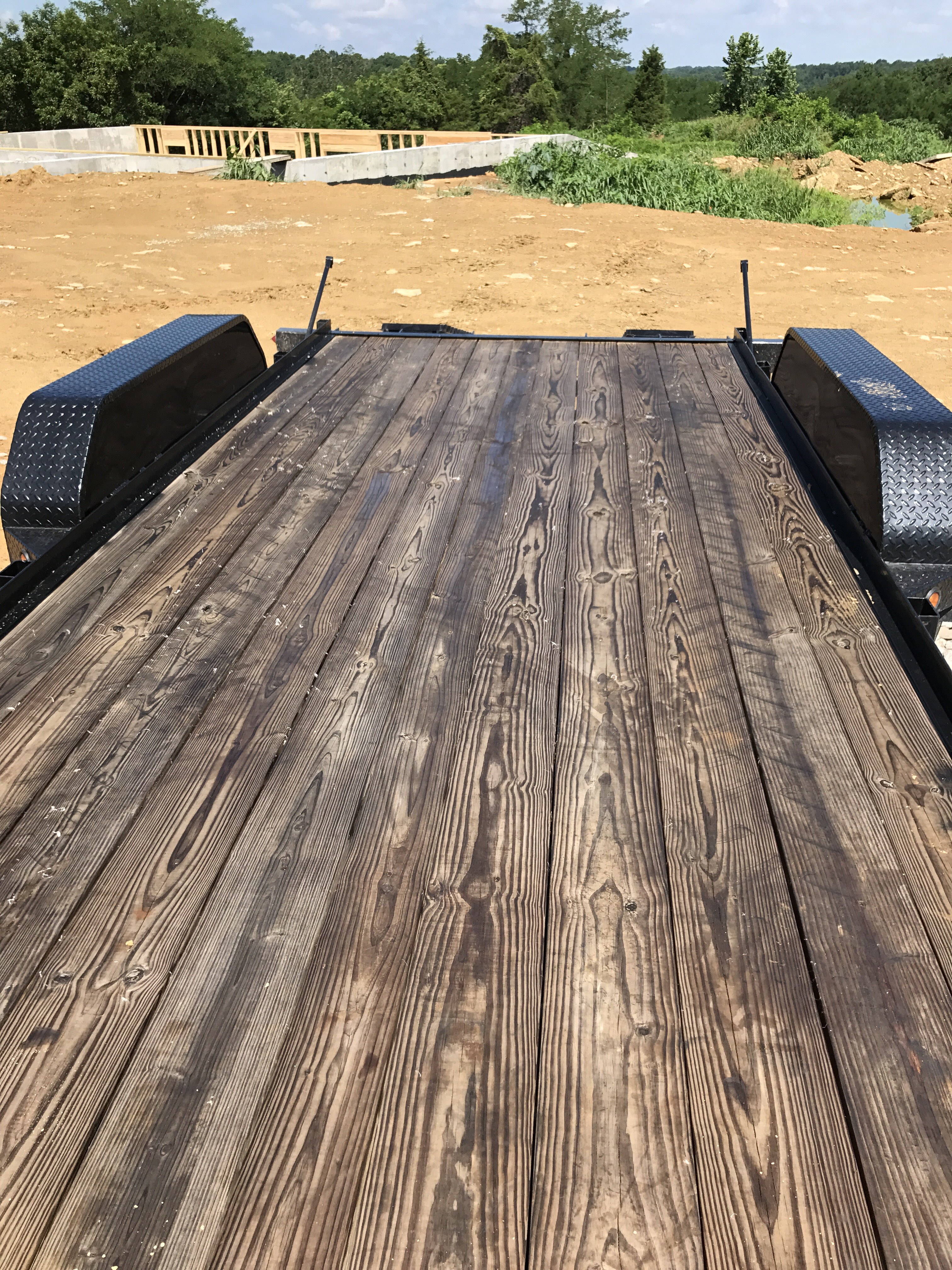

Here's what mine looks like using used motor oil from my last truck oil change. Best part it was free.

How may gallons does it take for a 8x25' trailer approx? I would probably consider new oil and diesel mixed just so it wouldn't be so messy when walked on, but it may not matter on most trailers.
   / Trailer Deck Finish #9
My trailer is 82" x 22' and I use almost 2 gallons of the 50/50 mix. I lay it on pretty heavy so it soaks in good.
