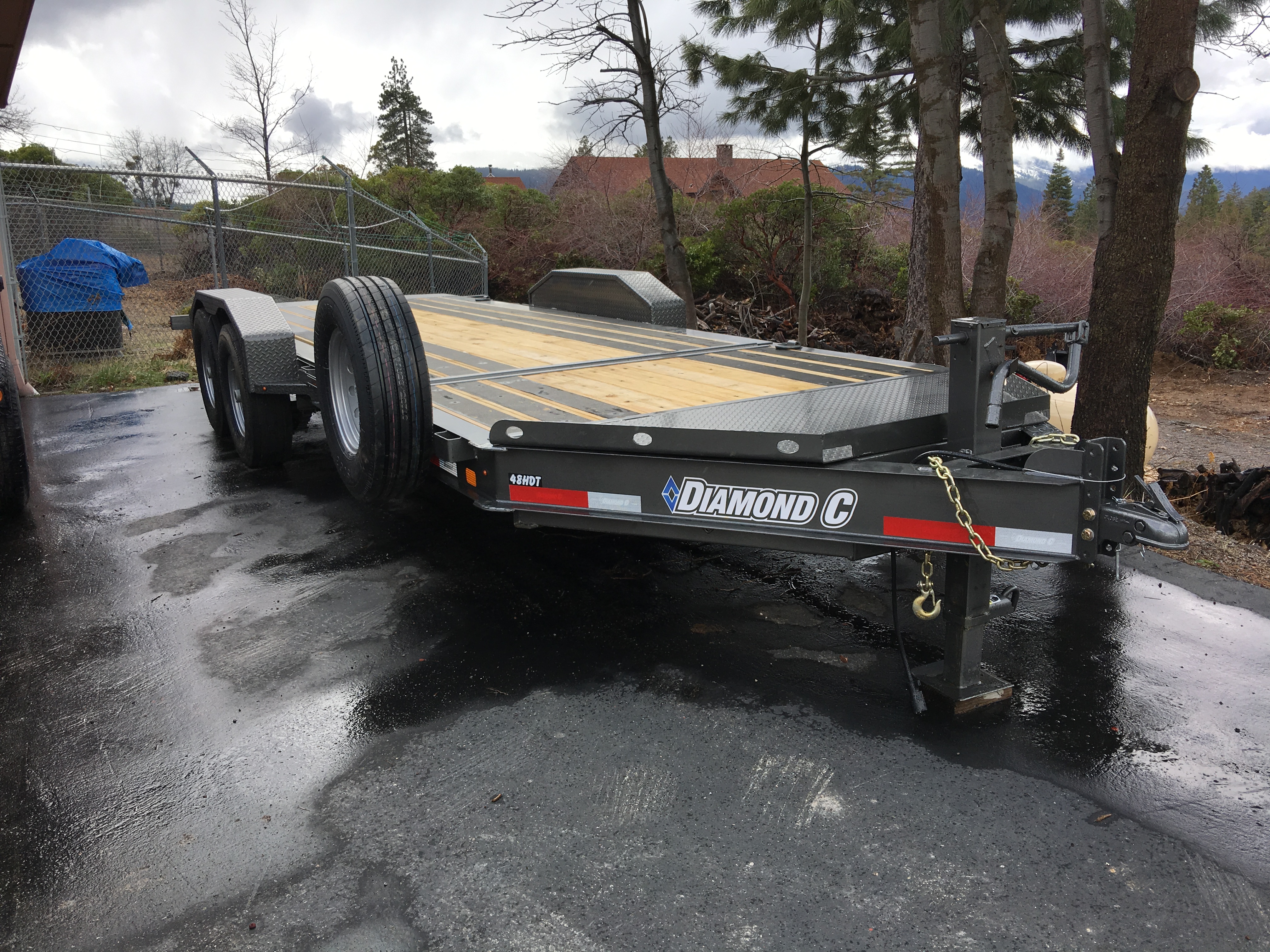

Might have to give that TWP a try. I need to do something to the deck on my newish trailer. Picked it up late this summer so have a little while to let it dry & age to hit that 1 year mark.
It's a deck over power tilting deck so I'm more concerned than normal about a slick deck. It ends up being pretty steep. If backing my tractor on I often need to put it in 4wd for traction or the rears just spin. The engine/hydraulic oil sounds a little to concerning about being slippery.
I'd consider some deck stain with some sand or grit mixed in for extra traction, but I hate the way it ends up peeling so quickly.
Any other recommendations?
