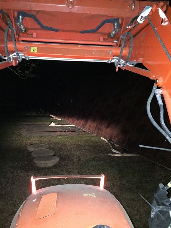

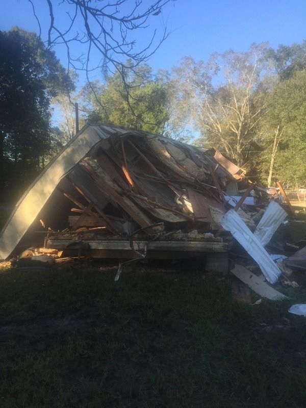

Just took my bucket and started pushing. Pushed all the walls on all four sides at bottom until only the inner non load bearing walls where holding everything up. Then raised bucket and started pushing at top until whole thing fell over. This was a 16x80 mobile home that already had problems but with the flooding in august the floor completely collapsed. It had to go, after the thing was pushed over I used my titan bolt on forks and brought the bulk of it to the road where lucky for me parish paid timber companies to come in with their trucks and haul off the flood debris. Surprisingly enough the bolt on forks and bucket combo did a excellent job until I got down to the last 20 percent or so. The pile was too light and I couldnt get it to stay on the forks without falling back off. I anticipated this and had a ea wicked grapple on order 54" dual lid. Used that to clean up the final debris. Had to use two plugs in the same front tire both times was my fault driving into the debris pile trying to load it higher. All debris had to be withing 10' of the road for the timber company to pick it up. Overall not bad most companies where charging 3k-5k for trailer demo after the flood so it paid for my grapple and tire doing it myself. I had 40 hrs into it overall but was taking my time going slow. I could have probably cut that in half if I was just picking at it a little here and there. Still have the frame and some odds and ends to scrap as well not sure how much I will get out of it but a scrapper came by asking for it and told me 300ish for the frame plus another 200 for the other odds in ends I saved (wire, duct work, cast iron pipe, etc..
/ Trailer demo #13
Believe it or not the last bucket full is what used to be the particle board floor thats not dirt.

Regardless how you do it, you are gonna have a mess. Best way to control that mess is as Greg said, by hand, piece at a time.
Attack it with a tractor and you'll be lucky to finish without a flat tire and you'll have debris everywhere.
Post pics, we like to watch destruction!!!! :)
