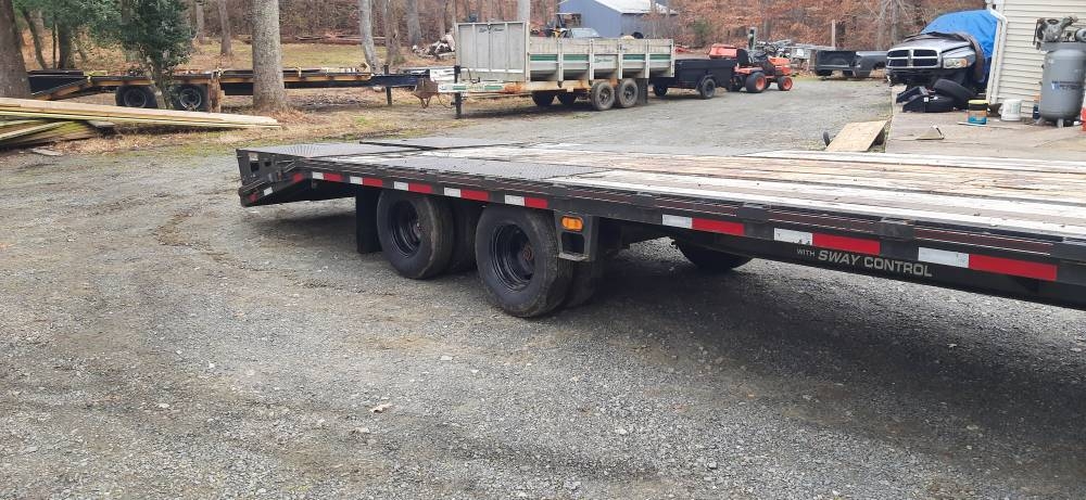

I would not convert to singles on a narrow frame trailer that has dually axles. You will loose axle/tire width. Some small manufactures used the same narrow frame for both singles and dually axles. I assume for ease of the build. I had one (16k) 102"x25' and didn't like it. With a narrow load it was fine but for a wide load, such as hay, it was not stable.
I sold it and bought a wide frame 16k Diamond C, 102"x28' with sway control pipe, way better trailer. I prefer singles over duals. Dual tires get you looked at by the cops.

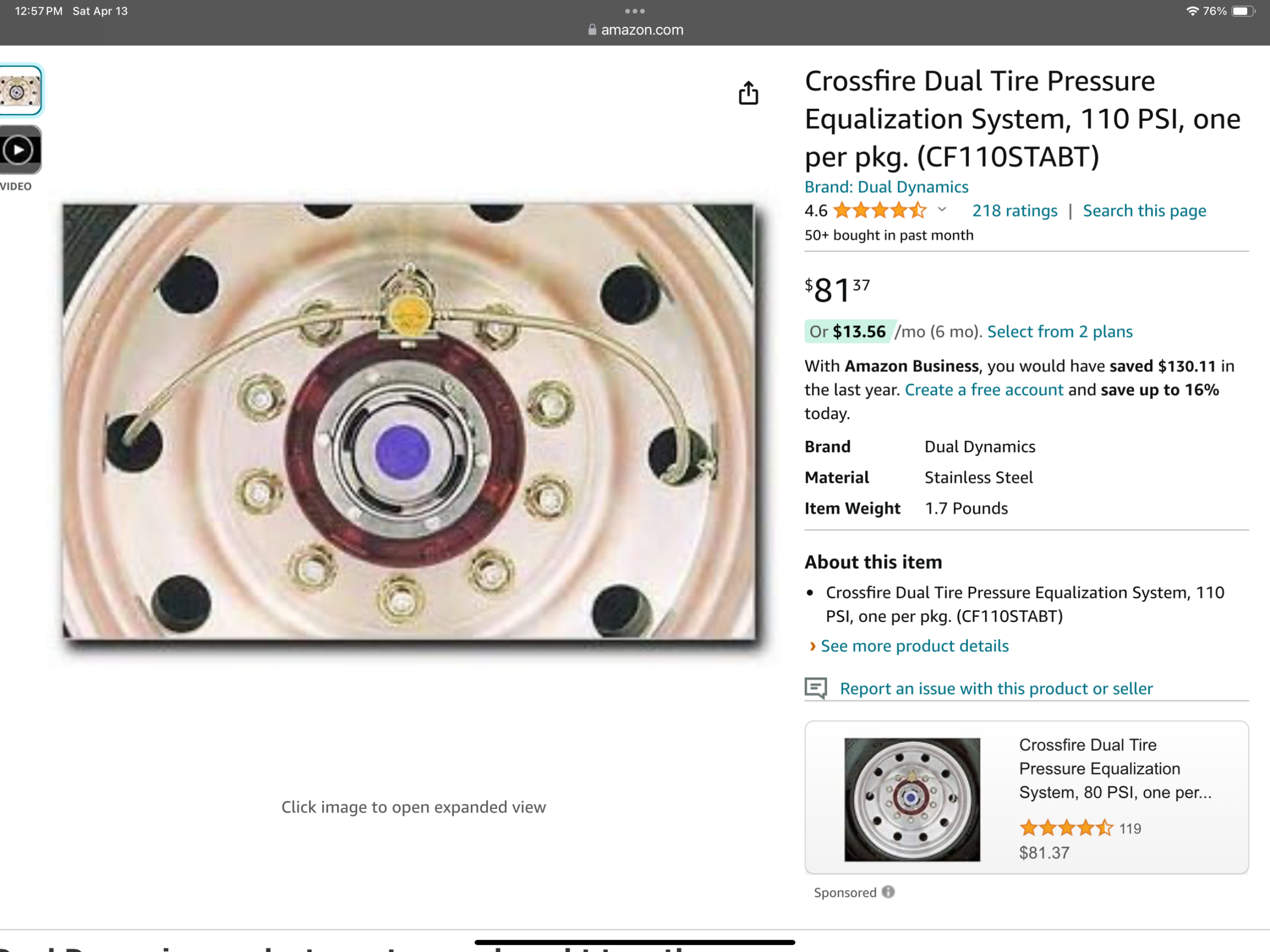

I have come close to ordering the Crossfires.
I just keep thinking they’ll get snagged on something or rip off.

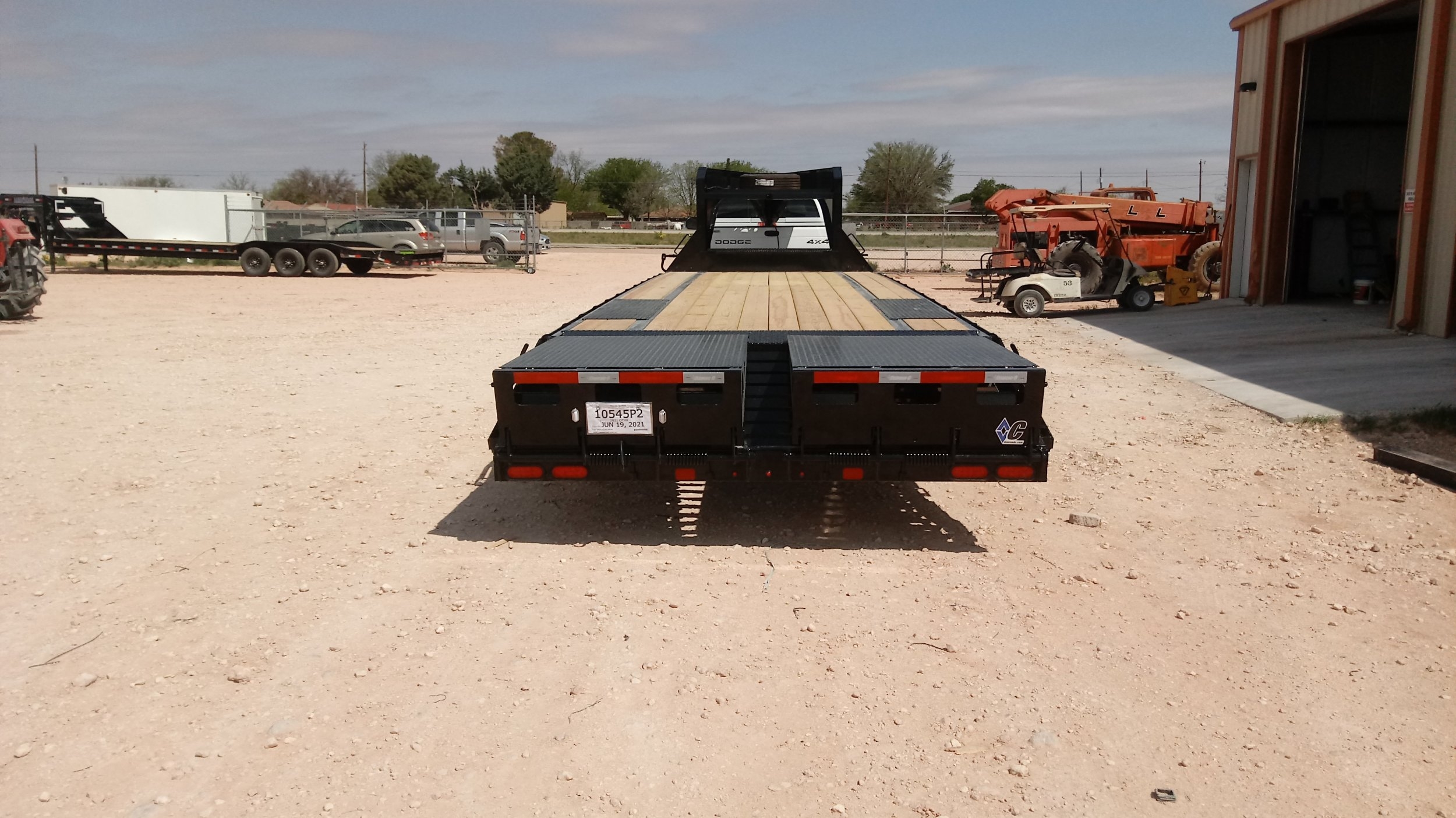

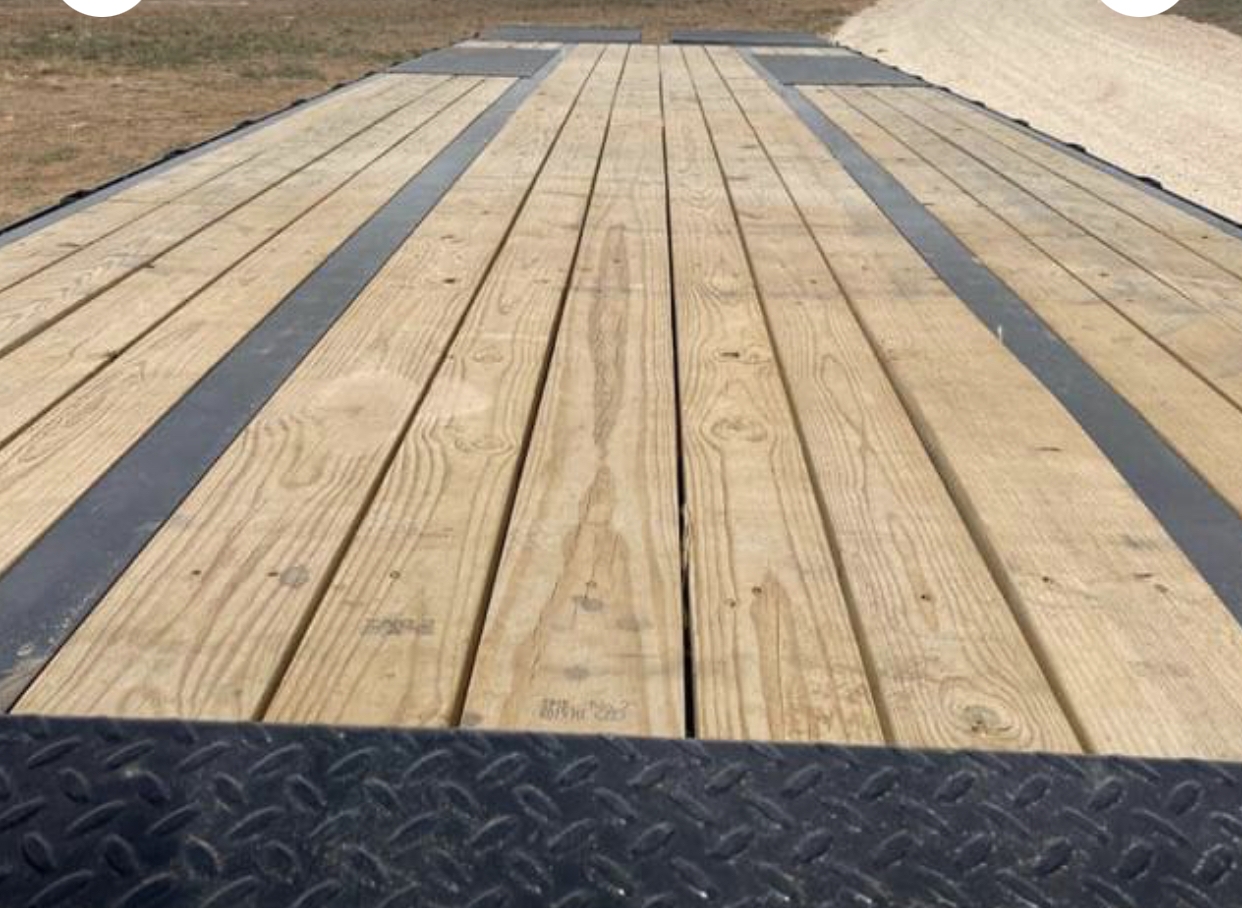

Wide frame with singles, note, two deck boards, outboard the frame.

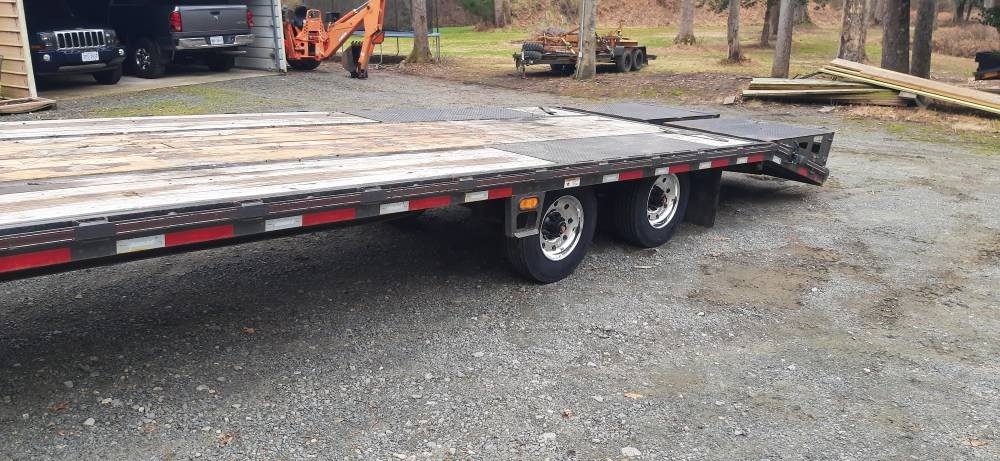

Narrow frame with duals, 4 deck boards outboard the frame.
