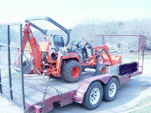

6x16 is about the min. for a trailer with tandem axles and brakes.
Just recently hauled mine about 150 miles round trip. No problems or worries.
Here is how I chained it down.
   / Trailer for a BX 24 #15
That looks pretty good. I like to tie down in an X pattern, I've found it removes the possibility of the load shifting during transport.
