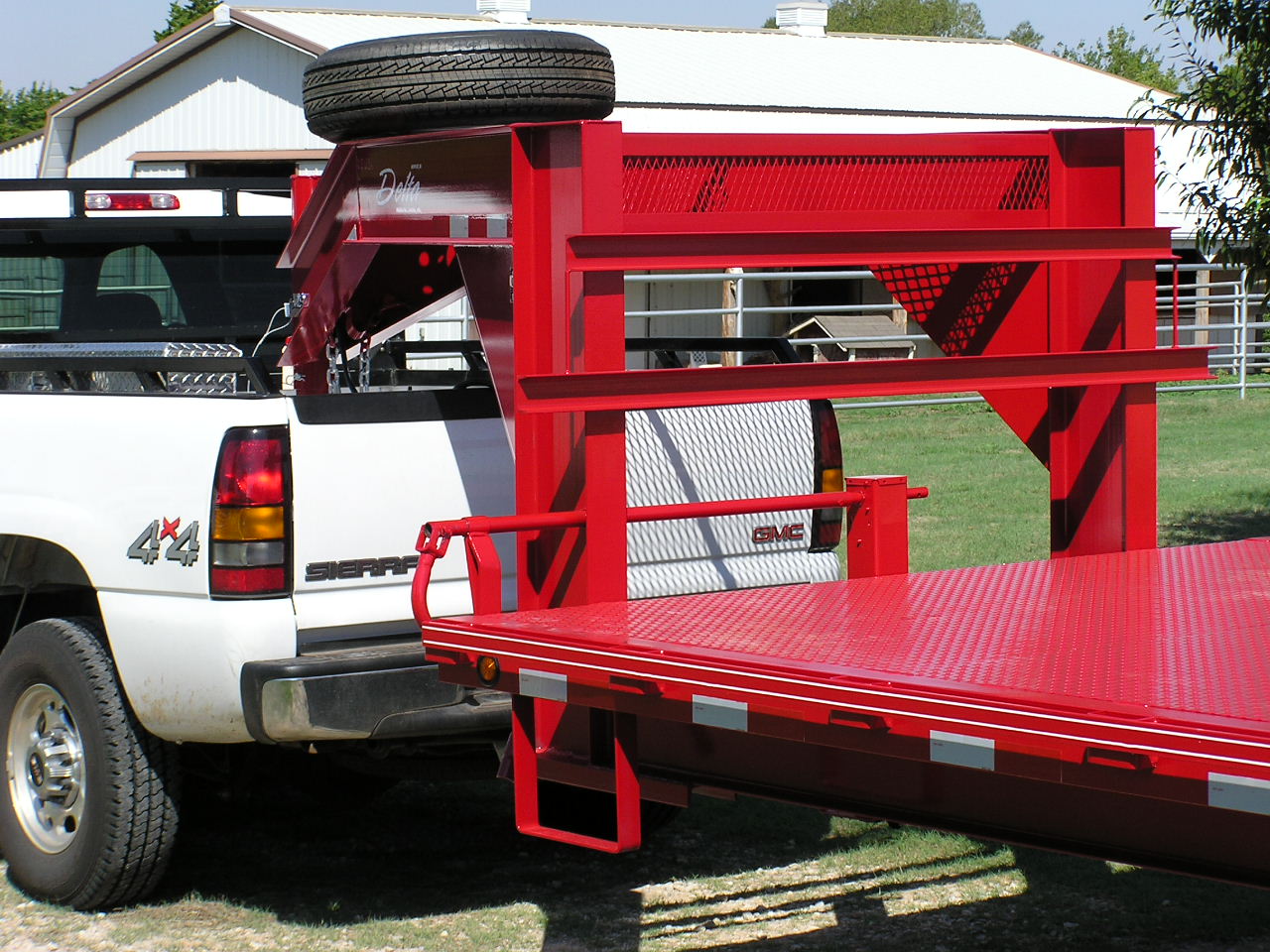

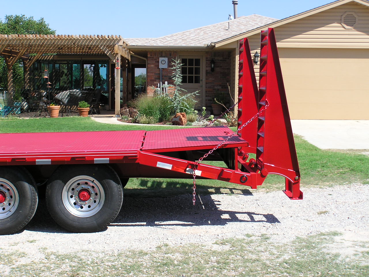

It is a Delta: Equipment trailers from Delta Single Wheel Flatbeds
It is the perfect trailer for me, a gooseneck with a 18' deck and a 4' pop-up dove tail.

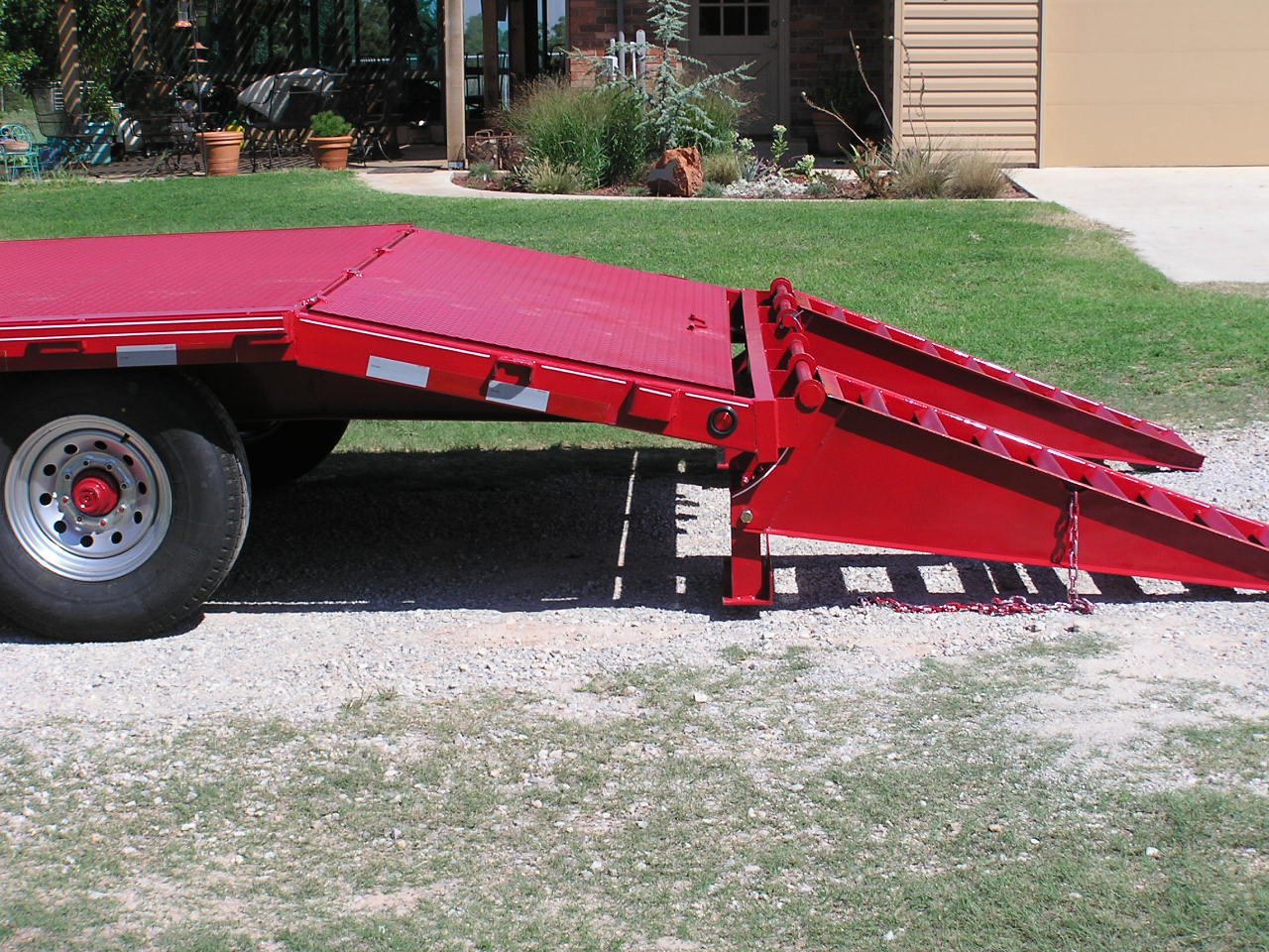

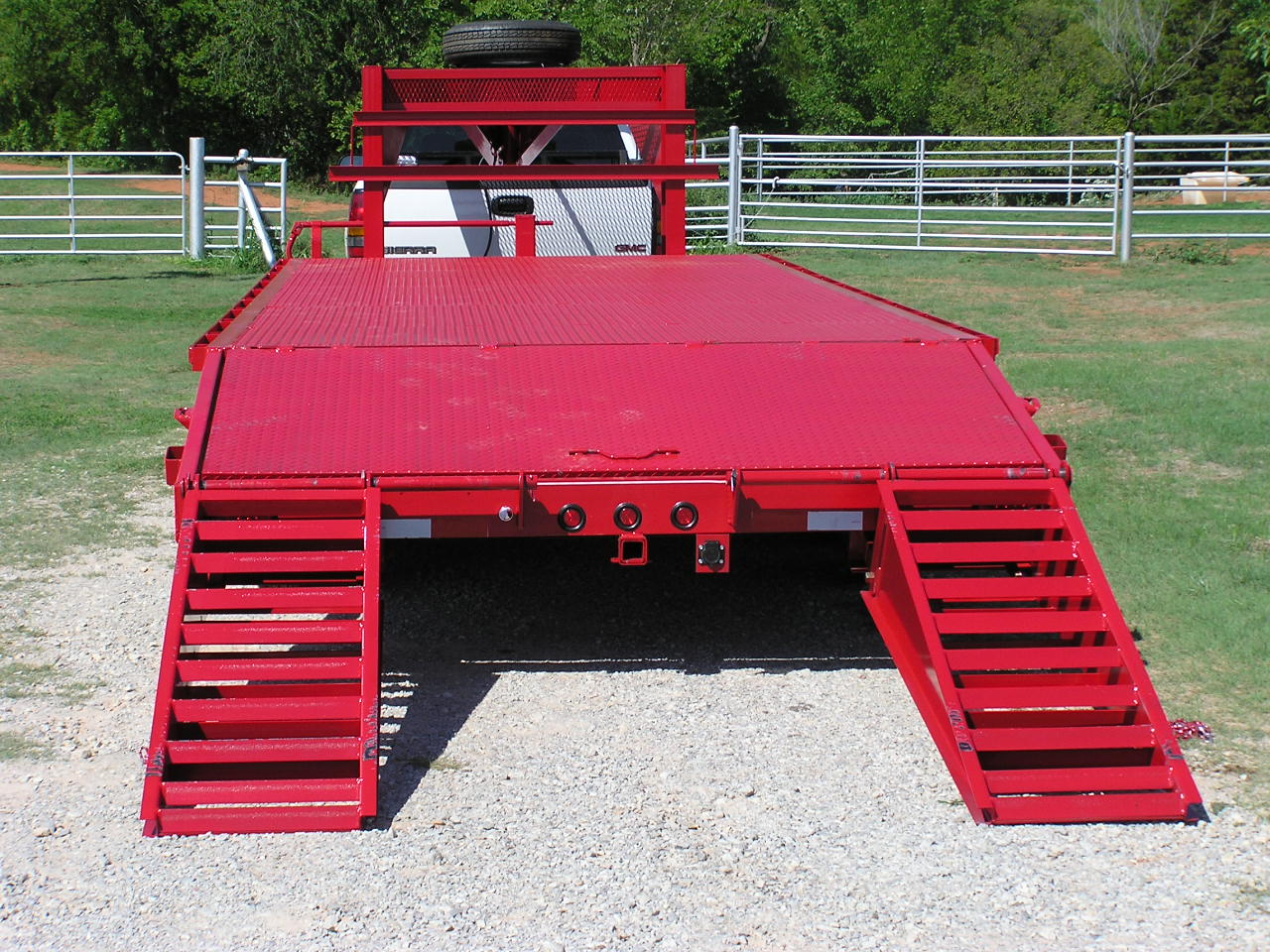

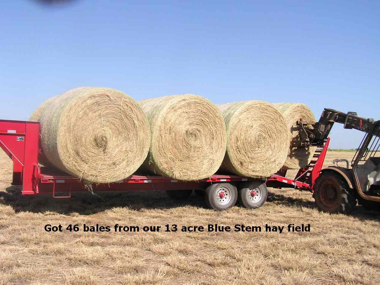

For hauling square hay bales, ramps make a back stop.
For round bales, leave the deck down and the ramps hold the last one or two in place.
I hauled 8 5x6 bales on this and 6 more on a 16' deckover hooked to the receiver hitch.

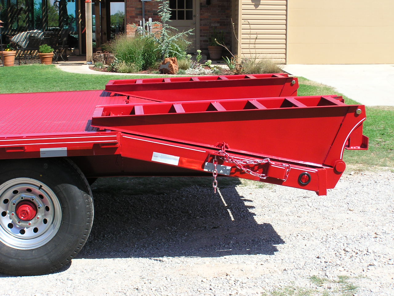

For equipment, ramps slide in to match tread width, and support the rear when driving the tractors up on the deck.

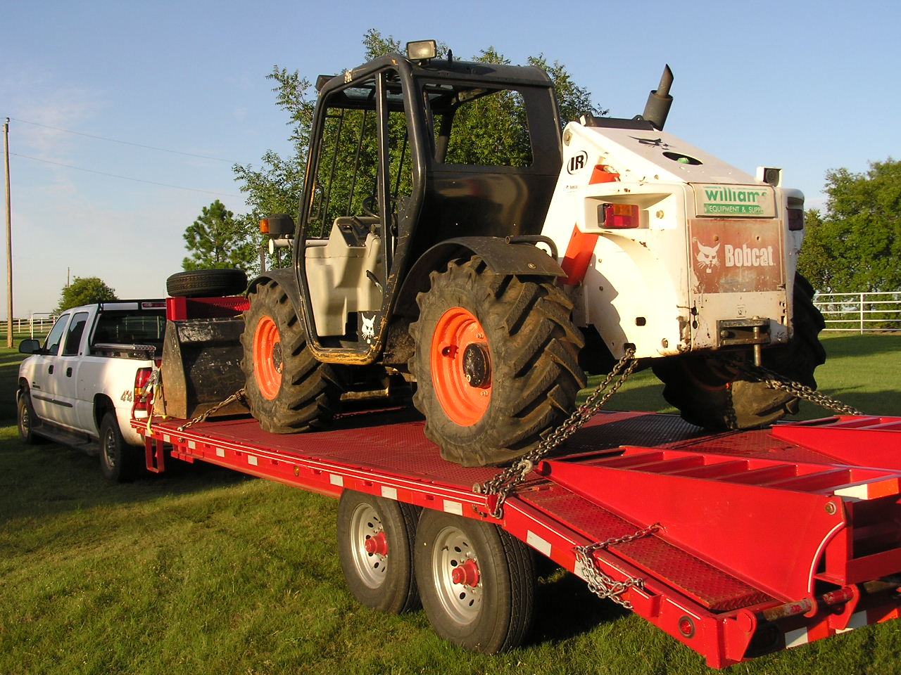

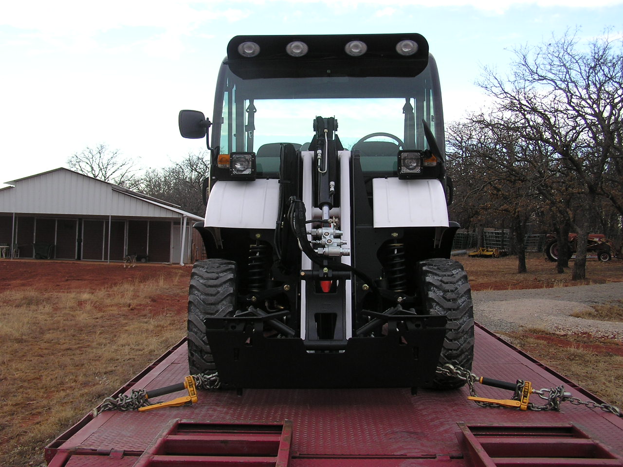

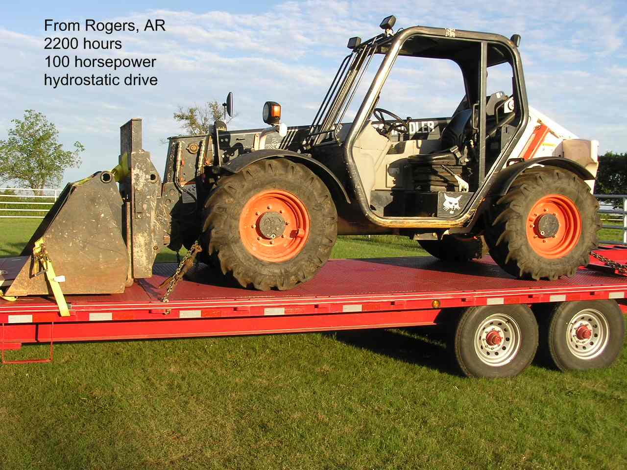

I ordered it with the receiver hitch from a local dealer in 2006. The delivery fee was $500, so I drove to the factory in Arkansas and picked it up.
Got a red one because when looking at the local dealers, on a sunny day black was too hot to touch for long, but red just felt warm. 5' Dovetails where too low at the back for my terraced hay field. It is 22' long with the 4' Dovetail. Empty weight is 5,000 pounds, 4,000 on the axles. Should have ordered the 8K axles because of the weight of the metal deck.
I hauled the Bobcat V518 across the scales with 12,640 on the deck, 14,200 on the axles, 3,440 on the ball, Just 3,640 over the 14K GVWR.
