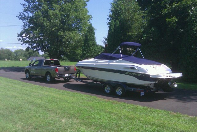

I'd say give or take on the % Chris is right. The motor (usually a small block or big block) the outdrive, pumps and most of the mechanicals are in the rear of the boat. From the boat trailers that are in my family, (I'm just a casual observer) the wheels are close to 3/4 of the way to the rear....That would preclude much tongue weight from the boat. I'm certainly no expert on the subject though.
On the boat pictured there is easily over 25% of the length of boat behind the center of the tandems which with the weight distribution mentioned would make a negative tongue weight.
   / Trailer for both boat and tractor? #16
I just went out to the barn and measured it. From the tip of the motor in the trimmed up position to the ball coupler on the trailer its 31' in length.
From the back of the boat to the center of the axles is 6' and form the tip of the motor trimmed up to the center of the axles is just a little shy of 9'. I think it looks a little different in this pic because its at a angle.
Again, this boat is right at 7,000#. The outdrive weighs 148#. Not sure of the weight of the extended swim platform but I would guess its in the 200# range. The boat was weighed by me twice in the last 2 years.
Chris
Chris
How long is the boat?
Either way, your numbers pretty much prove my point.
   / Trailer for both boat and tractor? #18
Boat is a 25' boat with a 3' extend swim platform for about 28' overall length. On the trailer its 31' from the tongue to the back edge of the swim platform.
As for the weight, there are 3 group 27 batteries, a 75 gallon fuel tank, 383 stroker plus outdrive, 25 gallon water tank, 10 gallon holding tank, plus all the mechanical systems in the back 4-5 feet of the boat. I have seen it slung lifted and the CG point is roughly over the axles.
Its bigger than it looks in the pic. The truck pulling it is a 2008 Nissan Titan that is 20' long. Its sitting on 33" tires to give you a idea.
Here is another pic to give you a idea of the length.
Chris
